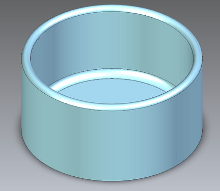

In the STEP file below, the geometry consists of clean edges, and the fillets on the top edge and the inside bottom of the cup are explicitly defined.

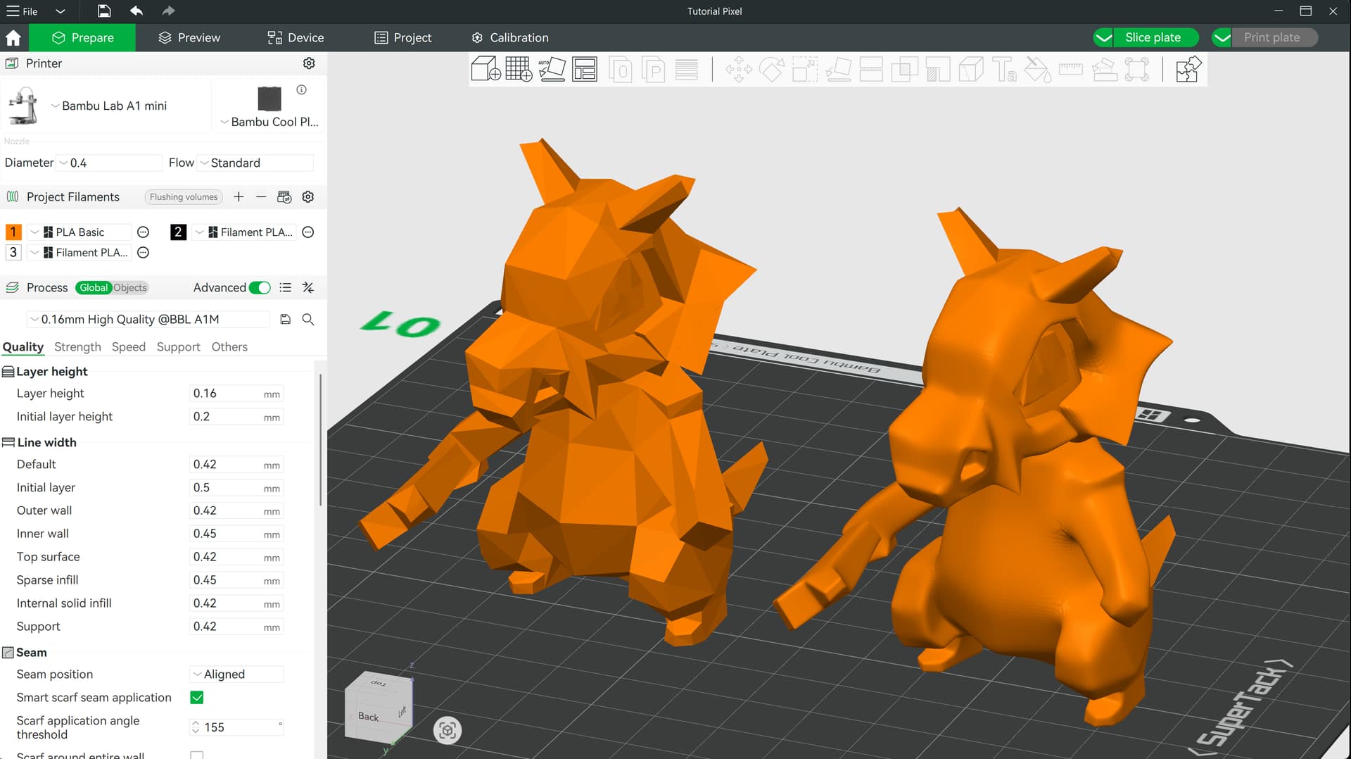

On the left is the original, on the right is the rounded version.
It’s best to get this plugin, which can also check your model for errors and has some useful functions for 3D printing. It saves you a lot of work.
