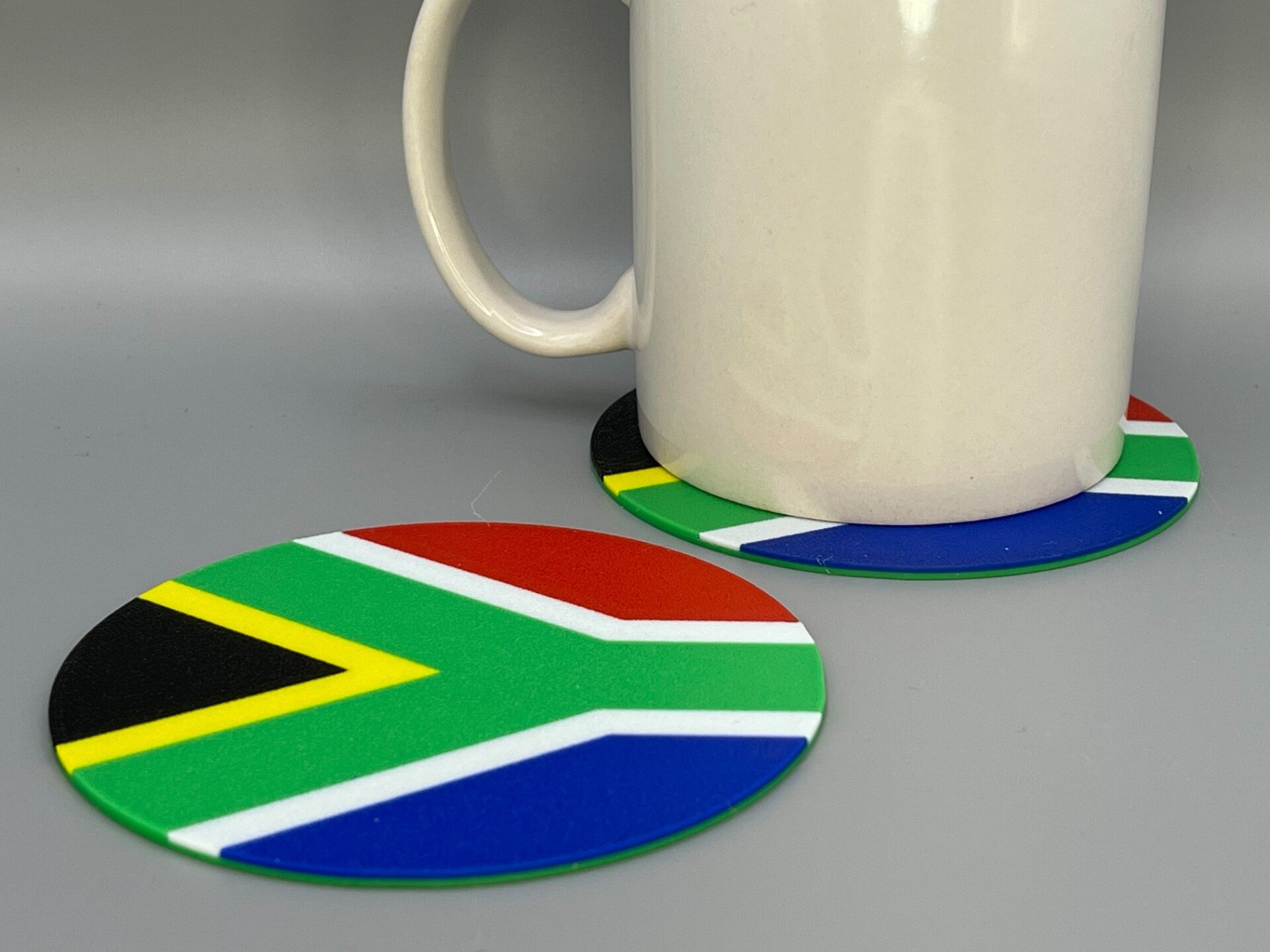

I assume your design is essentially the same way a coaster is created.
  • You have a base part
  • One or more areas that should be different colours that are on the topmost surface.
Do you have any of this designed?
Painting is not the route to go.
If you look at my design here.
The colours are different parts, when they are combined into a merged model and the different colours matched to filaments available, it becomes the model.
The green is one part, the red another and so on.
If you wish to share the model using DM method, I will take a look. I will not be doing it for you, but I am happy to point you in the right direction.

Hi yes this is the method I wish to learn, does it really consist of breaking it down to seperate models for each colour? ill send you what I have, thanks for reply.
Unfortunately, despite being told otherwise, the problem with uploading 3MF also affected DMs.
Can you share it again using a DM using a third-party service like WeTransfer, and then paste the URL?
That service and others allow sharing via email or link. Select the link.
Whichever you choose, make sure it is free for both you and me.
Yes, this is the best variante. I am also doing this a lot.
It’s also easy for all users to select the colors they like, which is quite harder to realize with the painting tool. But don’t forget to merge the parts together and to check the slice.
