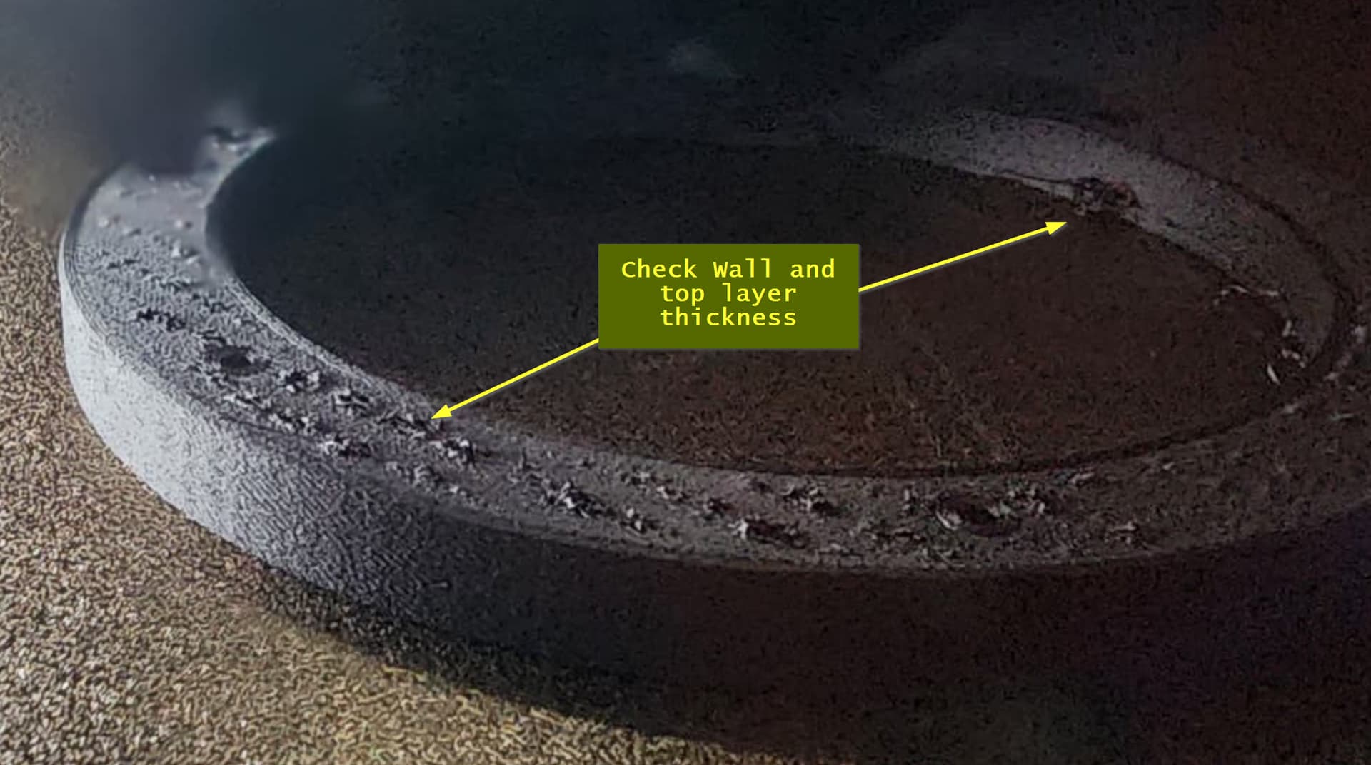

X1C, 4mm nozzle, 3 loops, random and painted seams. PPA-CF has been dried a few times in Sunlu E2 at 110C. Stored in the E2 with plenty of dessicant and I’m printing right out of the E2. Manual calibrations done.

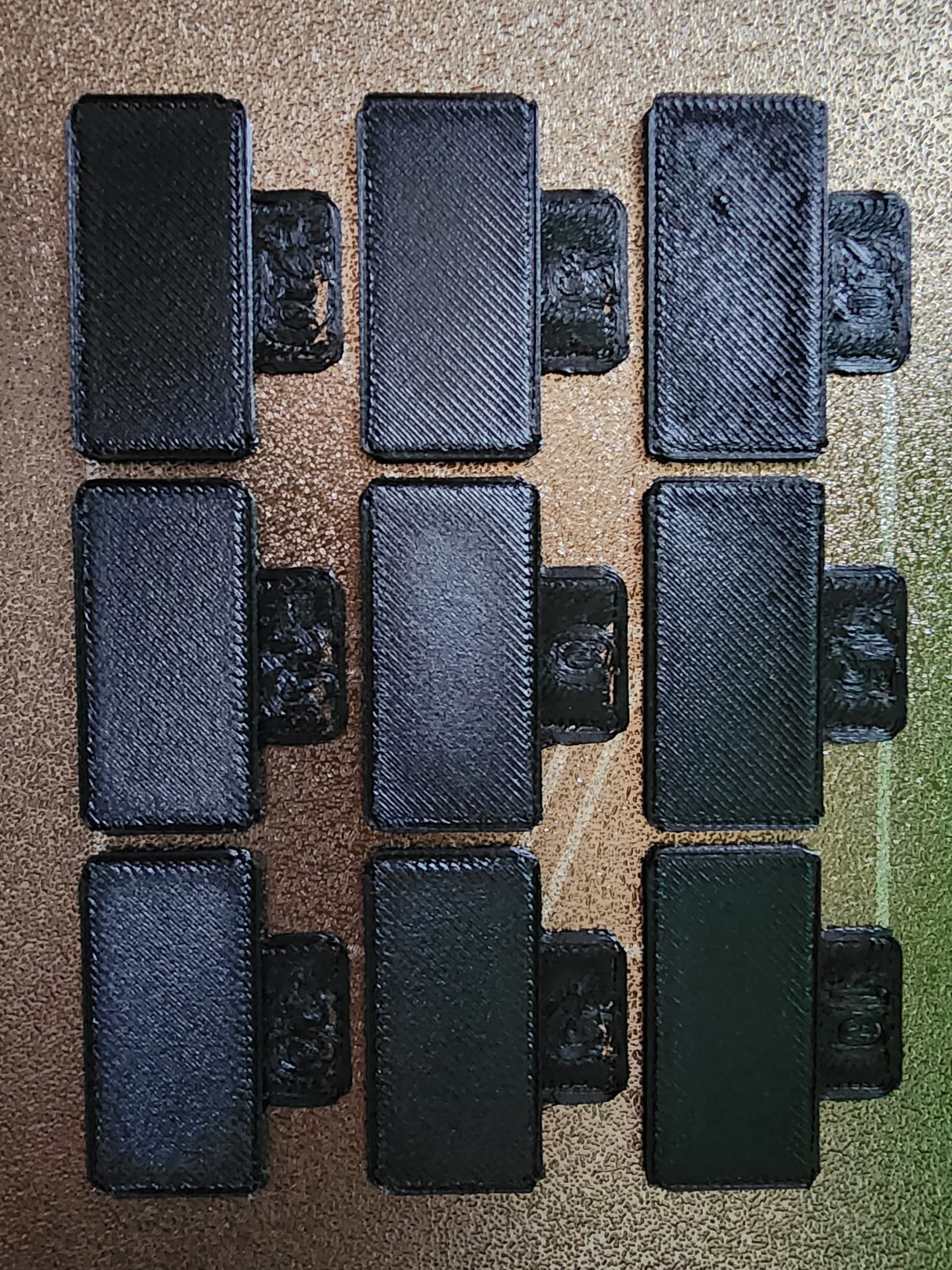

I’m trying to dial in my PPA-CF printing. On the flow calibration test, the part with the numbers came out fairly poorly at any flow rate. As you can see in the picture, when I print objects, there are often strings hanging out of the bottom of the print (see the inside diameter on the right, its a little dark.) The lumpiness on the top in the picture isn’t present after the final layer is printed, but it doesn’t seem good.

Although I have not printed PPA-CF, I have had quite good success with enabling “wipe on retract” for most filaments. That can help a lot with oozing & stringing. Z-hop unfortunately did not help me nearly as much.
Regarding the lumbs, there may a number of root causes such nozzle temp too low, too much cooling, too fast, too low an infill,…
Personally, when running into issues, I first rule out filament moisture (which you have done) and slow down the print. The latter also helps to better observe the failures as they are occuring.

I’m leaning towards flow issues possible caused by temperature (most likely) or speed (less likely).
Their are three things you hadn’t mentioned so just in case you haven’t tried this rout here goes:
  1. Print a true temp tower, by that I mean it must either be one generated by the slicer - I don’t know if Bambu Lab ever stole that from the calibration menu from Orca since I’ve not used Bambu Studio since 1.6 and have been on Orca ever since. Once you slice the tower, go to temp on the menu and make sure it shows different temps on display at each layer. If it’s one color then all though is a static model with no color variation. Here is what that menu looks like in Orca, you would have to select customer and then enter the range for PPA-CF.

  2. Check the top and side walls. Try increasing both, 3 may not be enough, you may have to increase to 4-6 and also, remember to change the default wall order to outer inner.

I was interested in some of the calibration tests Orca offered so (with great difficulty) I got it running. I went down the menu running tests through the retraction test and stopped after that. The results either pointed to the default value from Bambu being the right choice, or the results didn’t really give me any actionable information. I was enthusiastic about the temperature tower, but it didn’t ultimately give me any data. There was some of the stringing I saw on my actual prints at 285C, but the actual parts were all printed at 300C where there was no stringing on the temperature tower.
