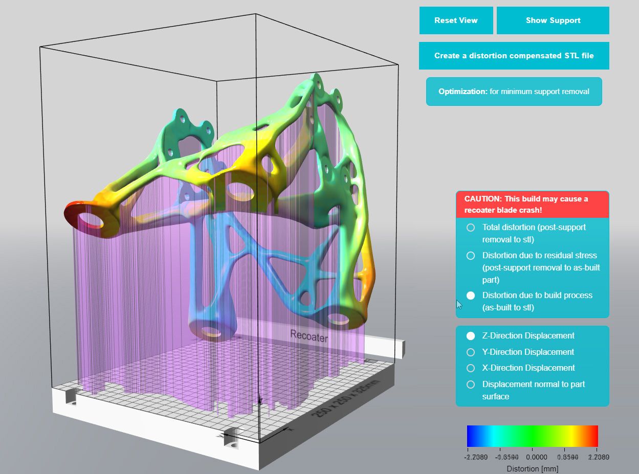

Lets say you live in the perfect world and you are able to compensate all the positional deviations that occur in a heated 3D printer, then there is one more factor to take into account and that is the shrinkage of the part.
And that is not a linear shrinkage, that you can adjust with a single number, but is heavily depending on the geometry of the part and the direction in which it is printed.
The shrinkage of the layer that lays on top of layers that have already been partially cooled will generate stress in the part and causes a non-uniform shrinkage.
Though this simulation (image below) is done for a powder bed 3D printer for metals with higher melting temperatures than our FDM process, it clearly shows the te non-uniform shrinkage of parts.
And here the question again is, do we need that amount of accuracy for our parts?

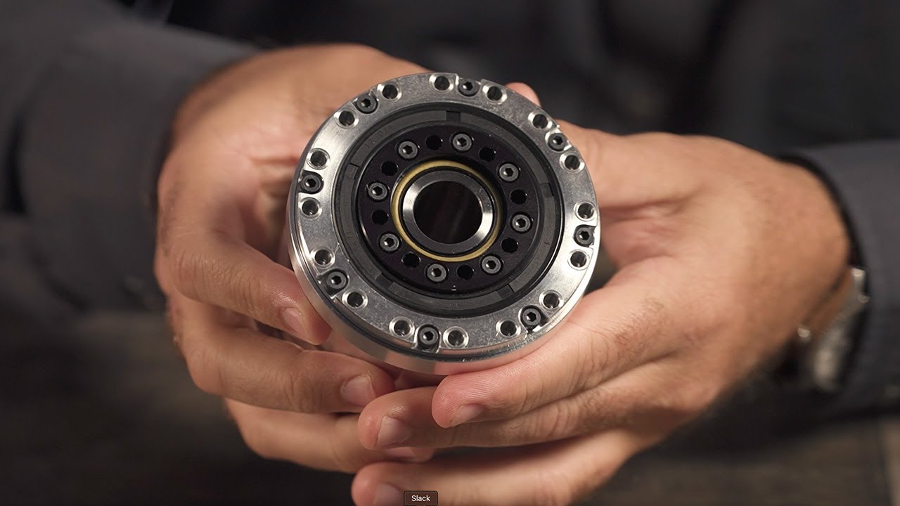

I can think of a number of things where the more accuracy, the better. One would be large gears that you want to mesh together extremely well. Maybe you want to print the gears directly, or maybe you want to print a model that can be used for casting such a gear.
I think the more accuracy you have, the more clever people will come up with ways to put it to use. If you wanted to 3d print a zero backlash gearbox, I’m pretty sure it’s going to take above average accuracy:

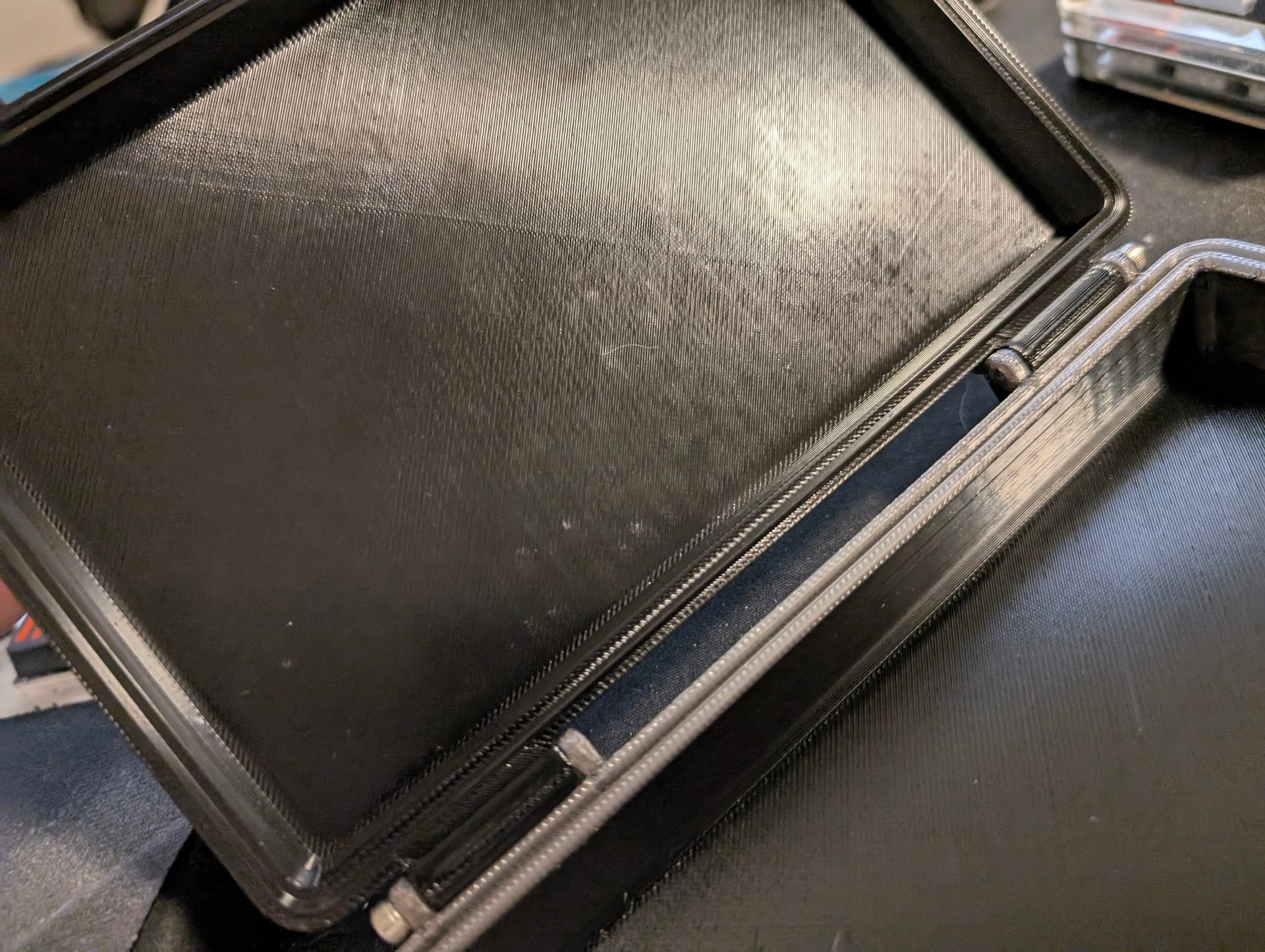

For me, it made an incredible difference.
I was getting acceptable, but not great, finishes on many of my prints, and spent about 30 hours trying to get a decent ironing profile sorted out. Never could succeed with any ironing settings that worked with HF nozzles, only standard (thread on Ironing reached the consensus that cooling was overpowerful and ruining the ironing lines), so I gave up.
Few days later, got my vision plate, ran the calibration test, and printed a box for a geocache. The surface finish of the inside feels like its ironed:
Its not the 100% glossy perfect my tuned X1C could get, but it’s consistent. The X1C would give you beautiful ironing, or it would choose to just spit out garbage, and there was no way to tell ahead of time.
