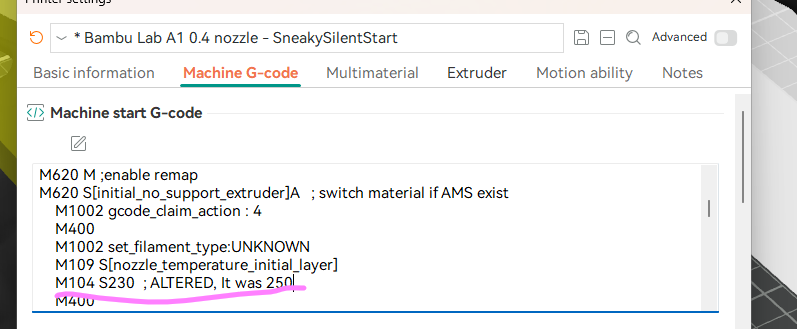

Material changes between high temps and low temps are ripe for clogs, so this is gonna be more of a process change for you vs a vendor change, IMO.
Edit: If you’re in control of the slicer (and the start gcode) you can do some things to add some resiliency, like change the max suggested temps of your PLA to be a temp that melts ABS too (this value is used during AMS based material changes)
and change the generic gcode start heat. For the A1 at least, it is hardcoded to 250.
