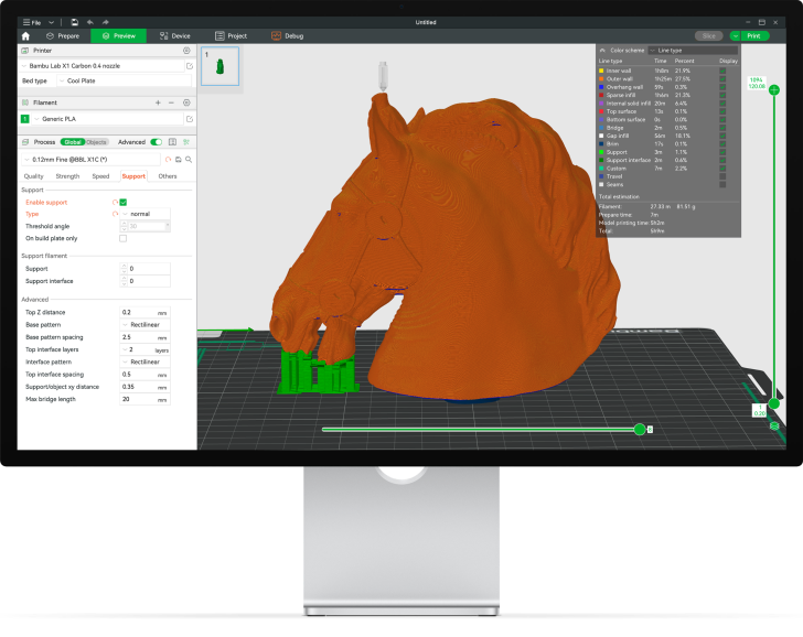

Sorry for this neophyte question but what do you mean when asking for a slice preview? A screenshot after the slice?

The slicer preview is an insanely capable tool, it is simulating exactly the movements, make sure to use the bottom and right sliders to inspect what your printer will be doing at any given moment
Never apologise for asking a question, especially not a useful one.
This is what was meant (I believe).
The idea is to share what it looks like post-slicing that you see so we can.
Chances are, we would have spotted it straight away.
That is the preview tab after the slicing had finished and showing the helpful, line type view.
