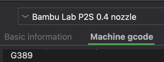

With my A1 and P1 I had custum profile set up so the AMS doesn’t retract the filament when at the end of the print. This is very useful if I know I’m doing multiple prints with the same filament in a row.
But with P2S I’ve been unsuccessful so far as the code seems different. And after extensive searching I haven’t found anyone talk about this yet.
Like with A1 & P1 I thought I could just comment out the pull-back code like this:
And this works, but only kinda. It doesn’t pull back the filament, but it also doesn’t move the printhead back to the starting position and doesn’t clean the nozzle at the end of the print. It just lifts up the z axis 10cm and just stays there, oozing filament from the previous heat…
Since P2S is such a new printer, Bambu hasn’t updated their wiki either on this subject (Disable unloading and flushing to save filaments when printing the same material | Bambu Lab Wiki), so I was hoping there is someone who also has already dealt with it and solved it.
Hi, it seems like the issue is that you also put “;” in front of G150.3, which tells the printer that the AMS finished whatever it was doing and the G-code can continue. Try commenting just the five lines above and not the G150.3 line.

Prior instructions were off to say the least. I deleted the original post as I was unable to edit due to age of post. These updated with images work for me. Use at your own risk.
These instructions are for a P2S with Bambu Studio on MacOS. It may/may not work with Bambu Studio on Windows or other printer models.
– Disable AMS pullback at end of print –-
In Bambu Studio
Open Printer Settings.
Open Machine G-code
Find Machine end G-code, scroll down until you find the the “; pull back filament to AMS” block that unloads filament:
— My example block —
M620 S65535
T65535
G150.2
M621 S65535
Comment out ( ; ) or delete these commands and save the preset.
; M620 S65535
; T65535
; G150.2
; M621 S65535
Save the printer profile.
The printer stops unloading filament to the AMS at the end of the print.
CAUTION: if the filament isn’t unloaded and the hot end cools, you may need to do a cold pull.
— Full screen shot —
Good catch, mixing different slicer instructions doesn’t work. I added updated instructions (with screen shots) that work for me in this thread.
Easiest way I found was to comment/remark out the the commands under the “Machine end G-code” > “; pull back filament to AMS” so it doesn’t trigger the filament unload action. I’d caution you, if the filiment isn’t unloaded and the hot end cools, you may need to do a cold pull.
