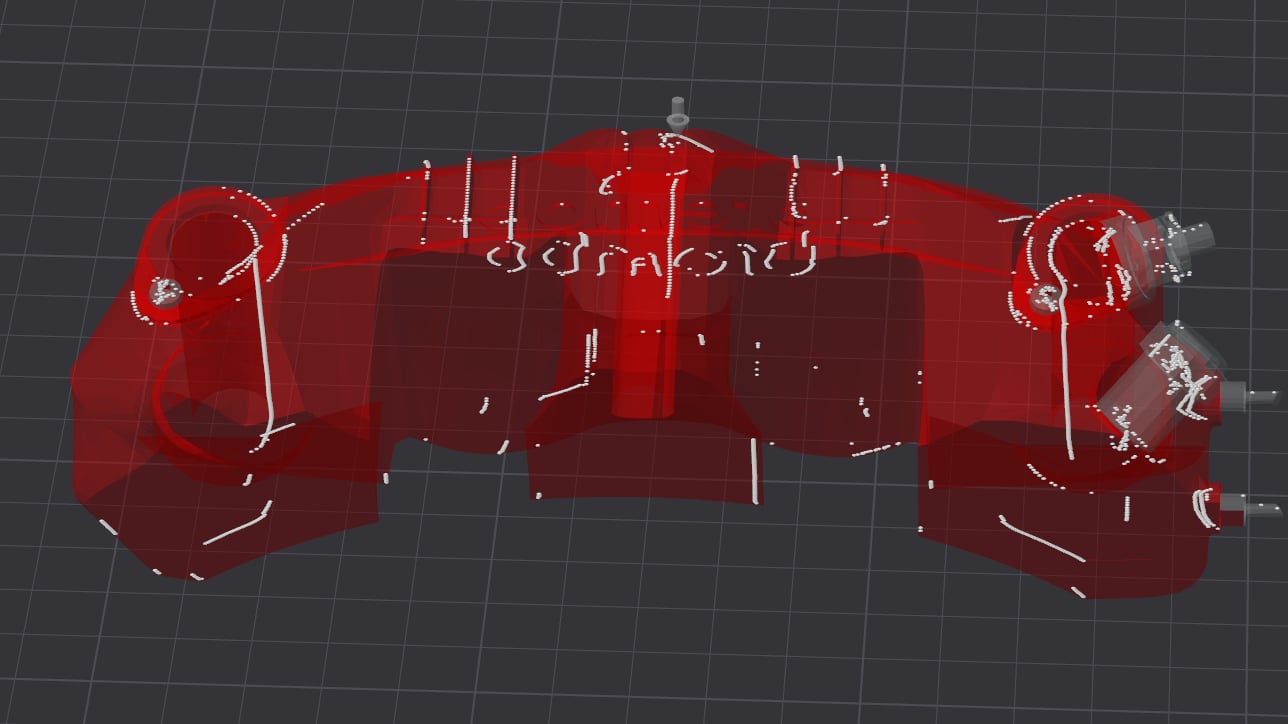

@Donoval regarding the photo of the red part you showed, those look like part of Random Z-seam. Regarding the rest of it, it seems to be pretty well known that Bambu Basic PETG is pretty bad which is why they replaced it with PETG HF. You can read more here and maybe you will have luck with Generic PETG settings as did the others here: Bambu Lab PETG Basic - #11 by Malte
I I don’t understand , often I change a thing here and there but you are suggesting that the basis of the preset is wrong. What is Bambu doing if they suggest wrong things. Doesn’t really add up
Random z seem with different colour? That’s a first. Also no seams there
Also I never had issues in over 50 spools of petg basic, not to mention that I get the same with other types of filaments too, petg hf included
