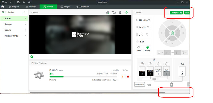

This bug was introduced in 2.4.0.70. (Computer runs Windows 11)
It ‘stretches’ the display horizontally in Device screen when printing. Go back to the Preview screen and it is fine.
I have had this behaviour off and on since I think the first release of bambu studio so I don’t think it was introduced recently. I’ve never found what triggers it although it seems to appear when computer comes back from sleep but not always but it is a small inconvenience.
I don’t think Studio is ‘stretching’ the Device display, but the various parts of the window either do not resize at all (Control panel) or have minimum horizontal and/or vertical sizes . If the window isn’t big enough to hold it all, you’ll have to deal with the scroll bars. A window of 1450 x 700 pixels seems to be the minimum to avoid scroll bars completely. Studio 2.0.1.50 and 2.2.1.57 required the same window size.
The Prepare and Preview tabs are more flexible because there are fewer elements of fixed size, but there is still a limit on how small of a window can be used.
