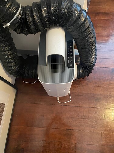

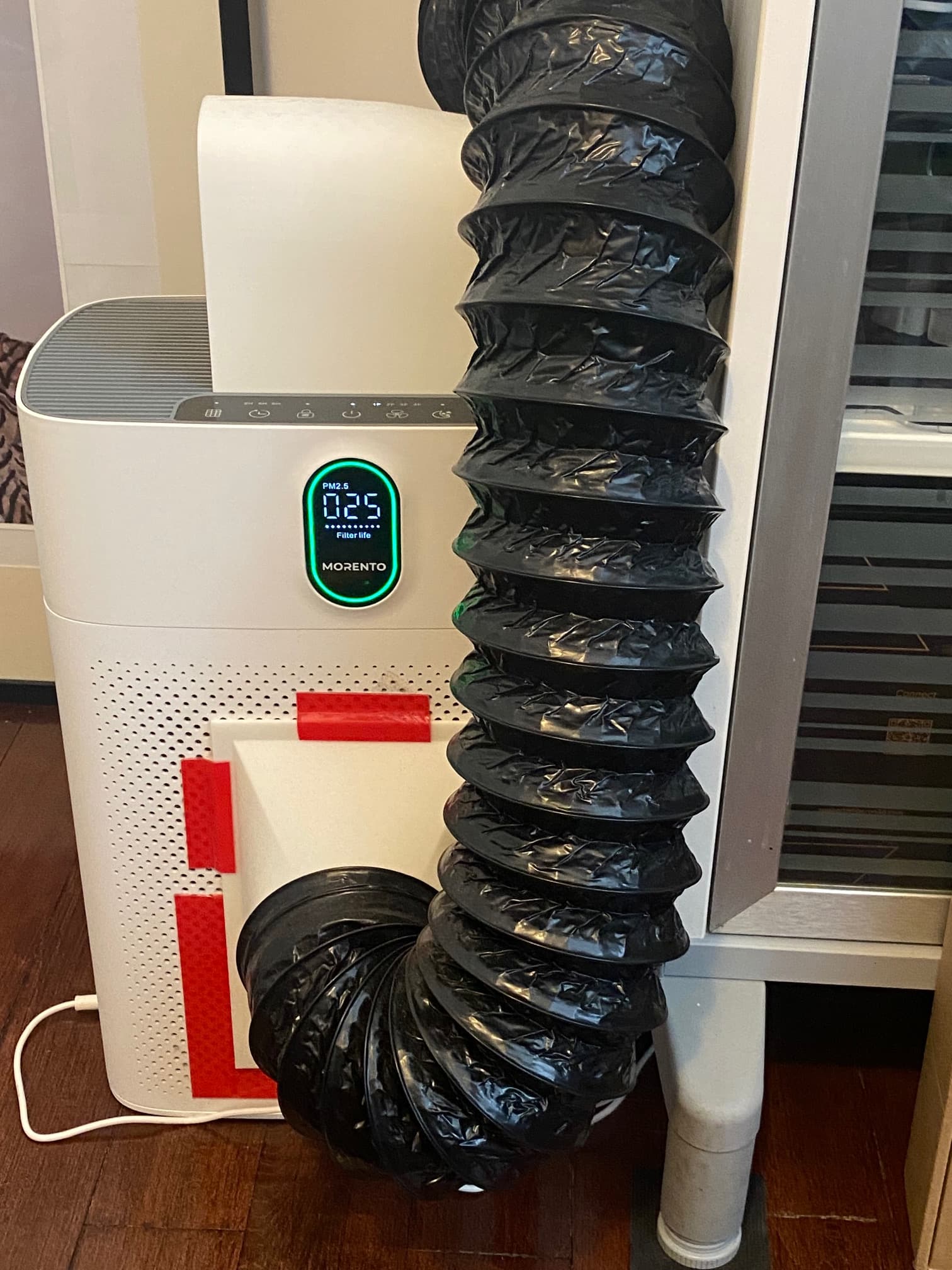

This is my setup, air purifier has carbon filter on both sides and I print occasional ABS in fairly small room.

so you dont have a fan in the flex air ducts, you rely on the air purifier fan to withdraw air from the printer, right?
my question is still the same
will this still affect the air movement or will it lower temperature inside the printer as you are sucking more air than the printer itself?
specially if printing ASA or ABS
thanks
You don’t need to pull a hard vacuum inside the chamber. All you need to accomplish is to create a slightly lower pressure inside the chamber so fume doesn’t leak out through the various joints in the chamber case into your living space. Instead you either direct it outside or through some type of filter media that scrubs out VOC’s.
