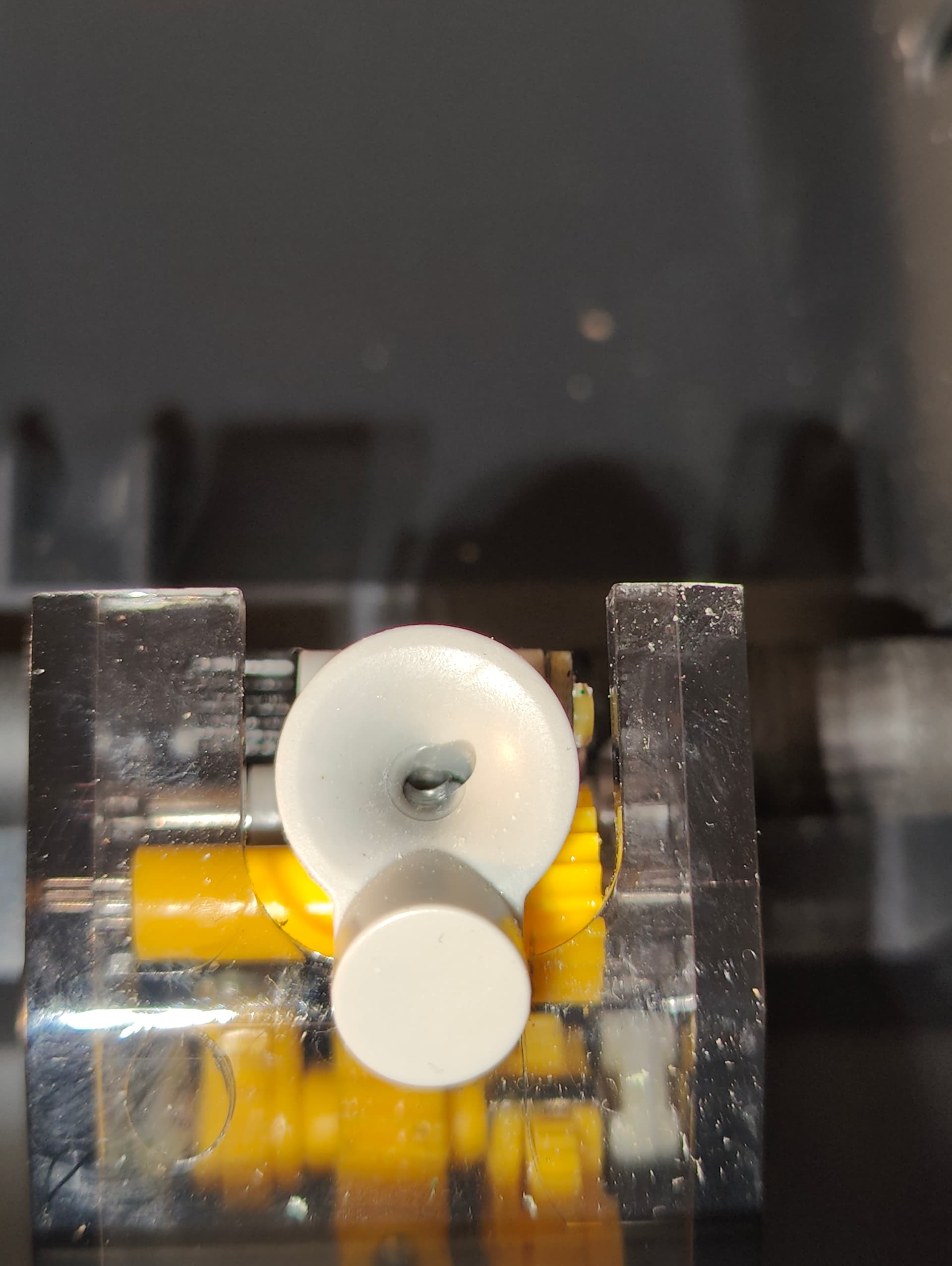

Slot 1 on my AMS unit suddenly stopped feeding filament. I recently replaced the inner tubing and it printed fine last night. Now, when I insert the filament in slot one, I hear whining like a motor going but does not draw in the filament. Slot #2 works fine and I’m currently printing from that slot. My questions are:

If it’s happening on one slot there are some things you can do to narrow down the issue. One is that it’s not the hub because it’s happening only on one slot. The hub has only one motor and if it works for the other slots, it’s working for that one.
You can move the rollers from a known working to number one. If that fixes the problem then there you go. $5 (plus shipping) fix.
You can remove one feeder from a known working slot, move it to number 1 and see what happens. If you still have a problem then it’s most likely the feeder.

I tore it down, looked at the motor, internal PTFE, even replaced the feeder tube. All of this eventually led to doing a refurb on the unit. In the end, and no idea how I missed it, the feed roller was horribly worn. My head was up my butt when tearing down I guess. Replaced that and haven’t had issue yet.
Have fun, just pay attention to the yellow gears inside the clear part of the feeder assembly. Looking at it from the funnel end. The right side gear needs to be forward horizontally. There’s a tab on the clear cover that will make sense when you see it. The left needs to be vertical. If you get those the first time you’re golden. Took me 2 tries.
UPDATE: The AMS feeding mechanism for slot 1 is broken (see picture).
When I replace the feeder funnel unit, I will see what exactly broke in the mechanism. I truly hope this will not become a regular occurrence for my AMS.
If the gear is broken the funnel kit will not fix it. The only way to get that part is through the full feeder unit.
