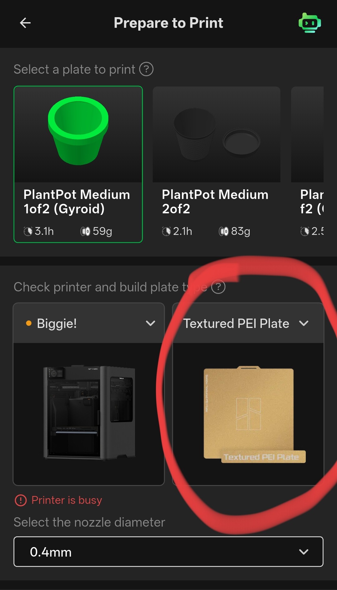

Where in the Handy app does one change the build plate?

The type of build plate is equally not fixed in the profile.
