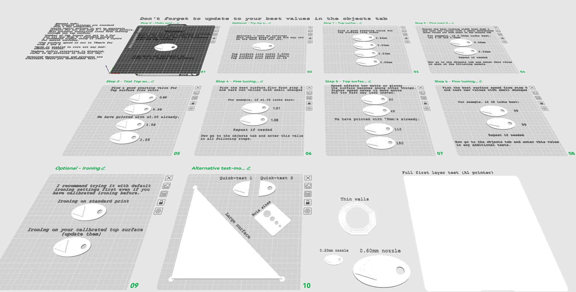

I noticed a strange effect when printing an object while testing new top surface settings for better surface (using Advanced top surface guide - understand & improve - Free 3D Print Model - MakerWorld ). Accidently I have set the same settings for an individual object as for Global, but then the print came out really weird, with a very rough feeling surface and “waves” on the surface. I was under the impression that Object-Settings do overwrite global settings, but now I am thinking if they ADD to one another? If I reset the object settings (which are the same as global), the print comes out fine!

I’m sorry, what I meant was “based on this makerworld-project”, but in another one. I just took some settings and changed them like described in the first mentioned project.
