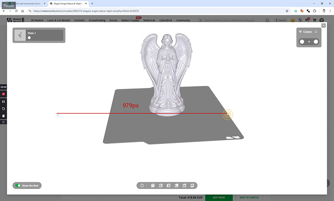

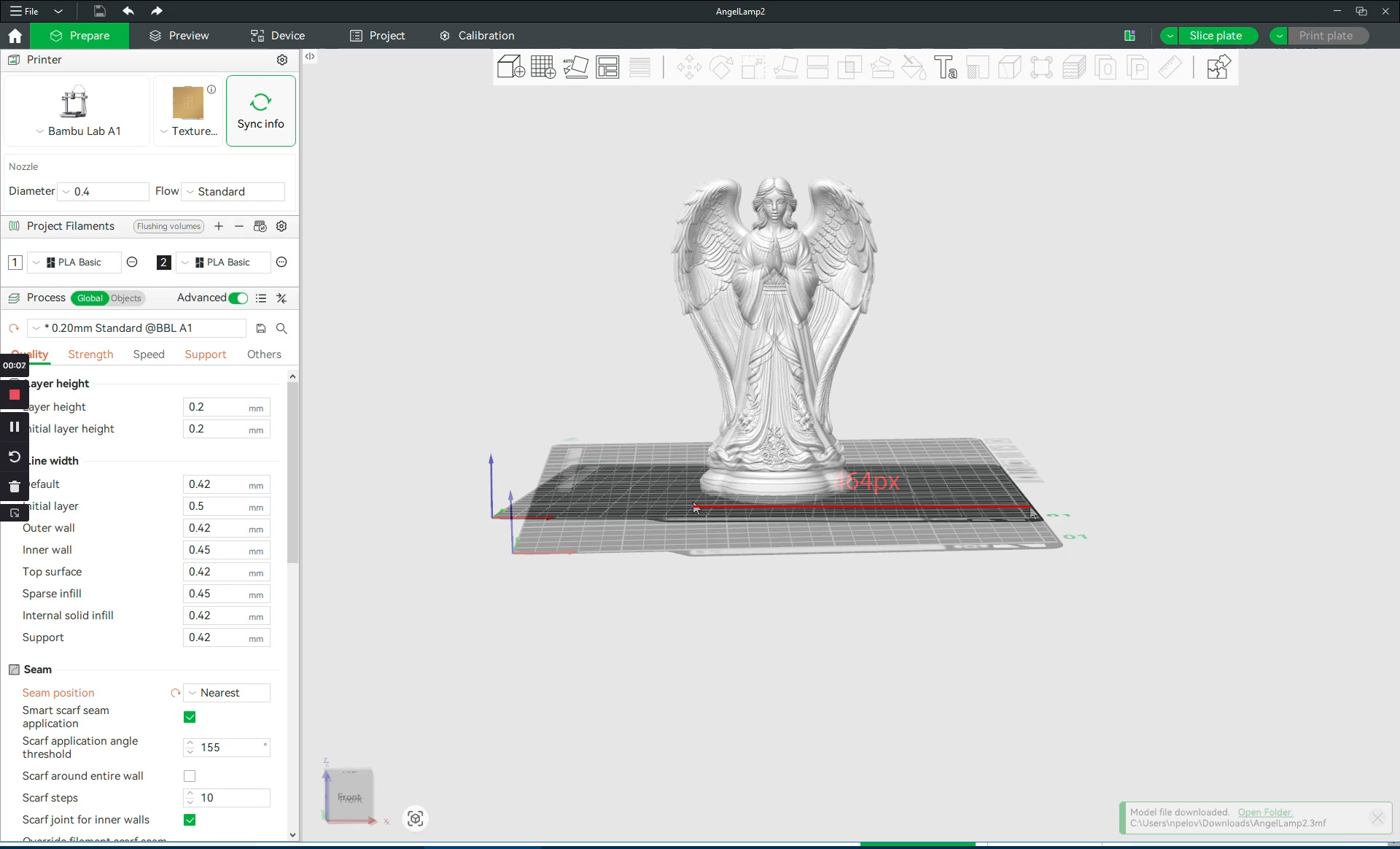

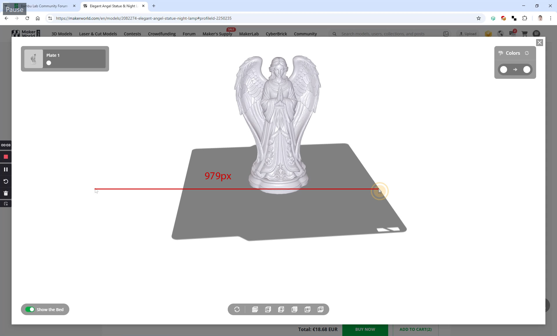

Here is how much you need to move the mouse for one rotation:
in bambu studio:
in makerworld.com:
In bambu studio same distance rotates twice. I’ve set the speed to 0.5 in orca slicer and feels like makerworld and printables.com - reasonable orbit speed.
screen recording of both:
