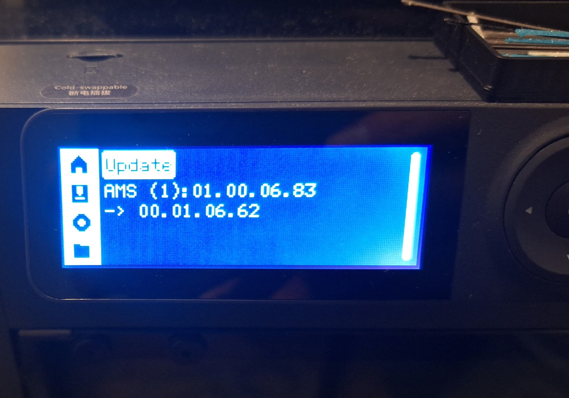

I updated my AMS(1) to 01.00.06.83 for A1 support. But if I connet it to a P1S it wants to downgrade to “latest” 00.01.06.62
Is the AMS firmware not compatible with all printer models?

00.01. was just a typo, just trust the 06.xx for versionning
My guess is there are at least 3 different firmware trees for X1, P1 and A1, don’t know about H2.
Latest versions for AMS(1):
X1: 00.00.06.75
P1: 00.01.06.62
A1: 01.00.06.83
H2: ??
What version of firmware is your P1S at?
The latest version 01.09.00.00
