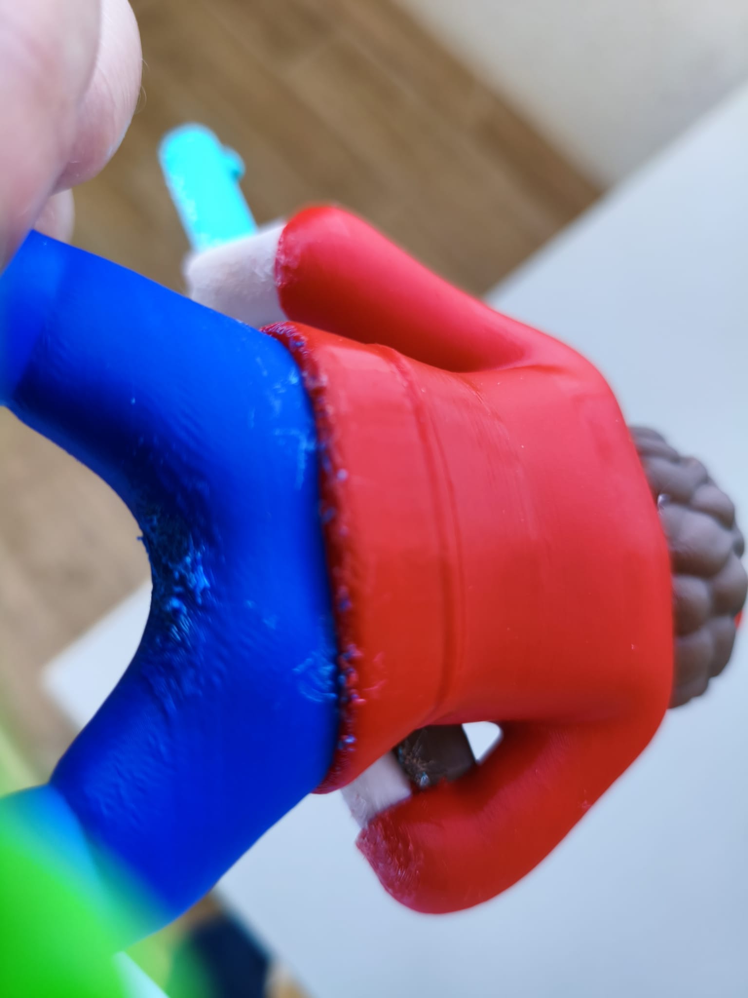

Does anyone have a way of giving multicolor PLA prints a good surface finish?
I usually print multicolor prints, and usually use maximal layer height, for reduced print time & filament usage.
But the downside of that, is that the finished result often comes out coarse. Often things printed at an angle don’t look smooth, or removing the supports leaves a coarse surface.
I’ve seen people recommend varnish or nail polish. However, I tried transparent varnish, but didn’t see any discernable results. Only white residue when I use too much.
I also tried different sanding papers, and a small dremel with fine sanding bits - but in all instances, the sanding produced good results to the touch, but not visually. Visually there are always scratch marks, that affect the appearance of the model.
Does anyone have a way of making the surface of PLA prints look smoother, without affecting the colors?

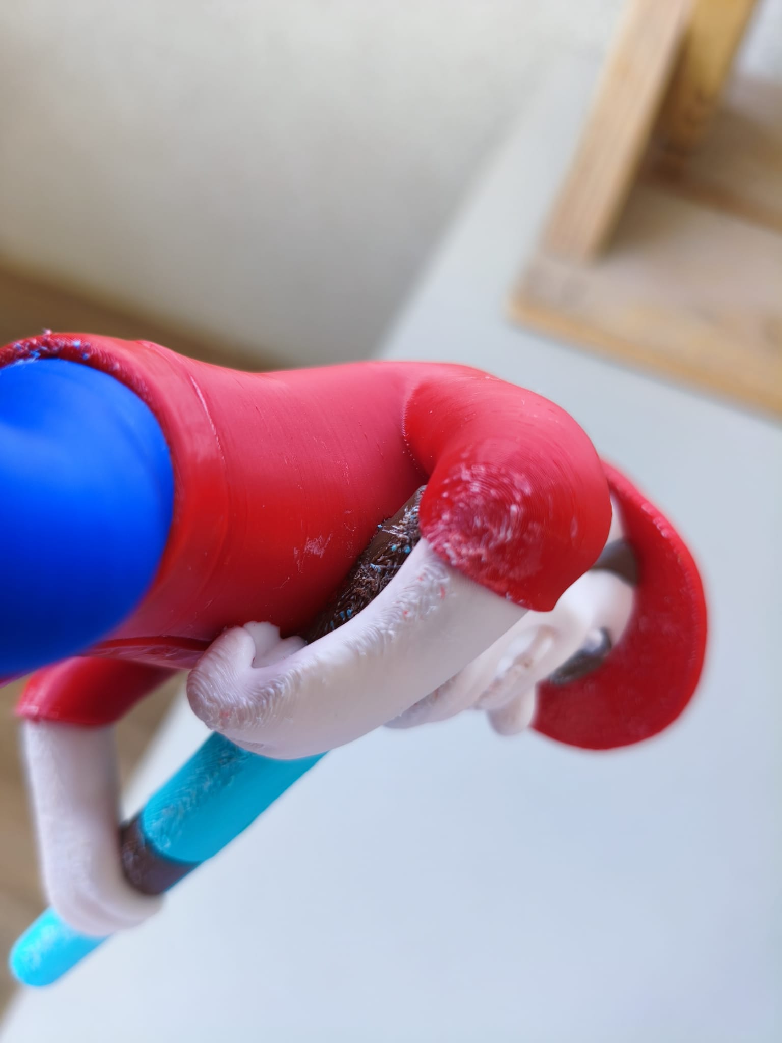

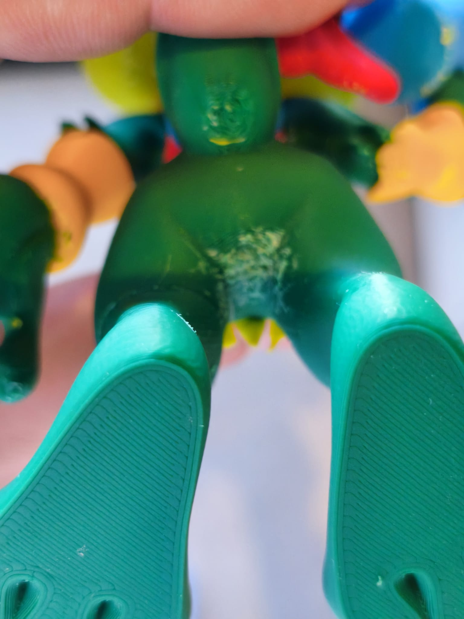

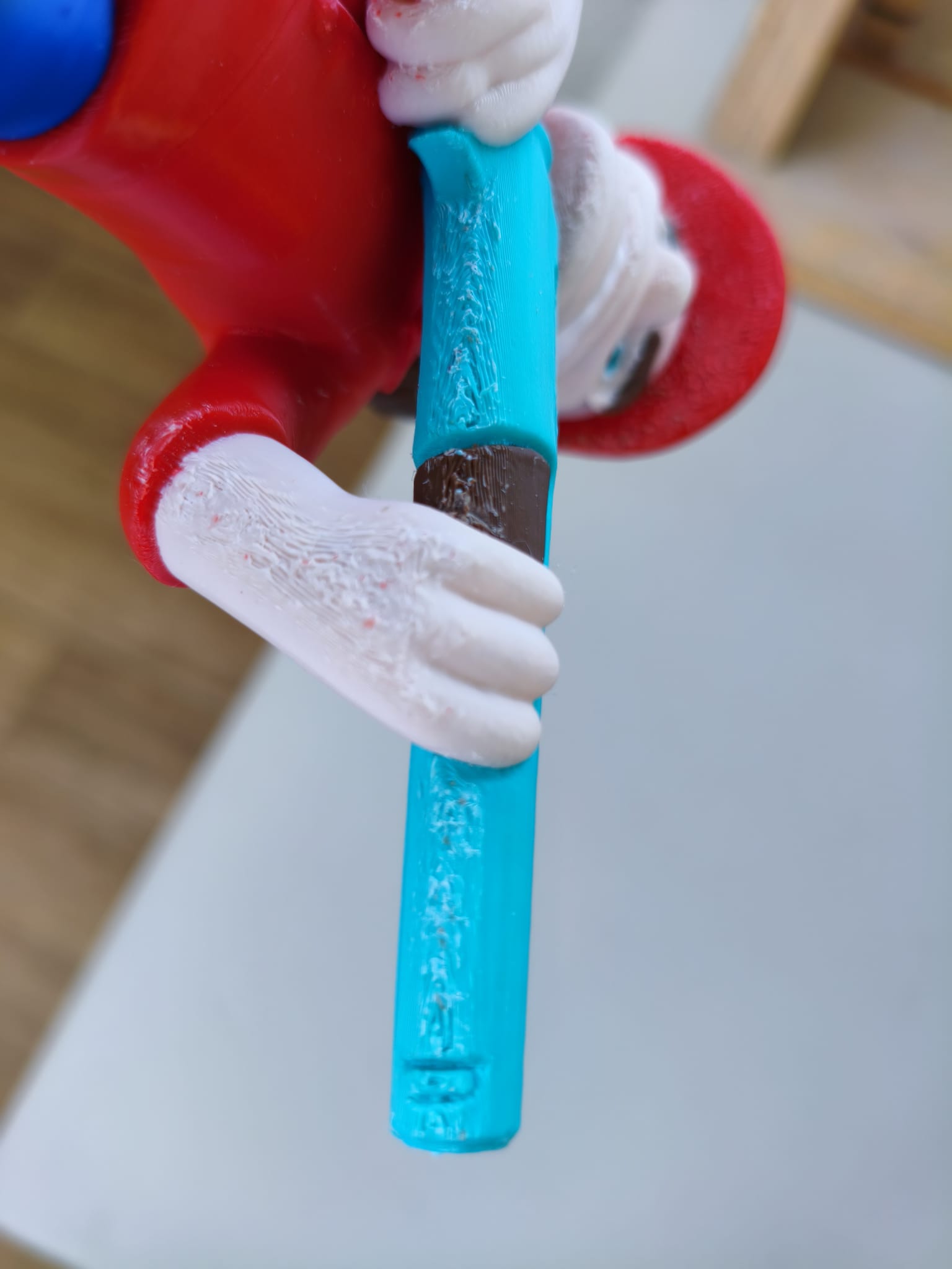

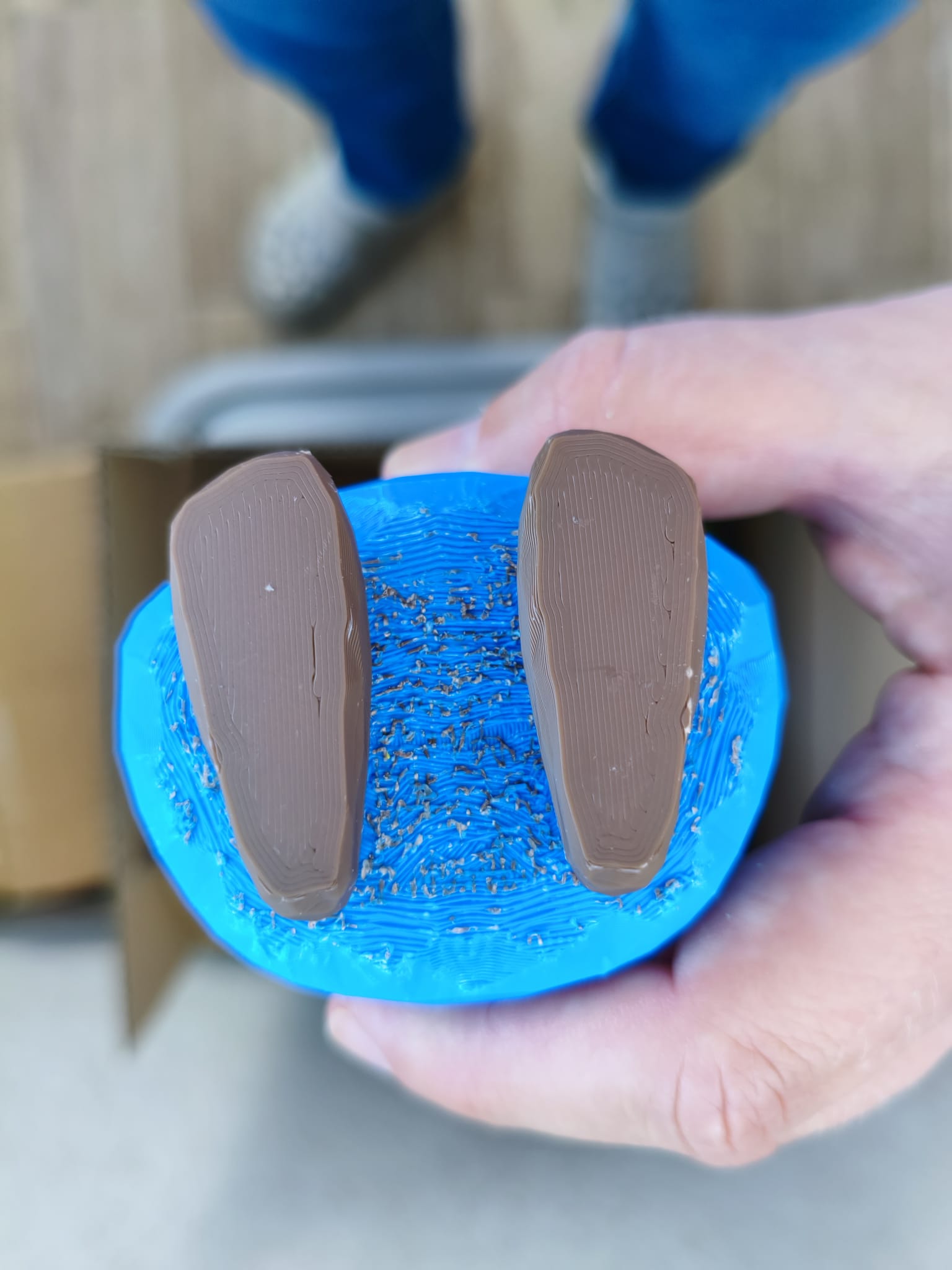

This is obviously not the full extent of it, but a few examples I photographed just now:
To my poor eyesight (and guessing) these all look like support contact points. If true, this is less about multiple colours or even layer heights (although thick ones pronounce the issue), and all about using a support interface instead.
Use a filament that won’t bond as the support interface. If you use PLA, have a PETG or support for PLA filament set.
The support interface is only used when there is contact between the support and the model. After printing, the model should be far cleaner.

As I stated in the other thread: I’m not interested in advice from toxic people, filled with Ad Hominem attacks on myself, my character or my skills. Even if the advice itself is valid, the personal attacks and abuse are not, and never will be.
I agree with @MalcTheOracle that the pics all focus on support interfaces which are usually printed with a specified z-distance to allow removal. This causes lines above to sag a little, so they look like they do.
To counter this, a z-distance of 0mm must be set. If using the same type of material, it’ll fuze with the model, making removal even worse.
Since PETG and PLA bond quite badly, you can use a PETG interface material for the interface. Just select a loaded PETG as a support interface and the slicer will drop z-distance to 0mm if confirmed by the user.
In some cases, it can be neccessary to play a little with the nozzle temps but it generally works quite well on smooth overhangs.
You can also go to water soluble support interfaces. I prefer BVOH over PVA personally. But those is a little bit more difficult to work with.
