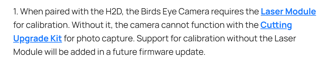

Oh… you should see this:
Wow!
@SupportAssistant is this really the current state?
Why is the cutting kit for sale if it is entirely unusable?

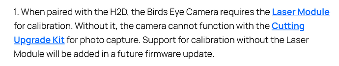

I found just what you’re looking for, AND its sold seperatley:
Quick note here, the firmware required for the cutting module to work says it can’t calibrate without the laser module, but when I did it without having to install the Laser module (although, my H2D IS a laser combo, meaning it has the hardware pre-installed, it did NOT require me to install the module before calibrating with the cutter, so I’m pretty sure that’s fixed now)
That’s not enough, you need the full laser module to calibrate the camera.
But even still, like I said the software makes no mention of any of this, nor does it seem to lack the birds eye camera.
I paid money for something that doesn’t work AT ALL, big guys please comment.

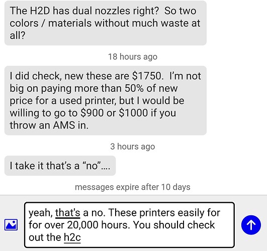

@maxim3D were you able to sell it yet? Ive had mine on craigslist for $1,300. Almost had a buyer but then he checked bambus website and backed out because they are so cheap now. I may end up gifting it to a buddy.
I have an x1c on there too. for $700 with lots of spares and 13 plates. No bites
then theres the lowballers.
