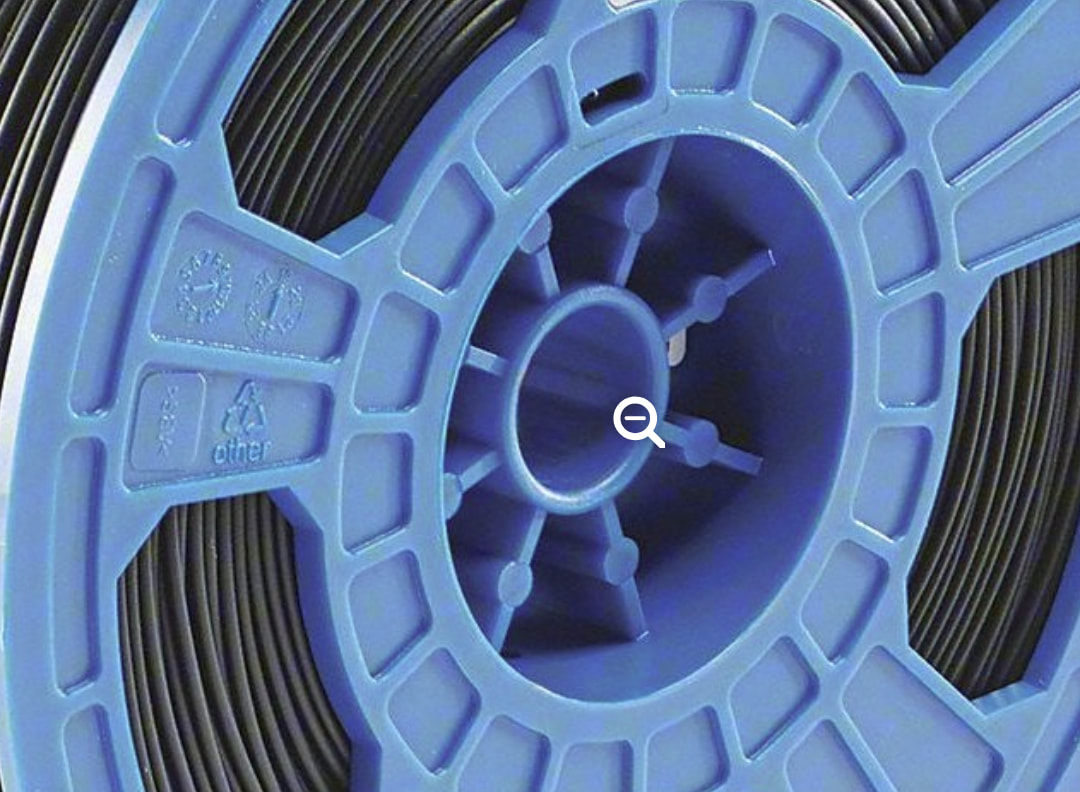

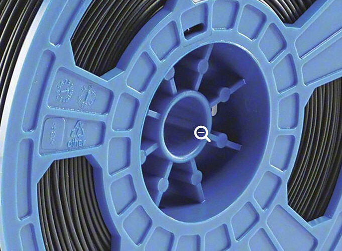

For context, this is what a dremel spool looks like.
I think the idea of drilling out the center would work great, but they also still have the dremel printer, so they wouldn’t be able to use the spool with that printer again if they did that.
It didn’t sink in that they still had the printer so yeah, destructive methods for either the cardboard or plastic spools are probably out. And I guess if they are trying to do multi color prints the external spool holder types are probably out also.
