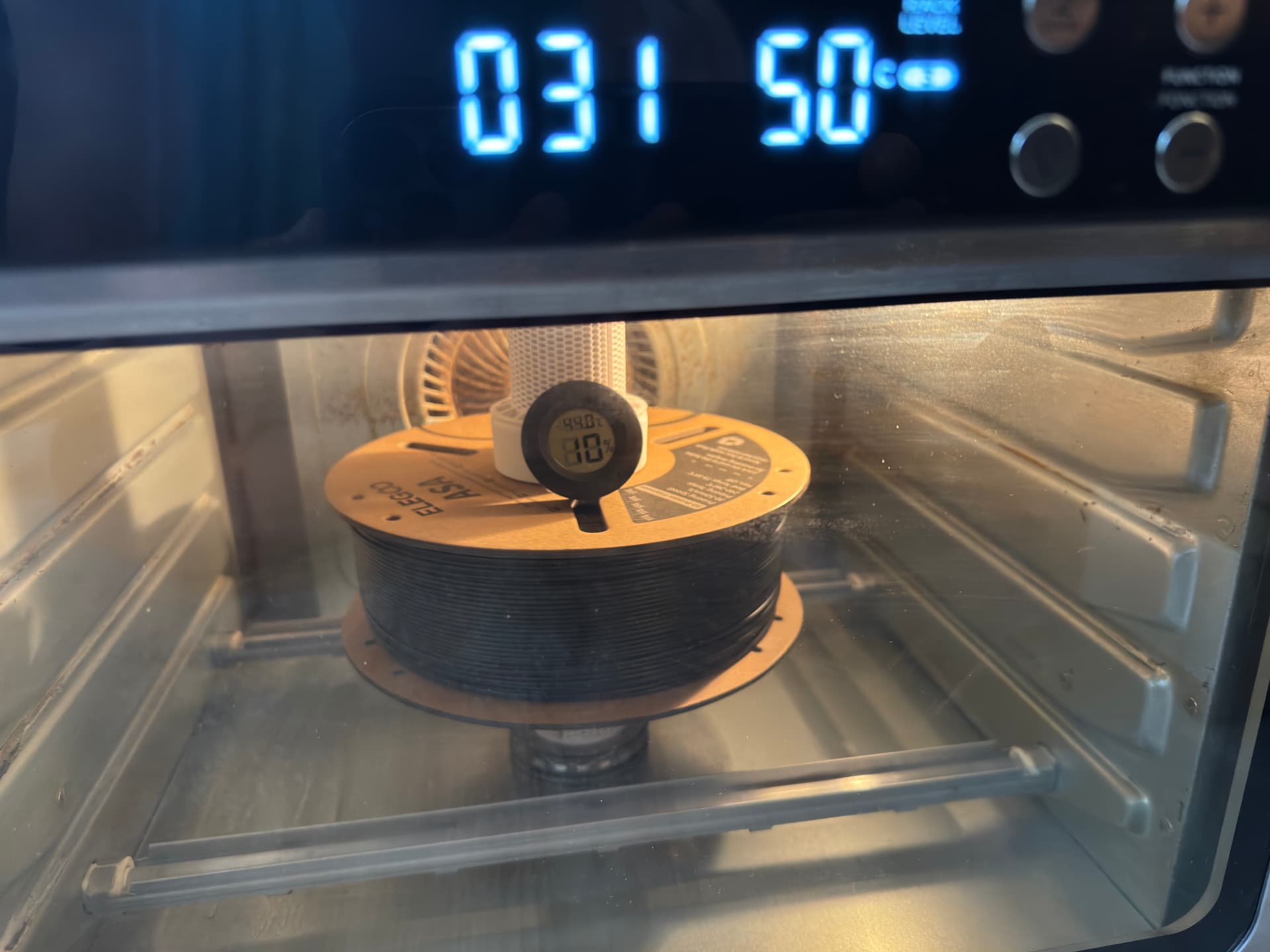

Hi a rookie here, just started in the hobby for less than a month.
did lot of research and jump into P1S with AMS pro 2
i was doing research for filament dryer as i already printed with PLA and PETG without any issues. but i want to start using ASA later on. read that it needs higher temp and also it has more issues regarding to moisture compare the PLA and PETG
doing research i came on a youtube video guy using his extra air fryer.
but i dont want to use my own cooking with drying filament in case of oil and grease.
so i was able to find a cheap used air fryer oven for $10 CAD specially it has dehydrate feature so it will run 30C-95C
i tested and temperature is constant and humidity kept dropping until 10% (put a gauge inside the oven set at less than 50C, dont want melt the gauge.
later i DIY the oven installed a microwave plate turning motor that i have laying around.
then i printed few spool desiccant containers, modified a little, add a bearing and now seems to work
i will post a new thread in the future.
Oh by the way it is a picture so you might not be able to tell but the spool is spining as i installed the microwave plate turning motor under the oven.
You seem smart enough, so I’ll add my opinion…
Be careful with cardboard spools, even a dryer will dry out & flake causing dust to get all over the filament.
Drying like you have it could make the spools warp download, this is why filament dryers have the spool standing up…also so you can print from them.
Myself, I would make the bottom as flat as possible & the same width of the spool…JMO

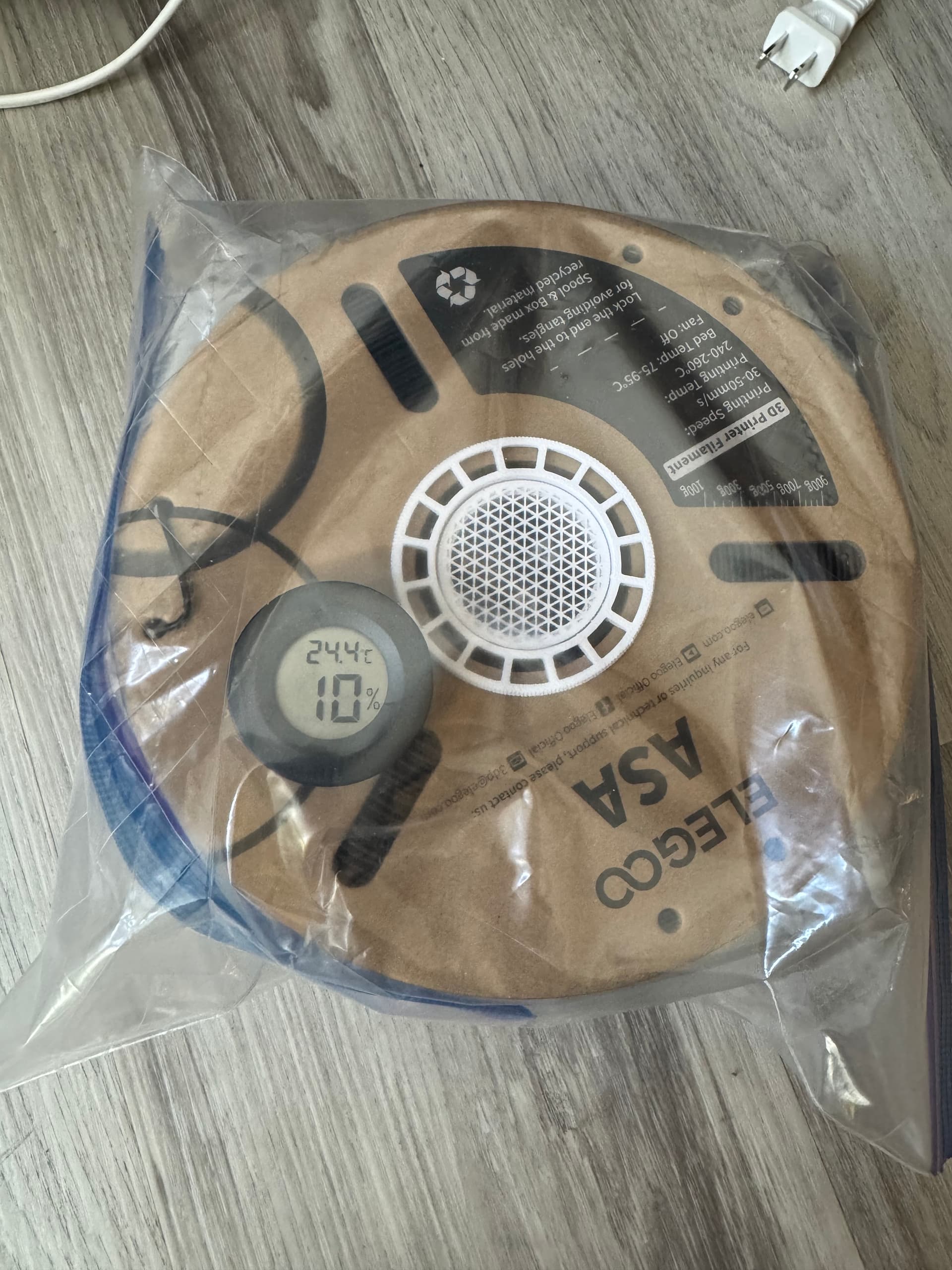

i will be using this only for drying so nothing more than 50C. after i will put them into double ziploc bag with desiccants in the center of the spool.
this black ASA roll i got it last week, but the bag had a leak, no vacuum and noticed some condensation inside the bag.
i put it double ziploc bags with desiccants last week for few of days and
dropped from 42% moisture to 38% very slow.
after i run this test with the air fryer oven for 60 min spinning last.
i put into bag again with desiccants in the center last night.
today wow 10% and holding.
i would be changing the center with a larger flat area for support. and i guess i should flip it on the second half of drying time.
now i am curious, if cardboard spools can dry out and flake, wont the vertical dryers would be even worse? specially the weight support when rolling are the cardboard spools right?
