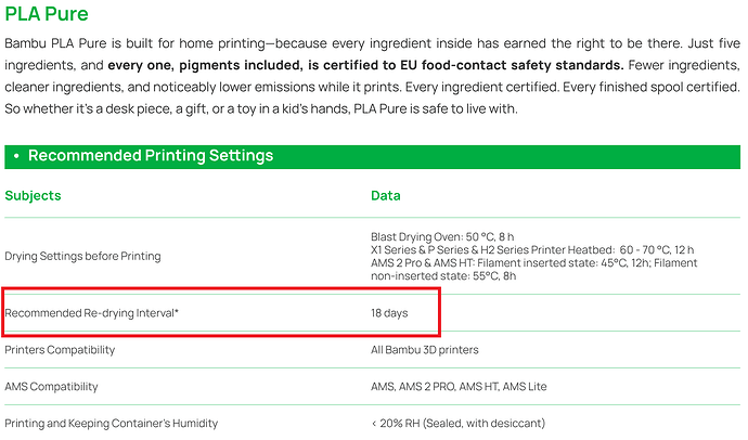

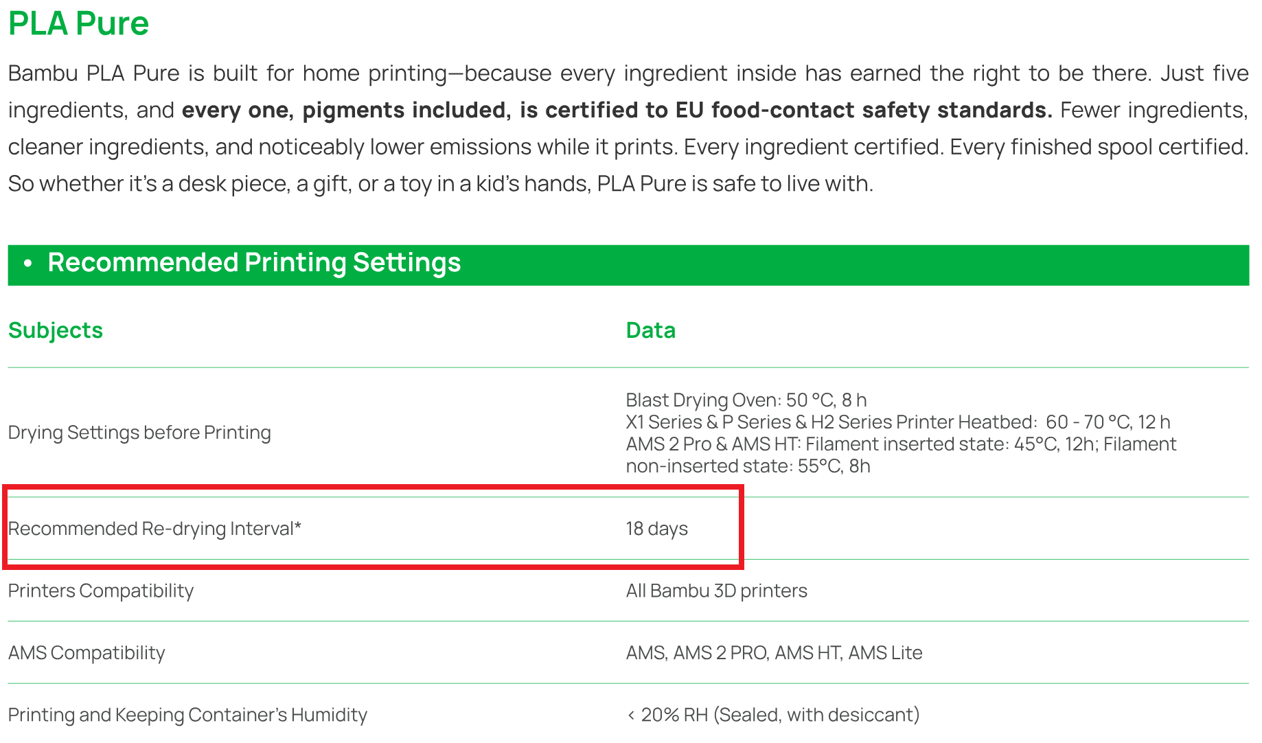

Check this link Filament drying guide for detailed information on drying times and moisture reabsorption for many different types of 3D printing filament. On the Bambu website only pure PLA has a recommended re-drying interval that i can find.
Unless you live in a swamp, PLA can be left out for months (or years) even and it prints fine without having to dry it.
There are some materials like PP that never need to be dried and the other extreme like PA6 that at minimum has to be dried before every print and (for long prints) has to be actively dried while you are printing.
I hate when companies put that kind of information in literature without qualification.
An 18 day redry time is BS that many will likely take as gospel.
It all depends on ambient humidity, storage setup, how people dry, etc. There are so many factors wrapped up in any drying advice like that and it looks like none of the conditions are specified.
Thing is, whether people need to dry or not is subjective. I don’t live in a swamp but for the best print quality I do need to dry. Others may not print demanding models or may be more tolerant of stringing or doughy surfaces, clumping, zits, or whatever water symptom.
But specifying a redry time assumes everyone is starting from the same initial moisture content, subjecting the filament to the same ambient humidity, and the dryers all dry to the same extent. No way that’s happening. A “redry” time is pure hand waving.
