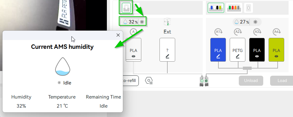

If i Google this I get mixed results.
When i check Bambu Wiki I see that only the H2D is actually mentioned.
Does this mean that it is not yet possible to dry filament while printing?
Cannot do this on the printer or in Bambu Studio.
I have installed the new firmware (01.01.05.00) from here: Uncompromising Multi-Material. | Bambu Lab
I have 2 AMS 2 pro’s and a AMS HT.
AMS B has an adapter and the AMS HT also has a power cable.

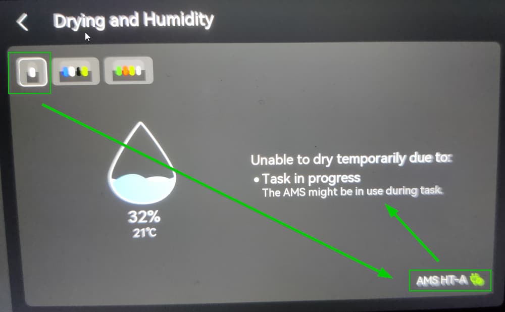

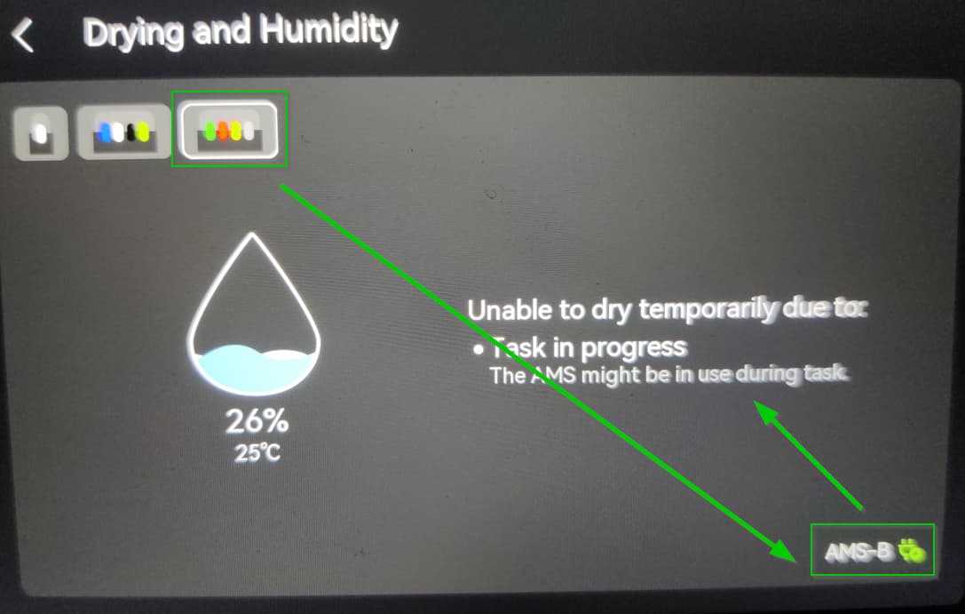

My setup is as follows:
AMS HT WITH power cord is setup for left nozzle.
AMS 2 Pro A and AMS 2 Pro B are for the right nozzle.
AMS 2 Pro A does not have a switching adapter and AMS 2 Pro B does have said adapter.
I am lost on this now.

So what am i missing?

Before i started this post I did check the Wiki and I am quoting the exact words on the Bambu Wiki:
Remote AMS drying support
You can now start AMS drying directly from Studio’s Device page for AMS 2 Pro and AMS HT.
  • Click the humidity button on the target AMS to open the control dialog to Start and Stop the drying feature.
  • You can now dry filament while printing, but the drying temperature will be lowered during printing.
i like how LITERALLY none of these people actually read your post… NO, you CANNOT use drying while filament is loaded into the feeder or in use by the printer. it does not matter how many power adapters you install… the current firmware does not allow it. this is due to them still trying to figure out how to make it idiot proof so people don’t feed softened filament through the AMS and cause reliability issues that the community will most defiantly blame on Bambu.
currently the ONLY way to dry while printing is with the AMS HT. using the bypass port in the lid and manually loading like using the side spool.

Okay, I can give you the answer even faster than expected, as it has already been asked on GitHub:
  • The current version 2.5.0 does not support H2C in terms of “print and drying”. (as we now already know)
  • The new version 2.5.1 focuses on the major Helio update and integration and does not address “print and drying” for H2C.
So, unfortunately, no good news. :thinking:
