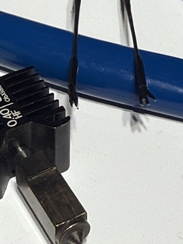

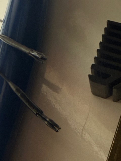

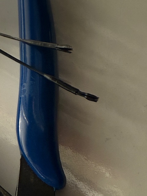

So I had a wicked clog in my E3D HF obxidian hotend that wouldn’t let it extrude when using materials under 270c and I tried cold pulling it 20 times with no prevail but I finally found a method to get it to happen, put it in a vice and use a mini torch, use nylon filament and get it hot till it starts to extrude the fresh nylon……when it cools down and it’s time to start the cold pull, just wave the torch flame over the very tip of the nozzle every few seconds but take it slow and start pulling out the filament with a lot of pressure to where it starts stretching slightly then let it rest from the flame for a few seconds so it stops stretching while pulling and repeat till it lets loose. Here are some pics of what my cold pulls look like, I don’t see anything obvious in them but I’m guessing it’s solidified in the nylon in one of the channels bc my problem is solved. I hope this helps someone from saving their expensive well worth upgrade bc it truly is a fantastic hotend with real results.
