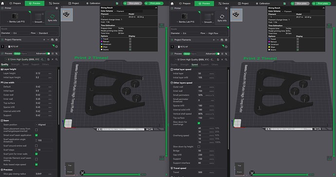

OK - so the settings that I used are as follows:
  1. Increased flow to 50 mm3 (wanted to see if this was possible to get a good print).
  2. Lowered nozzle temp settings from stock 230-245 to 220-235
  3. Turned off “slow printing down for better layer cooling” in the cooling section of the filament
I made a print of a small item and it was much faster than prior prints! Changing these three settings made the print time 28m 51s. When I reverted back to the stock filament values using the high flow setting, the time in the slicer showed 52m17s.
The print came out looking better than a previous print I made of the same item. Thank you both for finally clearing up all of my confusion with this nozzle setting. I hope that Bambu Lab will update these settings for their filaments when using the E3D nozzle. It seems that the “high flow” setting does basically nothing but increase speeds slightly which does not lower time for printing very much.
Again, thank you so much for your help! At least I can use this nozzle for what it was intended for - speed!

So, I wanted to see how fast I could print a benchy after you asked about the nozzle. I downloaded the “speed boat race Bambu PLA profile” and I just ran a PETG speed benchy using the setting at 50 mm^3/s and it came out at 14m 20s print time! Total time was 21m29s (setup was 1/3 the print time at 7m 9s). It had issues with the top circular smokestack, but everything else was pretty good for this fast flow rate and lowered temperature.
Well, after updating bambu studio to the latest version, it seems that this method of speeding up the print time does not work anymore. Selecting a higher flow rate does nothing to reduce the time of the print. Not sure what broke between versions.
I assume you’ve set the nozzle as High Flow on the printer and selected it as the nozzle in Studio as well.
Yes, it is set up as high flow on both the printer and studio. When I change it from the default PETG HF to my setting for 45 mm3/s, it does nothing to change the print time. The 45 mm3/s setting also has the “Slow printing down for better layer cooling” unselected.
Changing it from high flow to standard also does not change the print time.
Well, I did a bunch of changes without any headway. It looks like under filament settings there is now a direct drive standard and direct drive high flow selections. When looking at these, there is a change in the max volumetric speed - standard =21, high flow = 29 and also in the flow ratio - standard = 0.95 and high flow = 0.952. The slow printing down for better layer cooling is turned on for both standard and high flow settings for the filament.
The interesting thing is that if I change either the direct drive high flow setting or standard setting –> max volumetric speed to something very large like 70 mm3/s and turn off the slow printing down for better layer cooling, it does not affect the print time. Not sure if the software is reading the max volumetric speed setting after it is applied.
Is it possible, that the process settings have been reverted to default, especially print speeds and line widths?
Then flow rate wouldn’t make a difference, because actual flow is limited by speeds and line widths, not filament max flow.
