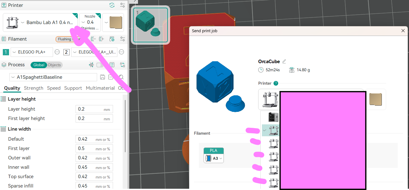

If your two printers are the same model [and in similar states of repair :slight_smile: ] you can hold one Slicer Machine profile for them all. At print time, just select which one to send the job to.

Don’t overthink this. It’s as simple as adding the second printer to your Bambu account. Then from (one instance) of Bambu Studio you can pick which printer you want and select “Print Plate" which will slice the print for that specific printer, transfer and start it. You can then do the same for your second printer. You can monitor/control each printer by simply selecting them from the device drop down menu in Bambu Studio. You don’t need Farm manager or even to enable multi device management.
