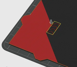

Edge to edge Monotonic line without reversing on holes or other object
Is there a way to make sure the Monotonic line on top surface continues on the same path edge to edge instead of reversing when holes or other object is found in the middle? This is causing issues on the top surface because the other line dry and then doesn’t blend as well.
This shows the current behaviour… it would be great to see it folowing allways the same diagonal path from one edge to the other.

Thanks for your considerations. Maybe I didn’t explain it correctly. I’m not sugesting anything out of the ordinary from a math or FDM 3d printing point of view.
Maybe using your marker and sheet of paper example is easier… In 3d priting I can lift the marker wihtout actually lifting it! Consider the stop extruding the lifting :slight_smile: so what I was sugesting is a solution where it extrudes, then stop extruding while continue the same path and then re-start extruding… like this the line is countinuous with the exception of the place where there will be an object or hole.
