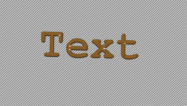

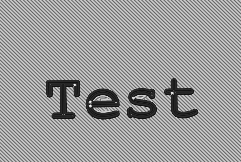

i am trying to add elevated text to surfaces. It looks good in the preview, but as soon as i slice it, i get imperfections, and not even a few.
Here ist the simplest example i could think of:
  • i created a simple cube
  • added text on top of it. The text is not embedded, but a bit elevated.
  • i colored the text in a different color then the cube (in my example black, the cube is white)
  • i sliced it
    this is the result:
What is happening here and how can i resolve that problem?
what exactly is wrong with it? To me it looks fine. The white dots are not being printed but they show the position of the seam, e g. where the perimeter starts and ends.

Are you concerned with the “Seam” points showing? Seams are inherent to FDM printing, you won’t ever stop managing them. The slicer is showing you where they are being placed. You can toggle these things on and off in the preview tab after slicing
No, i want the white dots and streaks in the Text gone.
panamon did help me with my understanding: the text is simply to fine to print with my 0.4 nozzle, i scaled the text up and it basically is none existent anymore.

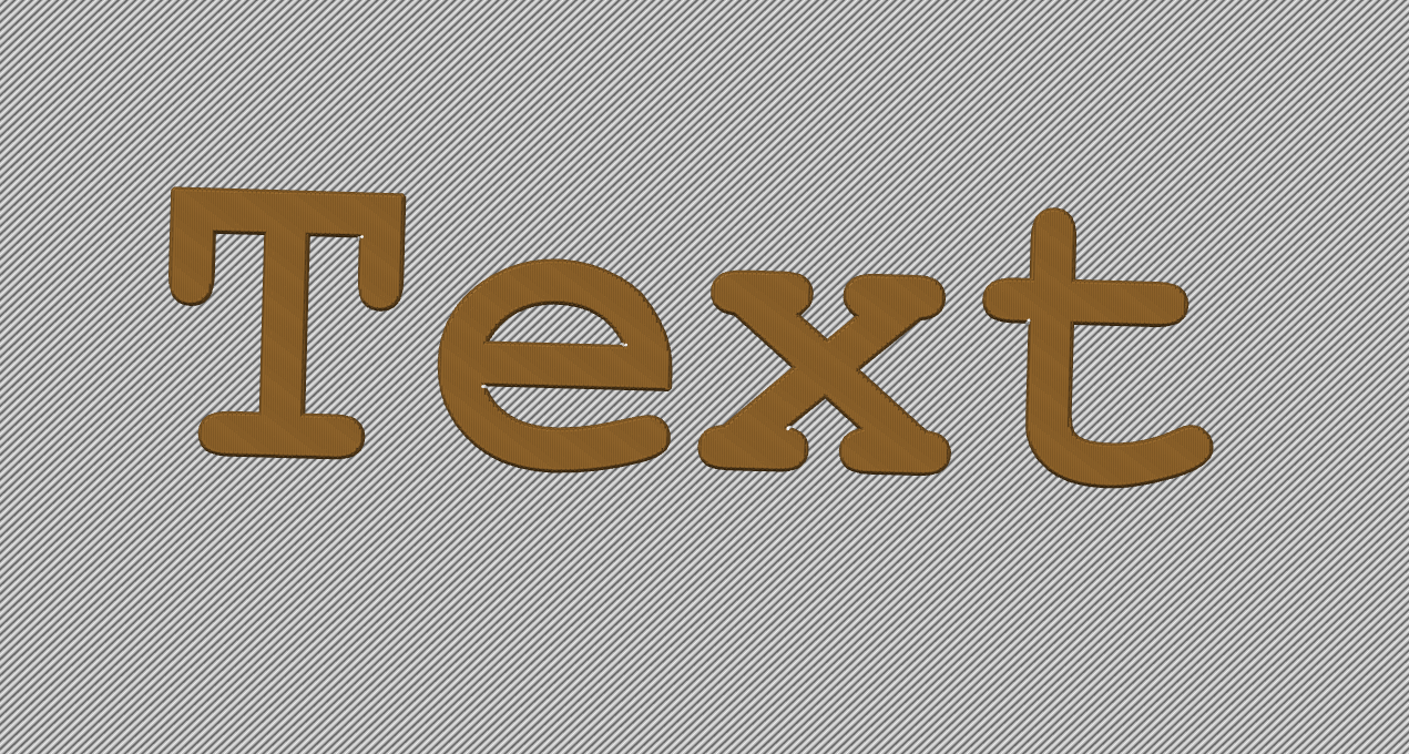

20 mm Text
looks great!
10mm Text
looks good!

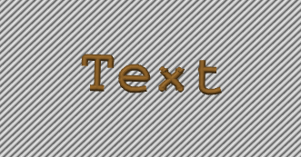

5 mm Text
yuck
So there is a natural cut off point, probably some multiplier of my nozzle size i guess?
Do take the preview with a grain of salt, it’s not 100% real life since it displays line ends square not rounded as would really be so if parts of your text has just a single line then it may look a little funky in the preview and/or show gaps

I did it guys!
What did the trick for me was scaling it up a bit, so it wasn’t as small anymore, and enabling “detect thin walls”.
Thank you all for your help, i appreciate it!
