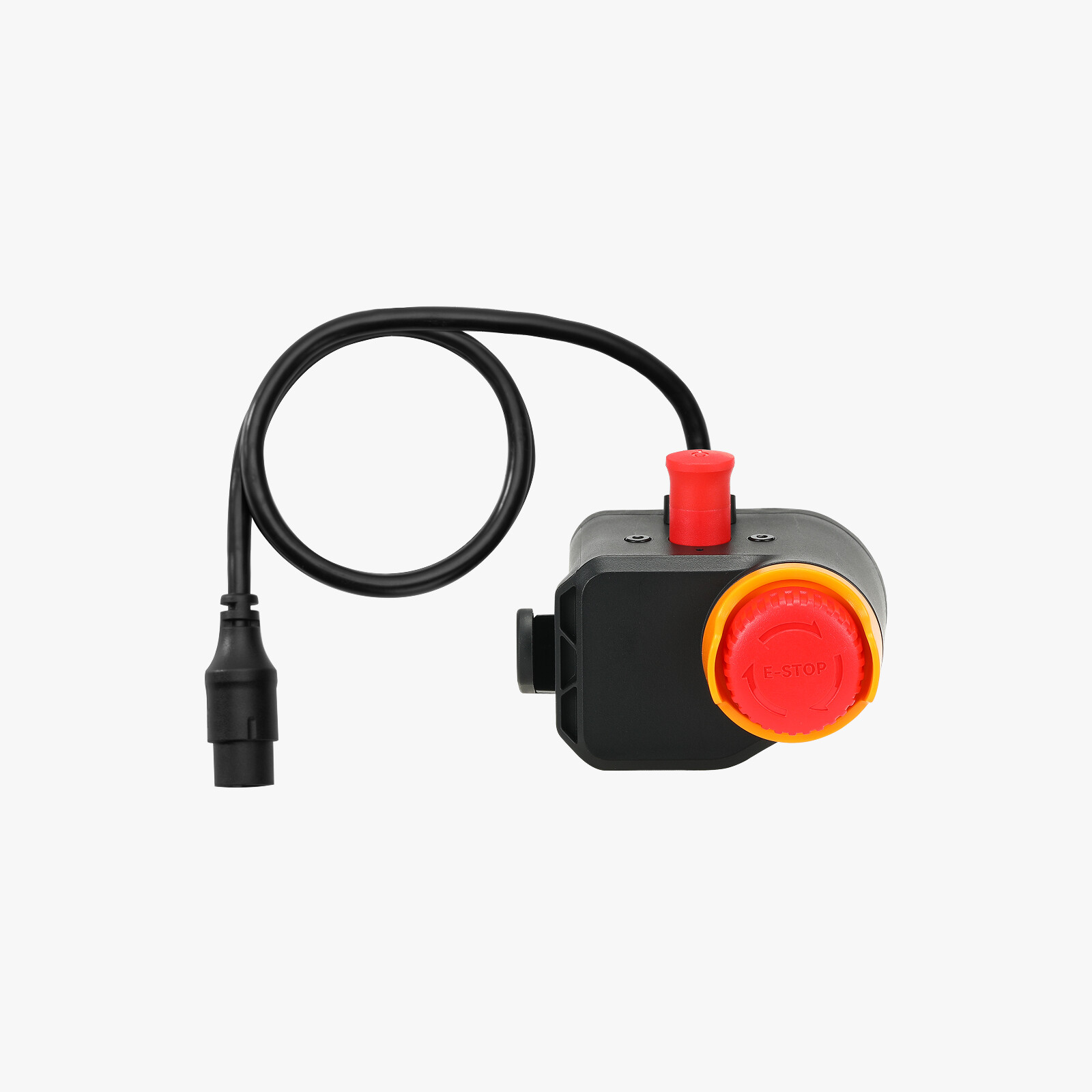

The button which you suggest likely has some function or some planned function (maybe on the laser version?)
On the H2D it does nothing.
On laser versions it has a function.
A power button (or a real E-stop) needs to be wired to accept the duty, or more clearly, it has to be physically wired to be able to handle the current. I imagine it could be a sleep button, but I doubt that has the same interest that a dedicated power button or E-stop. A virtual E-stop may be doable, but it wouldn’t be a real E-stop. It would only send a stop command, not cut power. If everything is working fine, it would serve the purpose you want. But if something is haywire… it may not, unlike a real E-stop.
