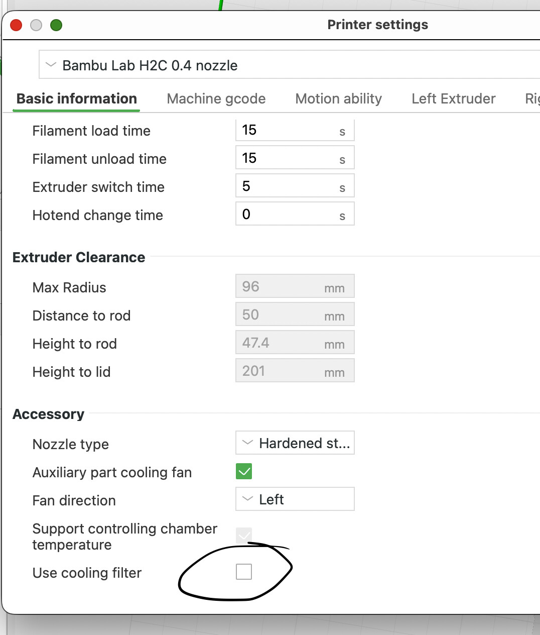

I print PLA/PetG and TPU and I am quite sensitive to fumes coming out of the printer. I have so far performed the following with very positive results.
  1. External filter attached to the fan exhaust. I used K Y Z design’s external filter which accepts 2x Levoit Hepa filters. I think this is the best option as increased surface area has several positive effects (less resistance - slower air flow - better filtration)
  2. I put a simple paper filter to the top vent. I used Vipan’s design and filled it with a thin paper filter. (I couldn’t find a steam activated active carbon mat)
  3. I filled the empty slot above the stock hepa filter , with maxim3d’s carbon pallet box. However I’ve modified it a bit. First I put a paper air filter in the front to protect the carbon pallets and extend their life. Then I printed a tpu seal around the box for better fit into the slot. Don’t forget to use steam activated carbon.
  4. I am now using an enclosed poop holder. There are a few nice designs.
I also have an external hi performance Hepa filter but it certainly wasn’t helping a lot. Above items fixed the issue almost 95%
Now I will add aux fan conversion. It’s not going to be very efficient for cold filaments but should still help a lot.

Hi. What is the status of this? Har this option been implemented? :slight_smile:
Latest firmware update allows you to set this up on the printer, but you could set it up in the printer profile before this.
How? Do I just enable “Filter” on the cooling menu? Do I have to do that manually for every print?
How should I do it on the printer profile?

It’s a checkbox item in the printer profile
I don’t see this. Do you mean the option to filter at the end? That seems unrelated to filtering during PLA prints.
In the printer settings: You need the latest firmware also.
