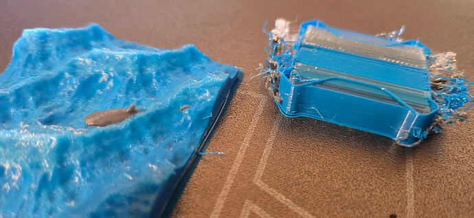

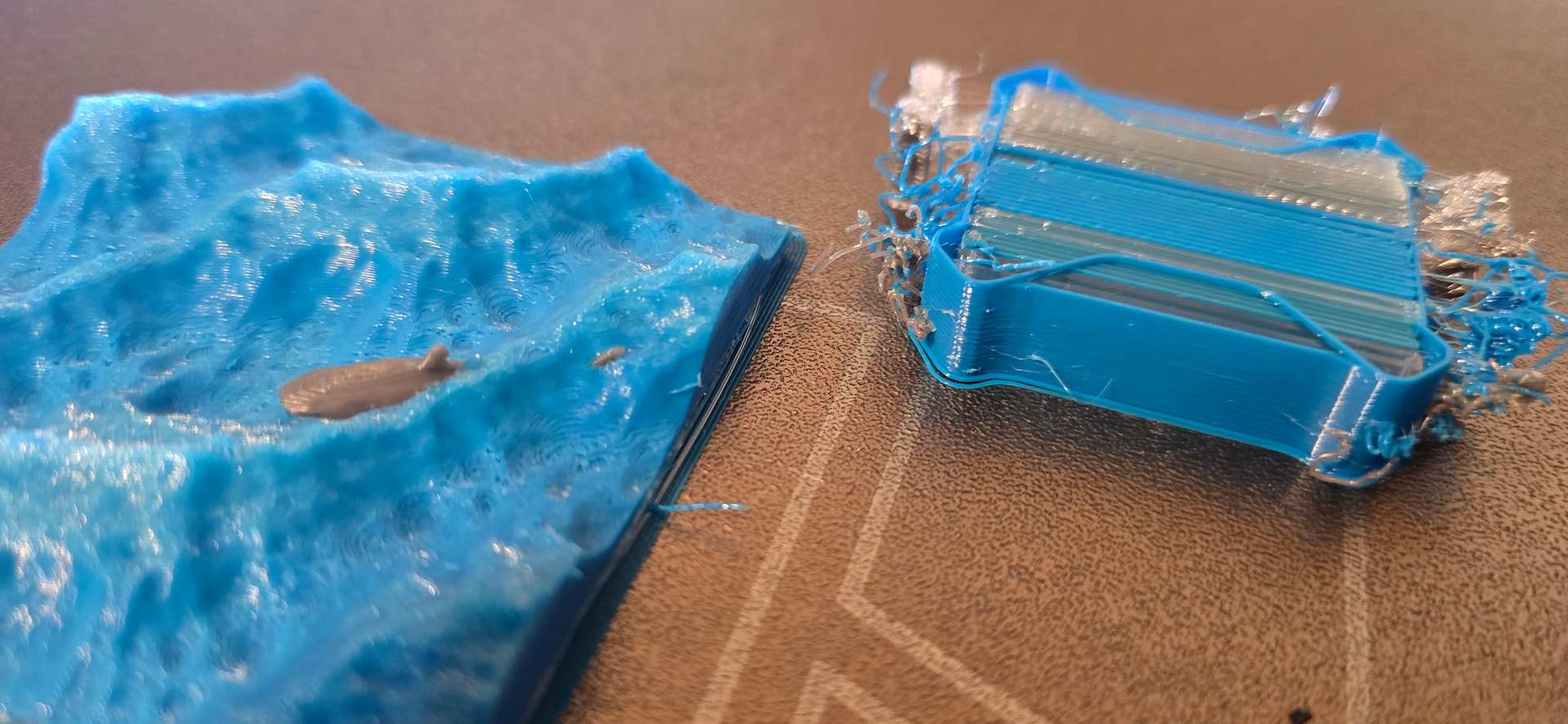

I like the mixed filament option. However, with the amount of transparent filaments on the market, not allowing a change filament at a certain layer limits creators cleverness to create their own illusions to compliment the mixed filaments capabilities.
I was hoping to add a change filament to a full translucent as the layer reached the body of the shark thus being able to see the full body under the water. Without having the pause available, I had to settle on pushing the mixed filament with as much translucent as possible. Even with that, the layers in blue still block the illusion.
I had to do this in PETG as that was all I had for translucent.
Also, could you fix these prime towers, you can’t see it in the image but beyond the messy tower, I have debris from the tower all over the plate.

I actually started on that last night, I took it to tinkercad, made 2 copies, made one smaller, aligned and turned the smaller one into a negative, l grouped to cut out the smaller. Then sent the cut out larger and a copy of the smaller back to bambu. The smaller is not a mixed blue/transparent and the larger completly transparent. Its printing now.
