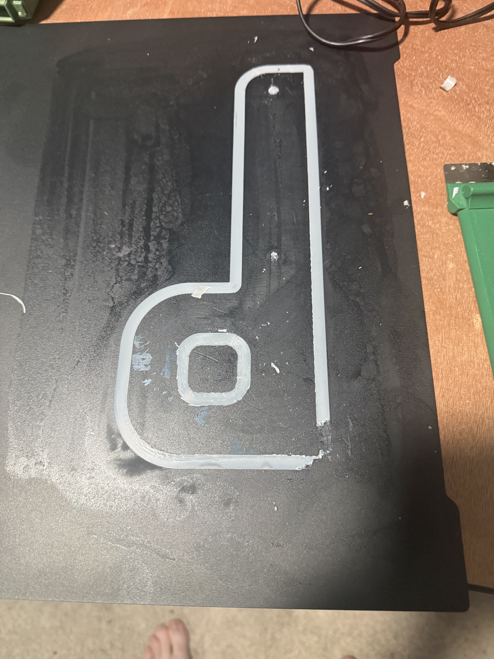

Not sure what happened. I cleaned my build plate and applied a small amount of liquid glue to the plate. stuck it on the printer and printed some ASA. Well, needless to say, the print didn’t lift off the plate, but it took part of it with it when it was done.
Anyone know why this would have ripped the coating off of the build plate?

Im assuming thats just the brim?
The Bambu liquid glue sucks. I recommend the Vision miner NPA.
A little bit of ipa and some scrapping will get it off. Just let the ipa soak in for a few minutes.
Maybe I am blind, but I dont see where the coating is ripped off.
Nice foot btw.

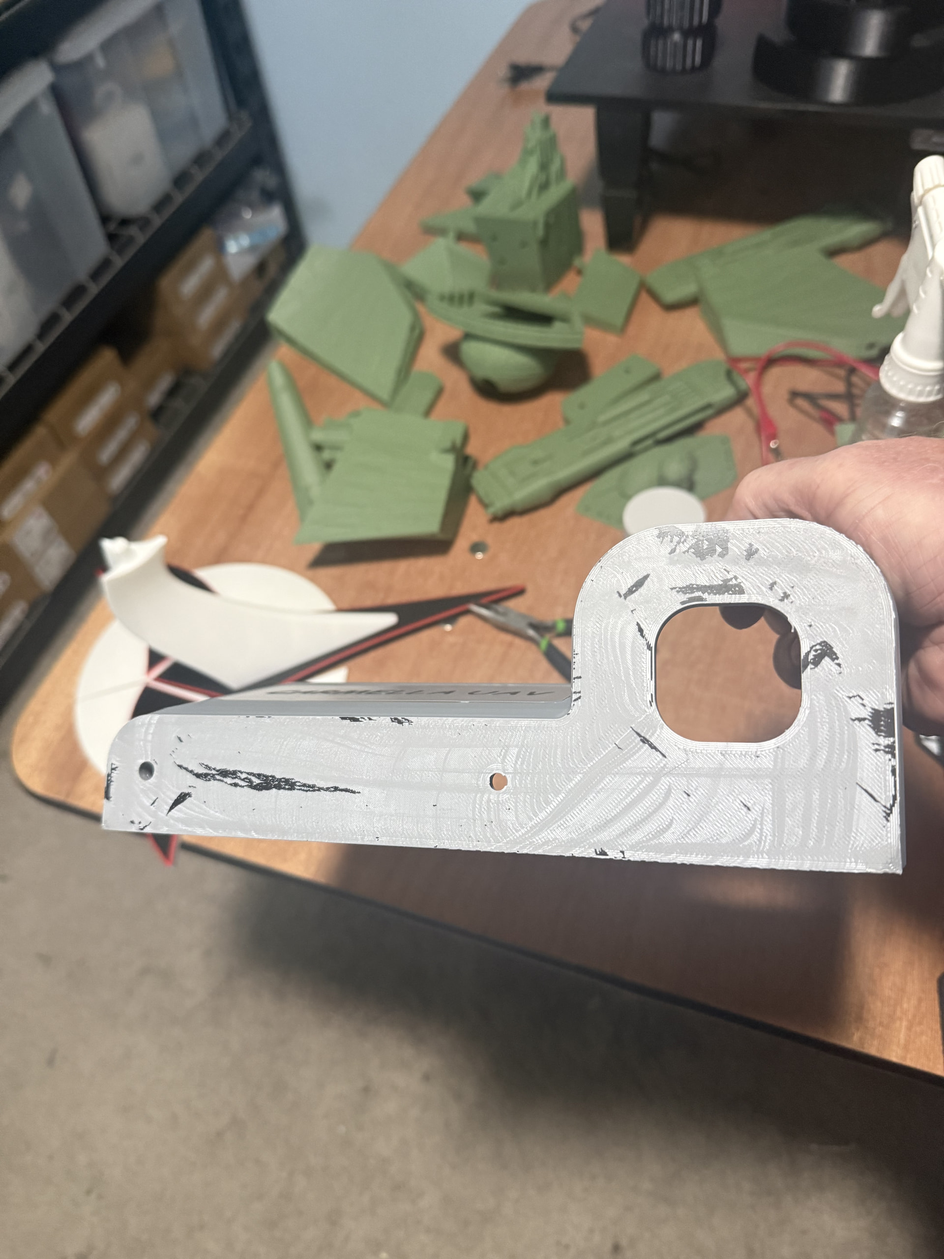

I wish it was only the brim. quit a bit is on the bottom of the print. this is not going to be seen so that isn’t the issue. The bald spots on this plate is what makes me angry. This hole part of it is now ruined.
I just bought tons of this glue, I thought it would be good for these printers. apparently not.
Yeah, that shows better. You definitely ripped some of the coating off. The plate is probably still fine. Still have the other side.

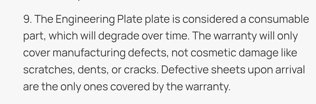

Sadly, support wont warranty wear items like the plate. Its unfortunate, but it is what it is. I think the engineering plate is great, but the coating on it is VERY sticky.

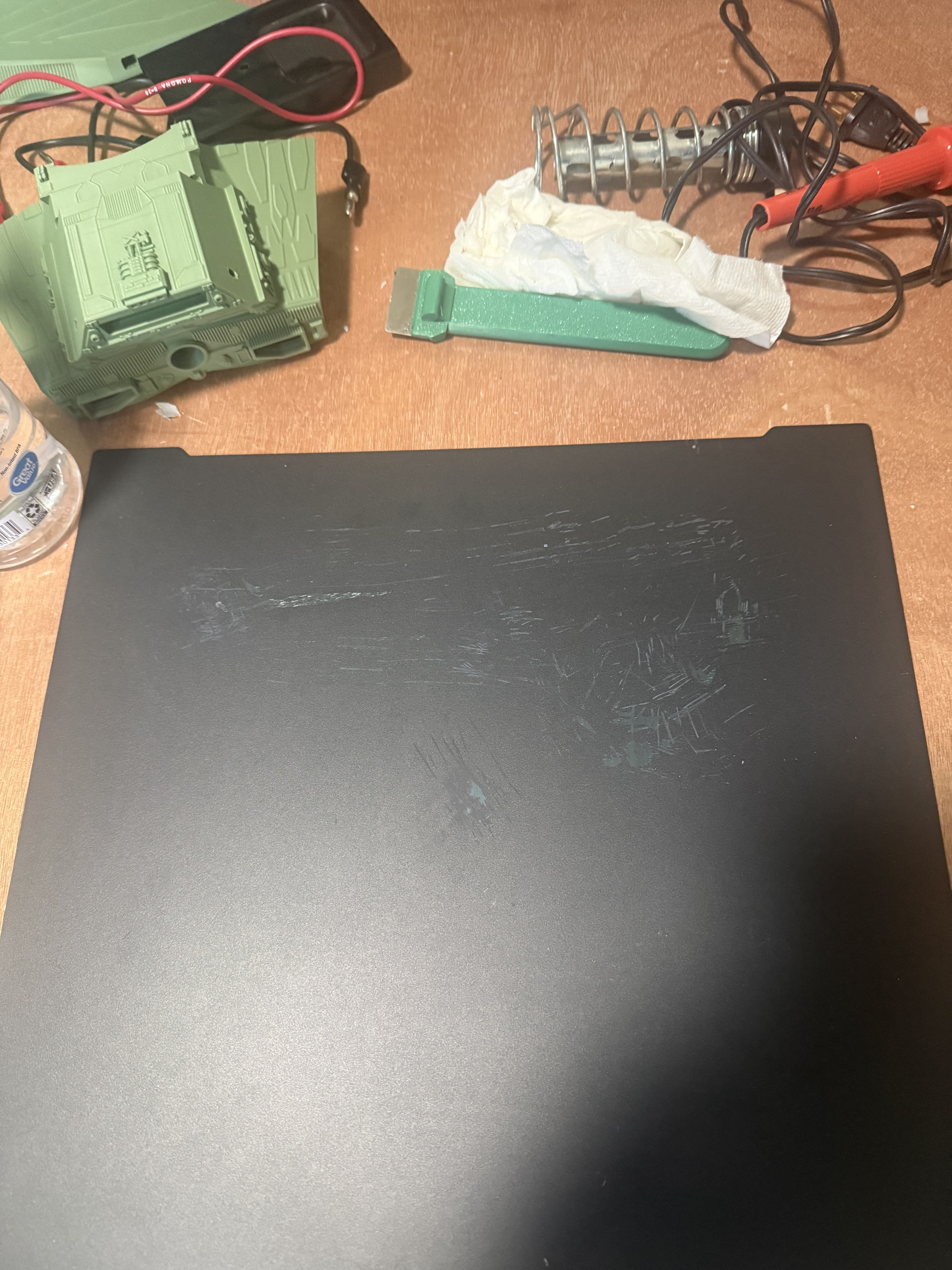

After tons of IPA and some scraping, I was able to remove the stuff with quite a bit of the surface with it. I do have the other side and the back half of the plate.

I don’t see this as a wear problem, I see this as your product broke my plate problem. Saying yeah Bambu’s liquid glue sucks and brushing it off is not really a solution. Companies should be responsible for their product, especially if it negatively their own product.

The latest price for a new P2S engineering plate is €30, so I opt to use only one side off the plate for every print, at least then you have 2 bites of the cherry before a new purchase.
Doesn’t make it right. Just because it is a consumable does not mean it is exempt from damage due to someone else’s actions or defects that show up later.
In this case destroying it with a scraper, and tgats bambus fault?
I agree, I only had to use the scrapper to remove the brim that was left behind on the plate that just would not come off. The rest came off on the bottom of the print when I removed it. No scrapper was involved there. Not sure why it did that, just that it did.
