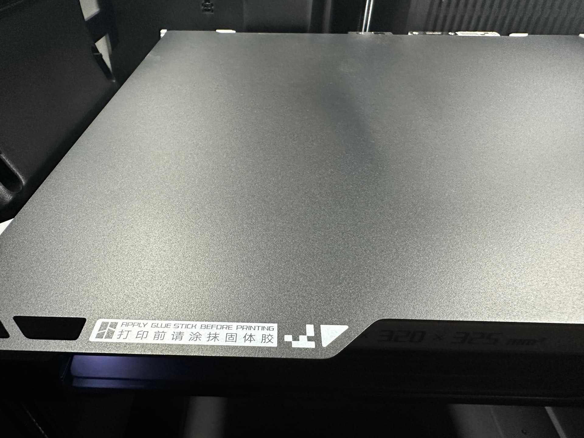

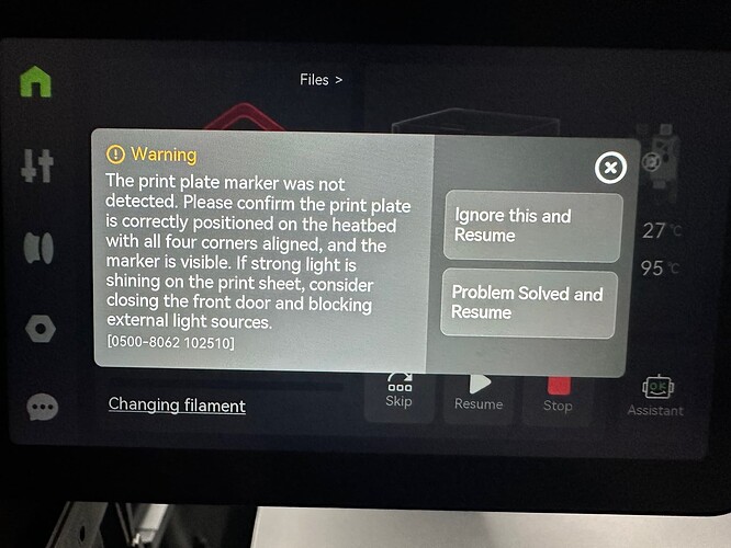

Hi,
I tried for the first time my Bambulab Engineering Plate and got this error message.
I tried both face, then finally choose to ignore error.
What is wrong ?

Might be that the firmware is not supporting it yet. So temporarily you can disable the plate recognition in the settings.
I believe the new beta does.

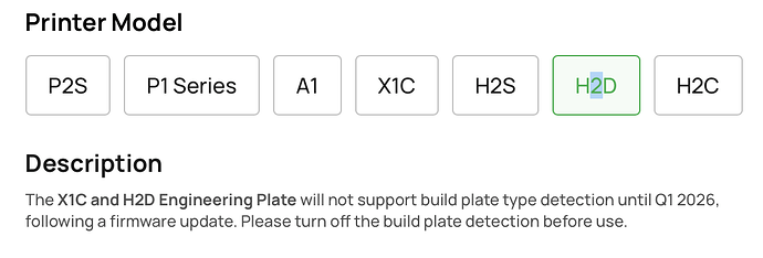

It still says in the (EU) Store, that it will not be recognised by the H2D until Q1 2026. So maybe there will be another firmware update until end of march.
Yes, that’s right :unamused_face:
But I did use it on my H2D during the last 2-3 months. It just not recognised. You can simply disable the checking or just hit ignore every print. It will continue normal afterwards.

I ordered my engineering plate very early in the Bambulab EU store and this note was there from the very beginning.
So this is classified as a missing feature, it is not a bug.
It’s not correct. The webpage I took a screenshot says as much.

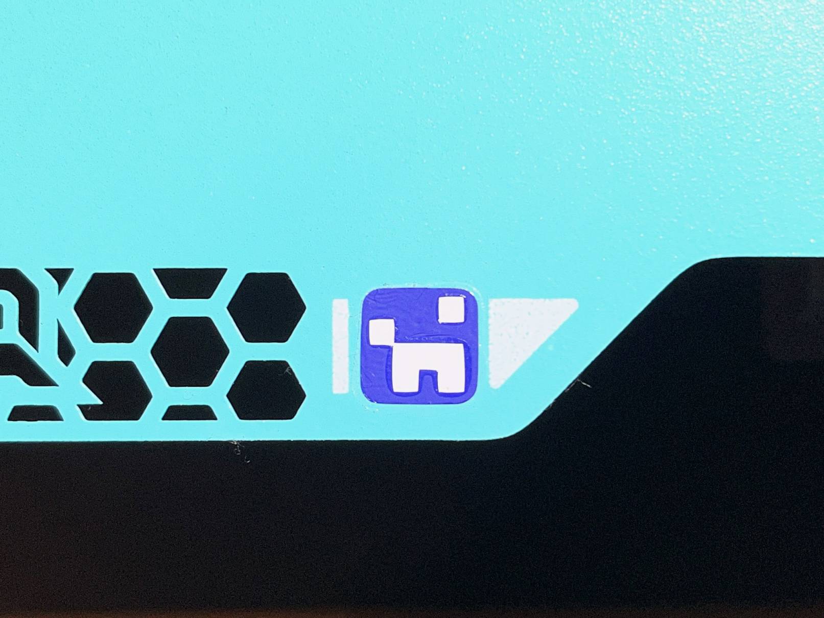

I’ve tried printing them on sticker paper, I’ve tried Wham Bam plate stickers, I’ve tried BQ’s stickers, and I’ve tried with my label maker. I cannot get my HS to recognize any of those. Aggravating, but gives me a quest to work on.
You mean affixing an engineering label on a glacier plate that is not recognized by the H2S?
It happened to me on my first 2 attempts on my H2C until I needed a high contrast code. I cut a square of dark blue heat transfer vinyl that I ironed on. I then cut the code in white and ironed it on top of the square. It works every time.
It should work with sticker or anything, I just wanted it to be unremovable and could withstand the highest temperature of the heatbed but it’s certainly overkill.
I read somewhere that the vertical line before and the triangle after the code were both important (the spacing might be as well). I did not know that before I ironed my code, luckily I did not mess with any of them.
Btw, this is the code for the H2C, may be the same for H2S but I don’t know
I hadn’t thought of cutting them. Thanks, will give that a try. I’ll more than enough just to fill a line up on the vinyl.
I tried using a 3d printed code on my H2D that some people had a problem with and I worked with the poster of the model come to find out after I did a bunch of measurements and made my own stickers that worked I found that the printed model was only a couple millimeters off. So the sticker has to be in the exact place in order to work.
