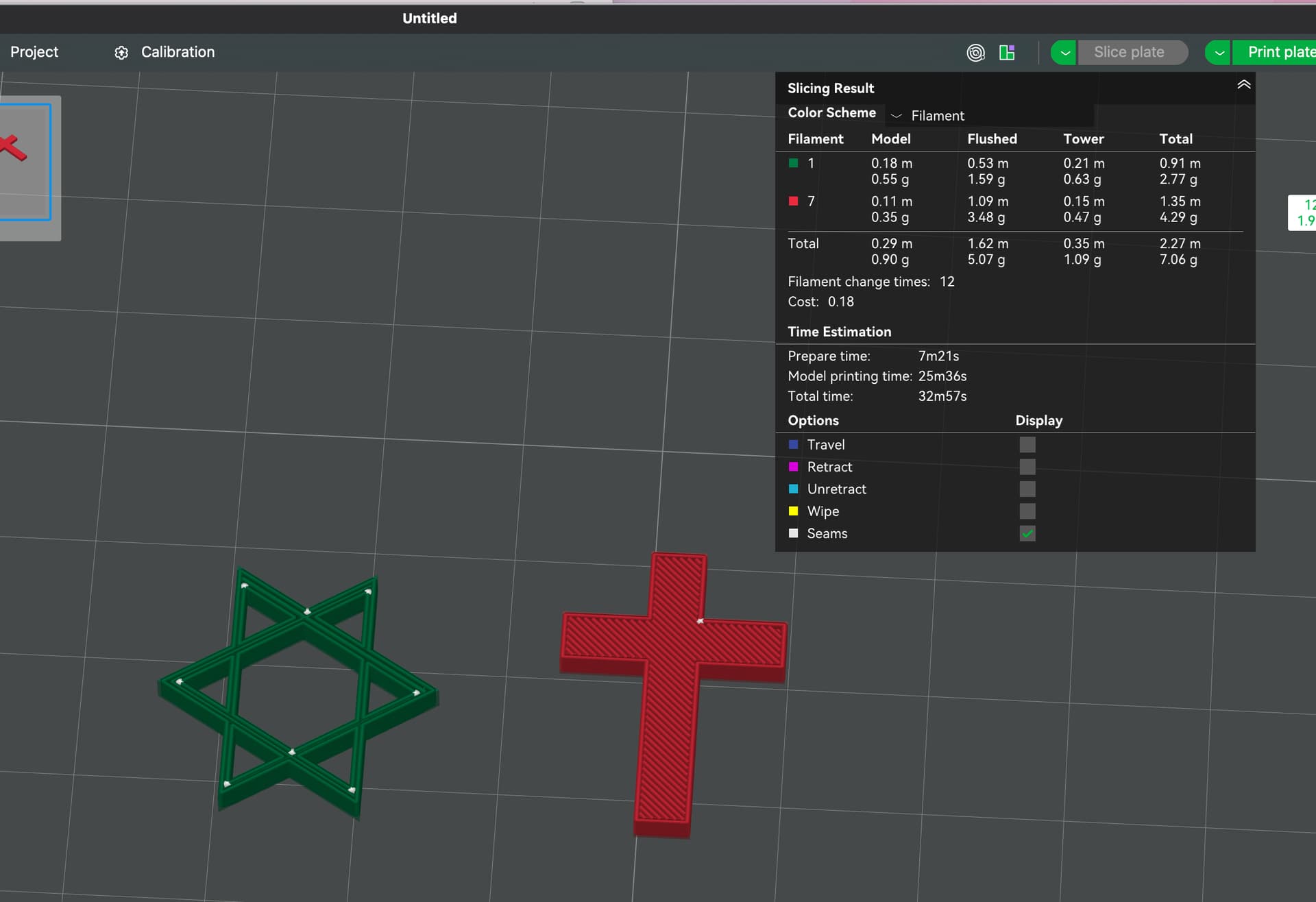

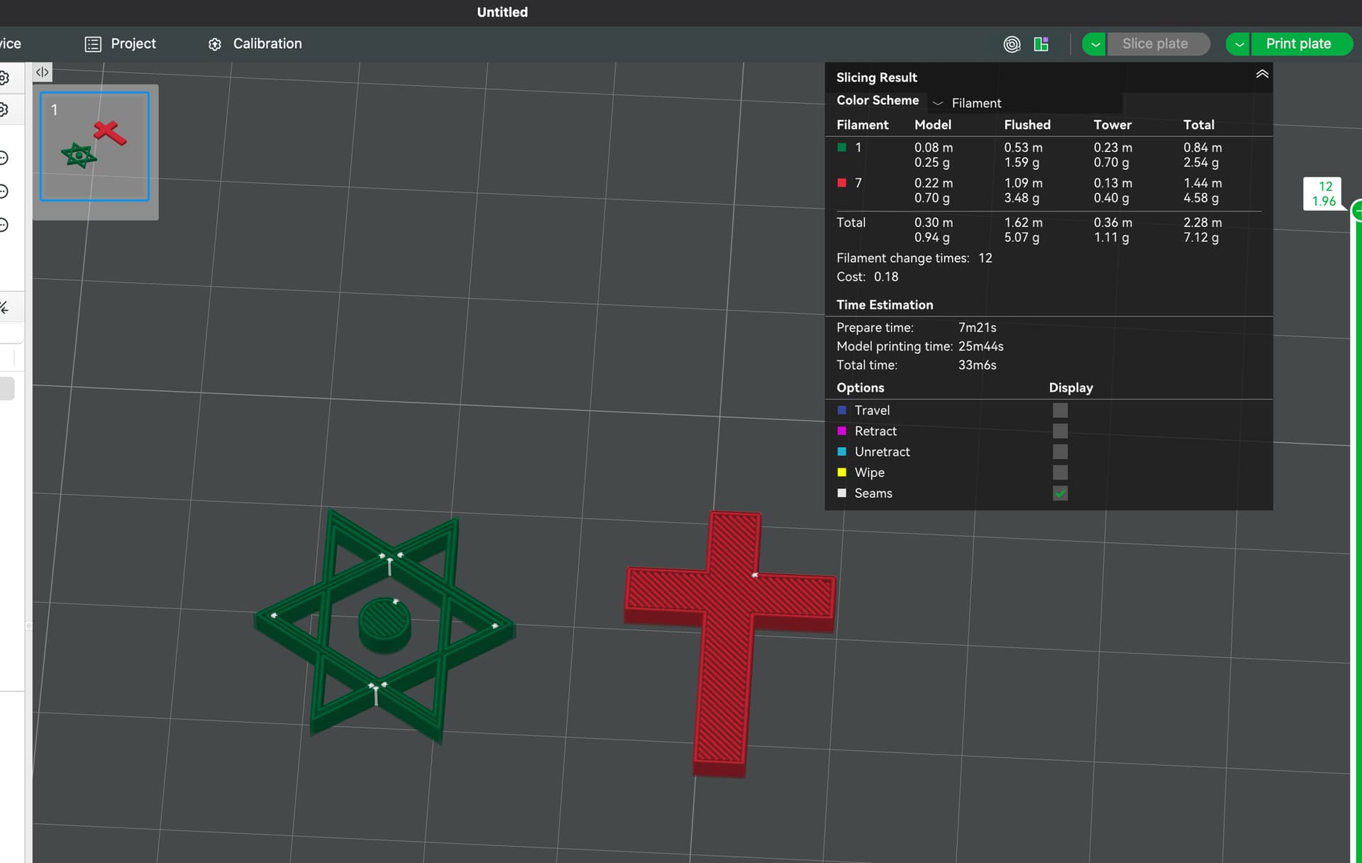

Hello - very strange behavior that I can’t figure out. I am trying to make two objects of equal weight for a spinning object. See screenshots. The projected filament used is varying unexpectedly. The red cross suddenly goes way up and the green star goes down after I ADD another shape?? Any guidance on what is happening?

In addition to what olias mentioned, the estimator is at it’s absolute worst when it needs to factor in filament changes. You may get better results when you dont slice both like that. Seperate plates or print by-object so there is only (1) filament change instead of (12)
