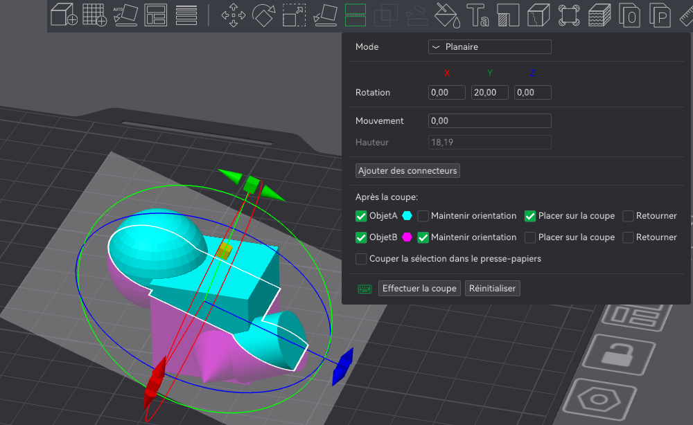

I can paint the different shapes using the ‘Paint Color’ tool.image
I would like to be able to cut it, preserving its shape and color.
Currently, I can only find the tool for making a planar cut (or dovetail cut).image
While you can orient and position the cutting plane as you wish, the entire piece will be separated.
Even right-clicking doesn’t allow me to select the entire desired area.

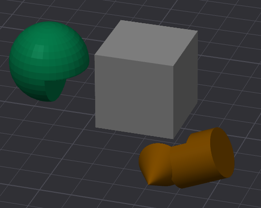

I’m looking for a way to obtain three pieces.

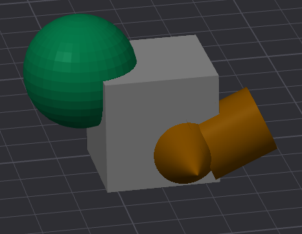

(For this example, I used five different pieces, merged, and used Boolean subtraction operations. But I’d like to be able to achieve the same result with a single initial object).

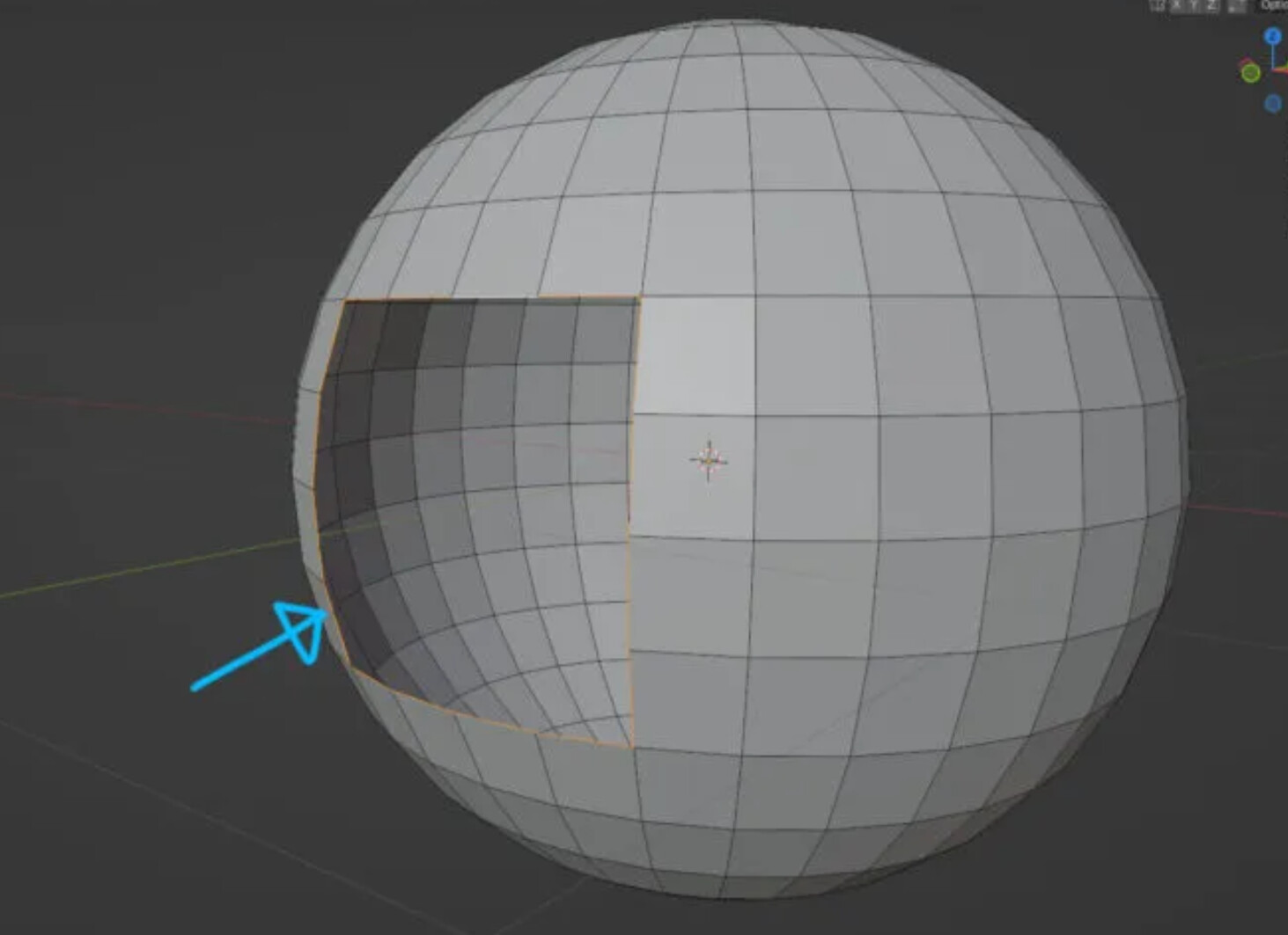

  • Meshes are just shells; they are hollow inside. When cut, they resemble two halves of an eggshell. The programme has to close the mesh and make it manifold, otherwise it cannot be printed.
This is what a mesh looks like from the inside, hollow, like this sphere, for example.
The most common problem occurs when someone cuts a mesh so that it is no longer manifold. Then people wonder why the 3D printer produces nonsense.
