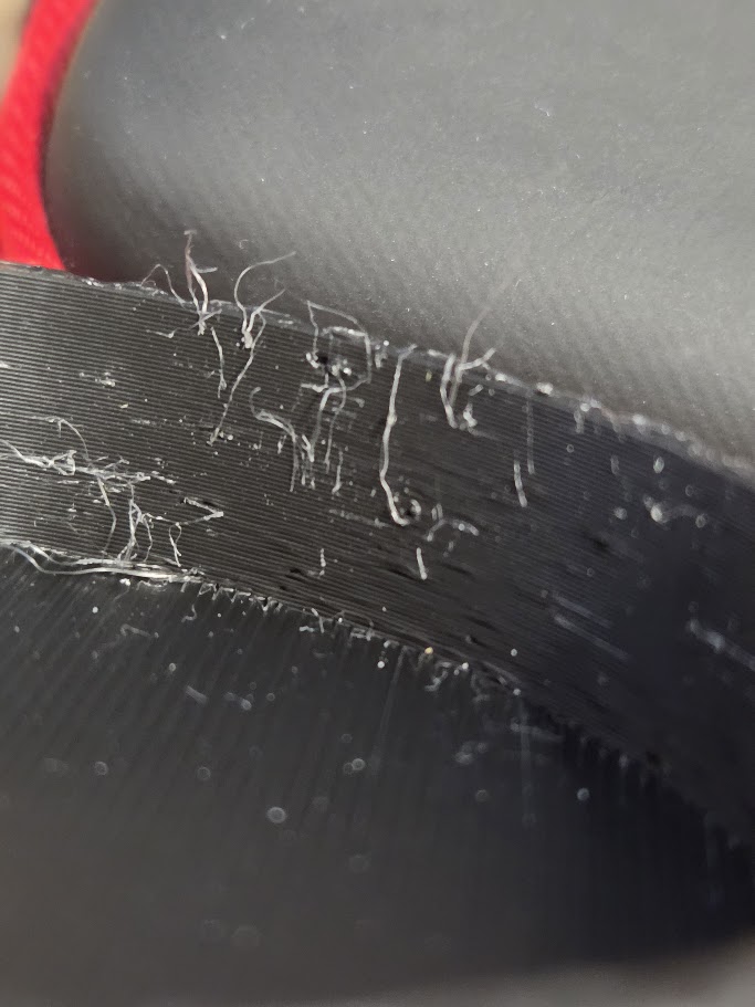

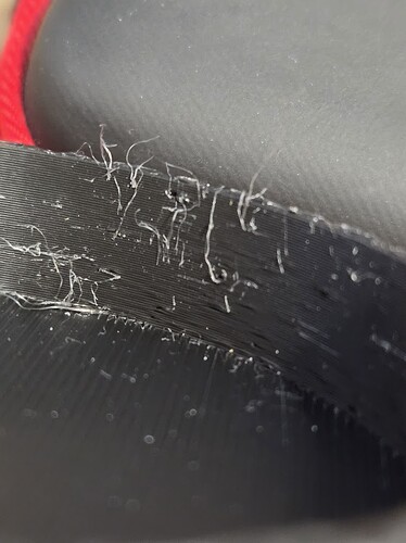

So this issue just occurred recently, everything was printing fine. I tried to go print a TCG Playmat Tube using a model from Makerworld, that I’ve used before, and noticed some stringing issues during the print.
When I looked closer, I noticed on the inside of the cylinder there were rough spots poking out of the wall - like tiny spikes. Below are all the steps I’ve tried to resolve the issue so far.

And also to note, the ‘spots’ I mentioned, when I run my finger across them they are sticking out from the layer itself, they feel like tiny scratches.
This is either the wettest filament to ever exist or you have your Seam set to “Random”
Lots of “popular” influencers and AI like to suggest random seams to newbies - this is a trap lol, you do not want random seams if you ever care about aesthetics even one percent.

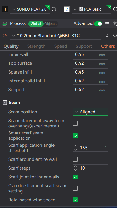

My seams are set to ‘Aligned’, I use the default 0.20 ‘Standard’ profile. I do have a separate part to the print that uses a different color filament, so the only change under the Prime Tower is the infill gap and rib wall.

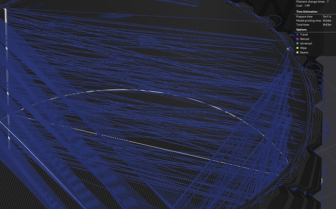

If thats the case I would strongly consider drying, although you said you’ve done so twice now. I’m unsure. Can you slice the model, and in the preview tab of the slicer, take some similar screenshots to the real life ones shown? Or share the 3mf for further analysis. If those arent random seam, the wisps indicate a travel right before them, and getting deposited there. You can enable view of travel in the slicer preview to confirm further. As Jon mentioned, Timelapse [of any variety IMO] is a possible culprit

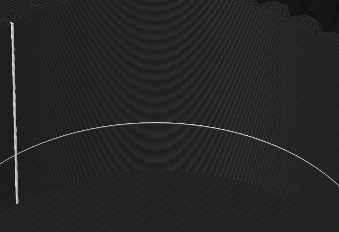

I’ve included screenshots, including showing the travel lines, the screenshots are about where the print is in the picture. I have also included a copy of the 3mf file

Aha, the physical pictures didnt show that outside knurling, which creates little islands of loops inside each. So those travels depositing the wisps are from the inner wall knurl segments, not something like timelapse’s travels.
So, the issue remains something more like oozing/string, which… often points back to wet :slight_smile: You can also sometimes reduce ooze by reducing nozzle temp if you’re right at the edge, try -10C and -5 max volumetric flow?

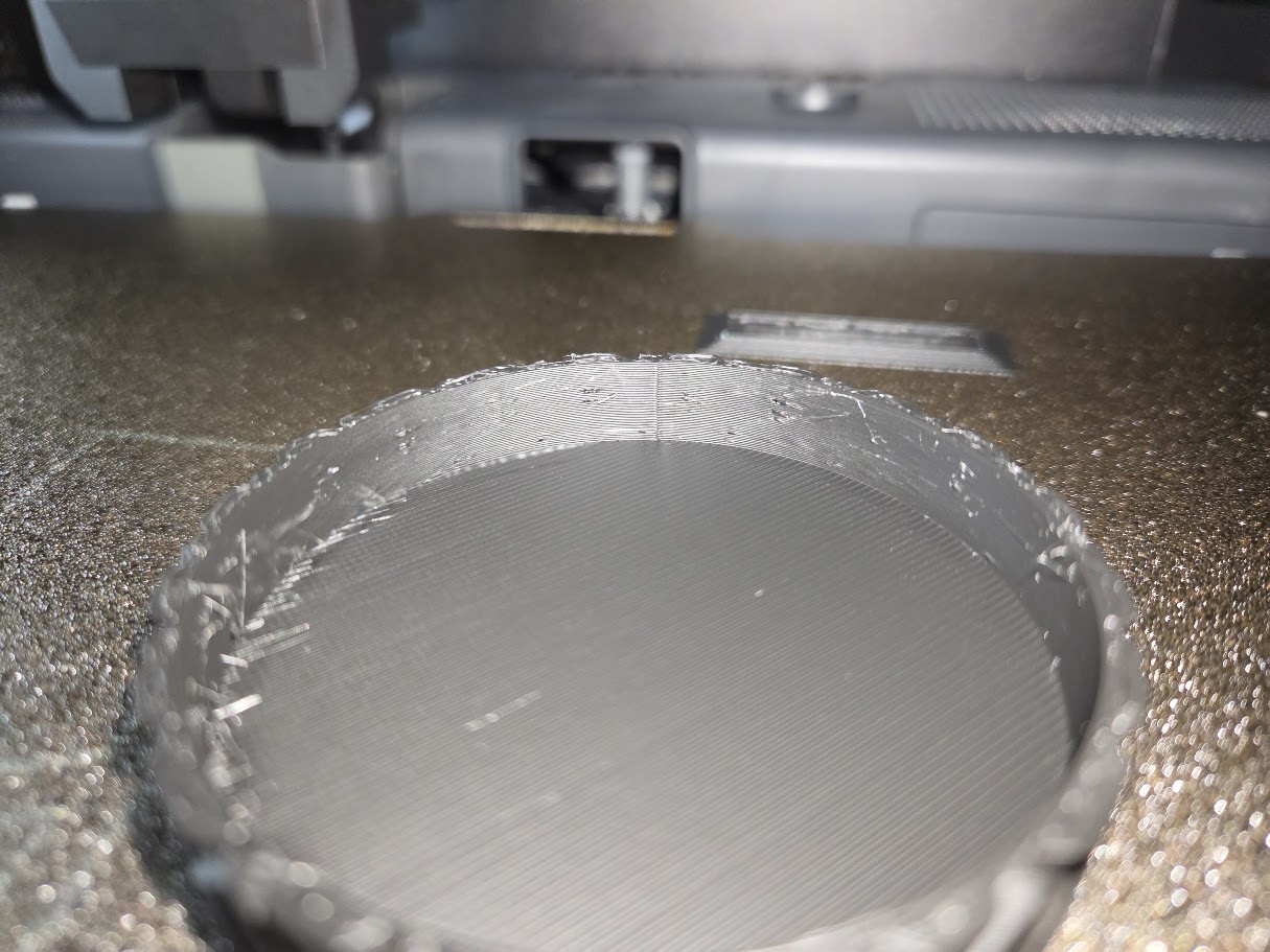

Here’s another example of the same print, but on the print bed.

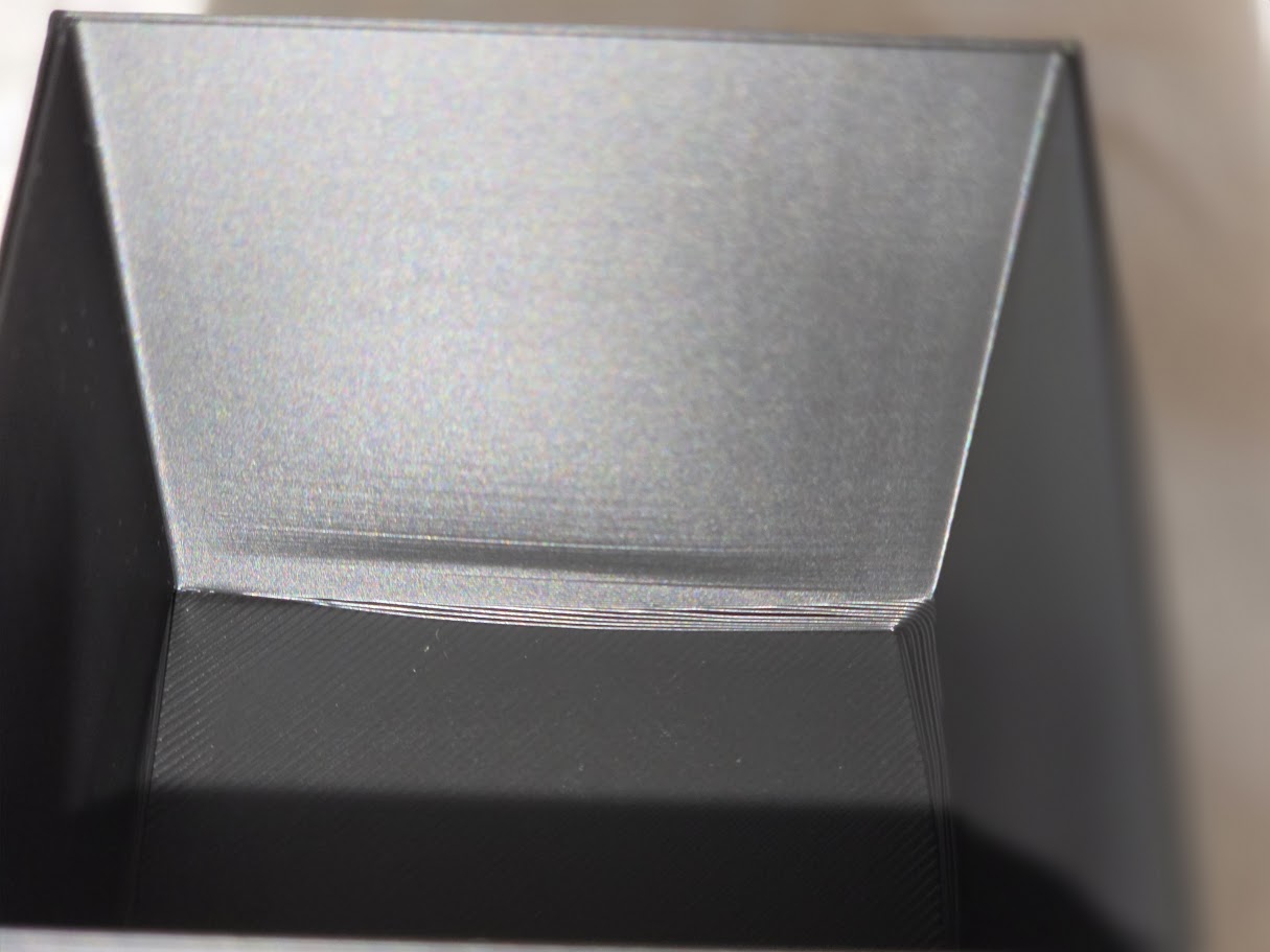

With the same filament, I printed a 5mm x 5mm cube to test with 1 wall 0% infill. And it looks almost perfect.
I’m guessing the cube doesnt have any large travels thru open air :slight_smile:
Lets step back for a minute, did you do pressure advance/k-factor/flow dynamics on this filament? What was the value? That cube has an unattached rounded edge near a corner, which is often pressure advance not tuned for very high speed. Bad PA can cause strings too.

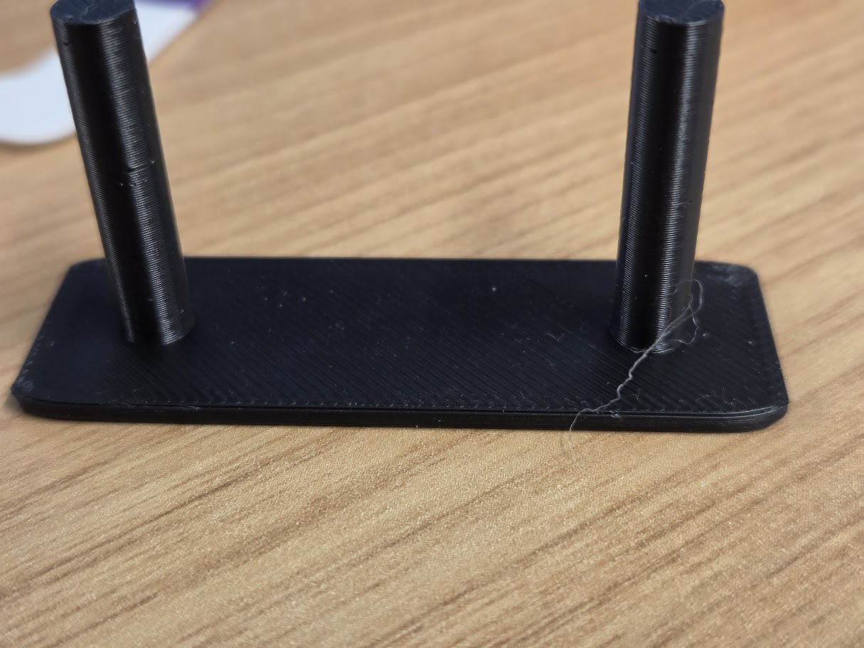

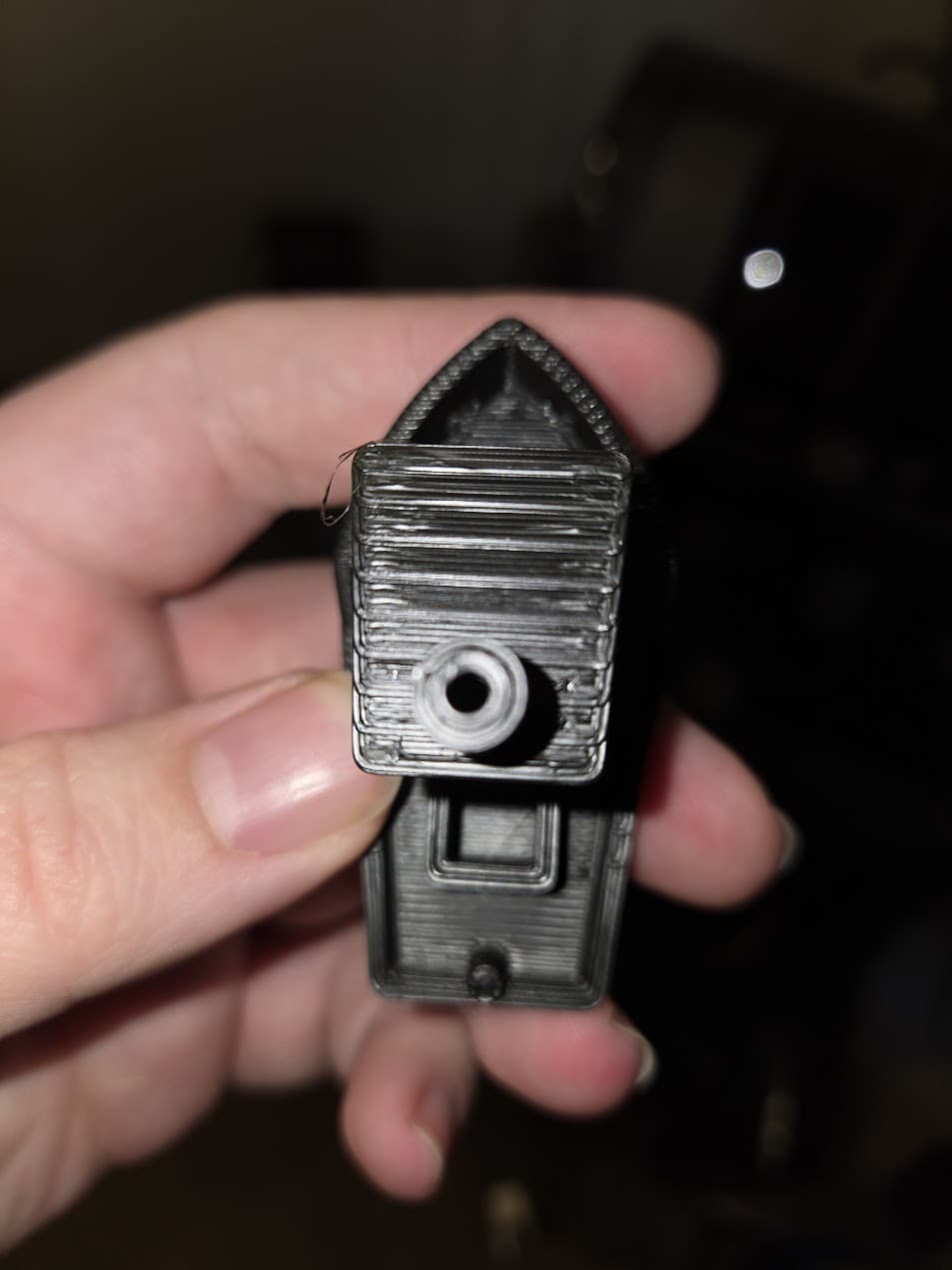

Welp, thats all my ideas. I dunno! Good luck! Maybe try printing something you didnt slice, like a gcode benchy on the SD card, to remove the current slicers settings completely from the equation, just machine and filament.
I did try that as well unfortunately already (results below) but I appreciate your help in trying to resolve this.

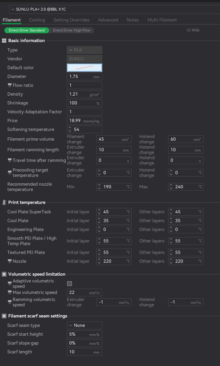

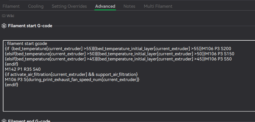

Can you post your filament settings? In particular, but not only, the advanced settings?
You may want to enable “avoid crossing walls” and give a distance of say 100mm in the Quality settings.
You can also check for “z-hop” (disable if enabled) and and “wipe on retract” (enable both checkmarks) in the advanced filament settings.
Thank you for the suggestions, I think I copied all the settings you wanted to see. I enabled ‘wipe on retract’ but left the checkbox to the right of it unchecked.
I did also enabled the ‘avoid crossing walls’ like you suggested.
