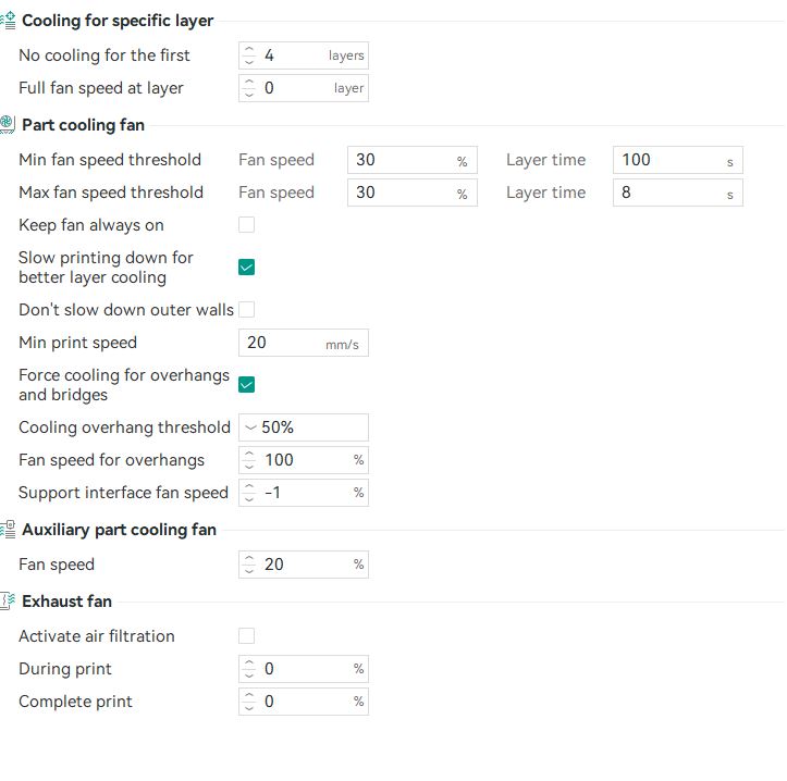

Hi there,
there is a way to disable the exhaust fan for some filament ?
I tried with a LW PLA, disabled inside the filament but always is on @60%
Maybe something in the Gcode ? I am not an expert…

I don’t see any exhaust fan options in the Studio filament settings, so I guess you are using OrcaSlicer?
Some Orca options, like the Settings Overrides, need a box checked before the settings become active.
You might try checking the “Activate air filtration” box with the speed percentages at zero or a low value.
Hi, yes sorry it’s Orca, I tried to activate the exhaust air filtration at 1% but doesn’t change anything, can’t find where and who tell the exhaust fan to start @60%
Maybe the machine gcode but I can’t find anything and the command should come after or not ?

The exhaust fan is set in the filament gcode.
I disabled it via the following gcode, it now always looks at the setting in your filament-settings (Orca) instead of Bambu assumptions.
; filament start gcode
{if activate_air_filtration[current_extruder]}
   ;Turn back-fan ON
   M106 P3 S{during_print_exhaust_fan_speed_num[current_extruder]}
{else}
   ;Turn back-fan OFF
   M106 P3 S0
{endif}
Use at your own risk.

There is point where filament set the 60% fan speed there should be elsewhere.
i just deleted the whole bit and only used my gcode.
The standard code has all kind of assumptions about bed temperature which leads to a hardcoded exhaust fan speed.
Which i did not care too much about.
I just want to set the exhaust fan as i see fit.
I just realized there is one more setting in the printer-start-gcode, which is the default speed for the exhaust fan.
Copy the start-gcode to a text editor and search for:
M106 P3 S180
I commented it out like
;M106 P3 S180
You’ll find 2 entries.
And save the printer as a new “personal” printer.
No harm is done, since you can just delete the new printer.
