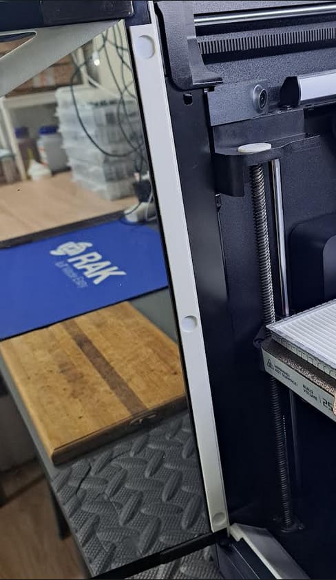

I am not an expert and I do not have the P2S, but I print a lot with ABS for outdoor enclosures and my P1S is inside my office (next to me).
What I did first was

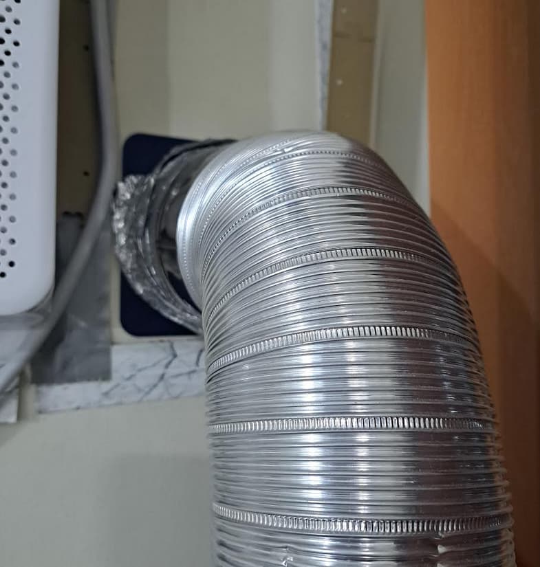

  • hose from the exhaust fan directly out
But still smelled it when I printed ABS.
So I added
  • Close the front door gap on the hinge side

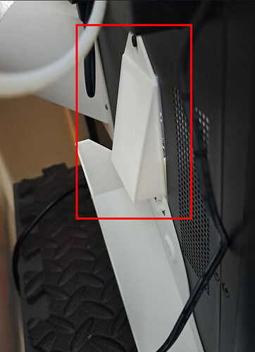

  • Close the poop door on the back as good as possible
Now I can smell it only after the print when I open the P1S door.

Some pictures (again, this is P1S)
Front door lid:
Poop door lid
Exhaust pipe to outside:
Had not thought of the door…. Got the poop chute covered. Just need to whip a model for the exterior exit.
