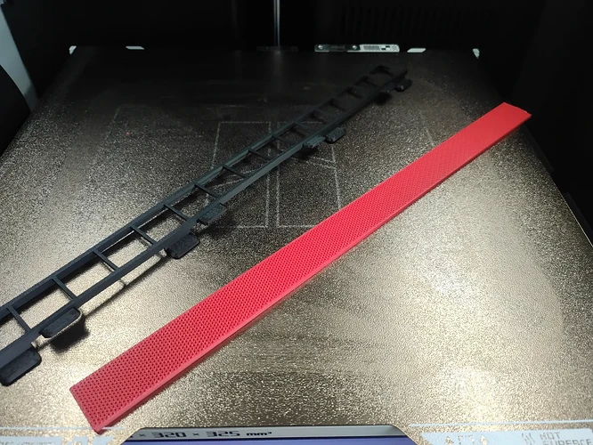

If you want to reduce how much fresh air enters the printer, you can print a “top vent filter” and make it denser — it very effectively limits airflow and drafts.

What I did instead was print this filter holder:
along with this filter:
However, I did not use the holes included in the design. I printed it as a solid, fully closed piece by removing the infill modifier. This way, there is no draft. The filter opens, the fan is set to 10–20%, and only a minimal amount of air flows through.

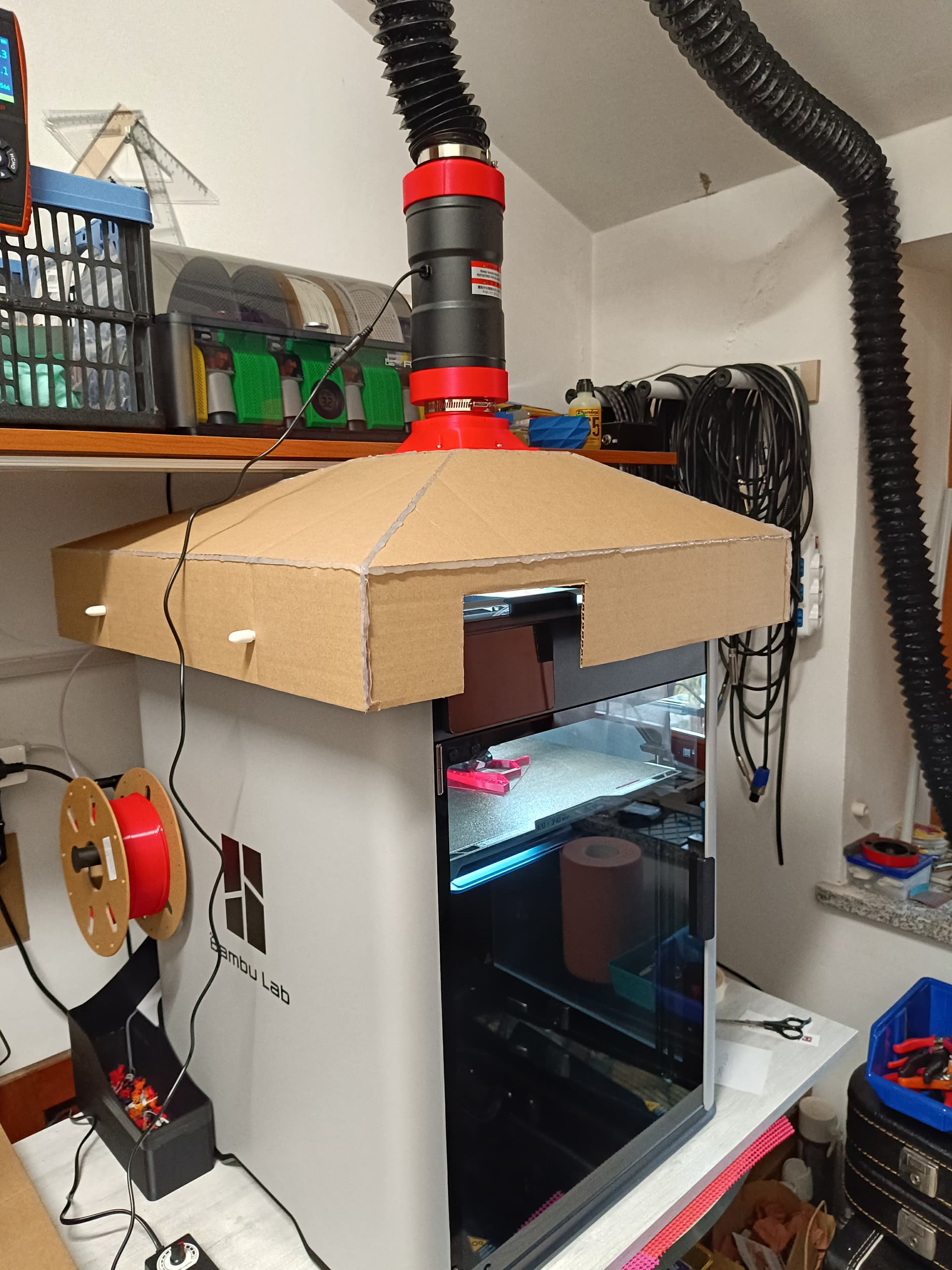

To extract the fumes from the room, I’m thinking of a solution similar to a kitchen extractor hood.

It’s a little crude but maybe it works…
