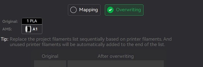

I’m trying to understand the issue. The only time I see that is when the filament map does not match what you have in the AMS. IE you need to print PLA, the download has generic or PETG in it’s first slot, so if you haven’t overwritten your AMS map over the dowbloads, it is asking where your pla is. That’s why the click. At least that’s why it happens when I forget to overwrite the map that’s in the download.

It’s probably because that print profile is set for pla, and you don’t have pla loaded into the printer information. So if you click on it it should show the options of your filament. Sometimes it will let you continue with the wrong type of filament and sometimes not.

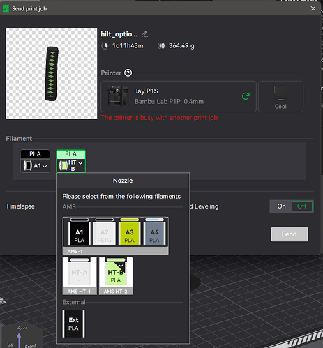

I realize now that I failed to make myself clear. And I do that best with pictures. The three pics below show what’s going on. Again-- it’s no big deal. I can live with it.

You have to set the filament here first.
Like so
Color really doesn’t need to be set. You can change it to whatever as long as it’s the color and type on the spool that you want the print with. The machine couldn’t care less.
You then synchronize your loaded filament with the slicer. If you don’t do this it will default to the last type/color you did sync last. If it’s the same type (PLA) then no harm no foul. If it’s PLA and you’re using PETG, or you want to see the color within the slicer, then it must be sync’d. This is where the slicer and printer are on the same page.
If you don’t do this the slicer is going to behave at print as you’re seeing it behave. It will ask where the filament is that you want to use. If you didn’t sync the slicer only knows what you WANT to use, not WHERE it is. If you had sync’d the filament this won’t happen. It will show you where it is to be sure when you click print.
and it will show here
in this example, I clicked on it.
I realized you are using one color but I just woke up and have already done 4 screenshots. No coffee. I’m doing a 33hr print for my daughter so we’re going to just use what I have loaded. Hope it doesn’t confuse.
Here if you had an ams and wanted to change color you could.
In your case the printer doesn’t know you want green and where it’s at, doesn’t care. The slicer does so it’s asking you to tell it where it is because the printer says you don’t have any.
In a nutshell, set the type and color in the Device Tab
sync in the slicer and then it’ll be all better.
