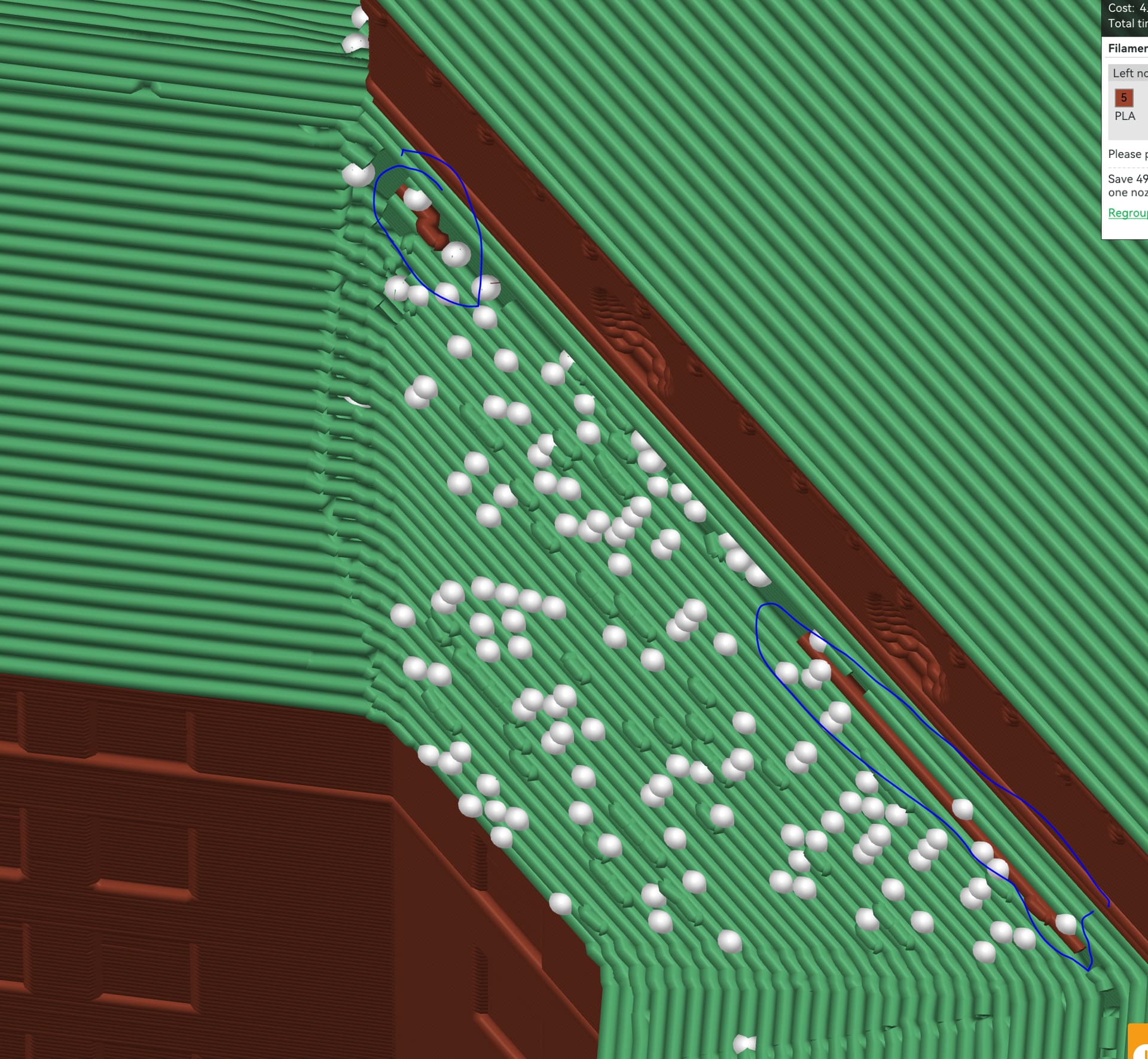

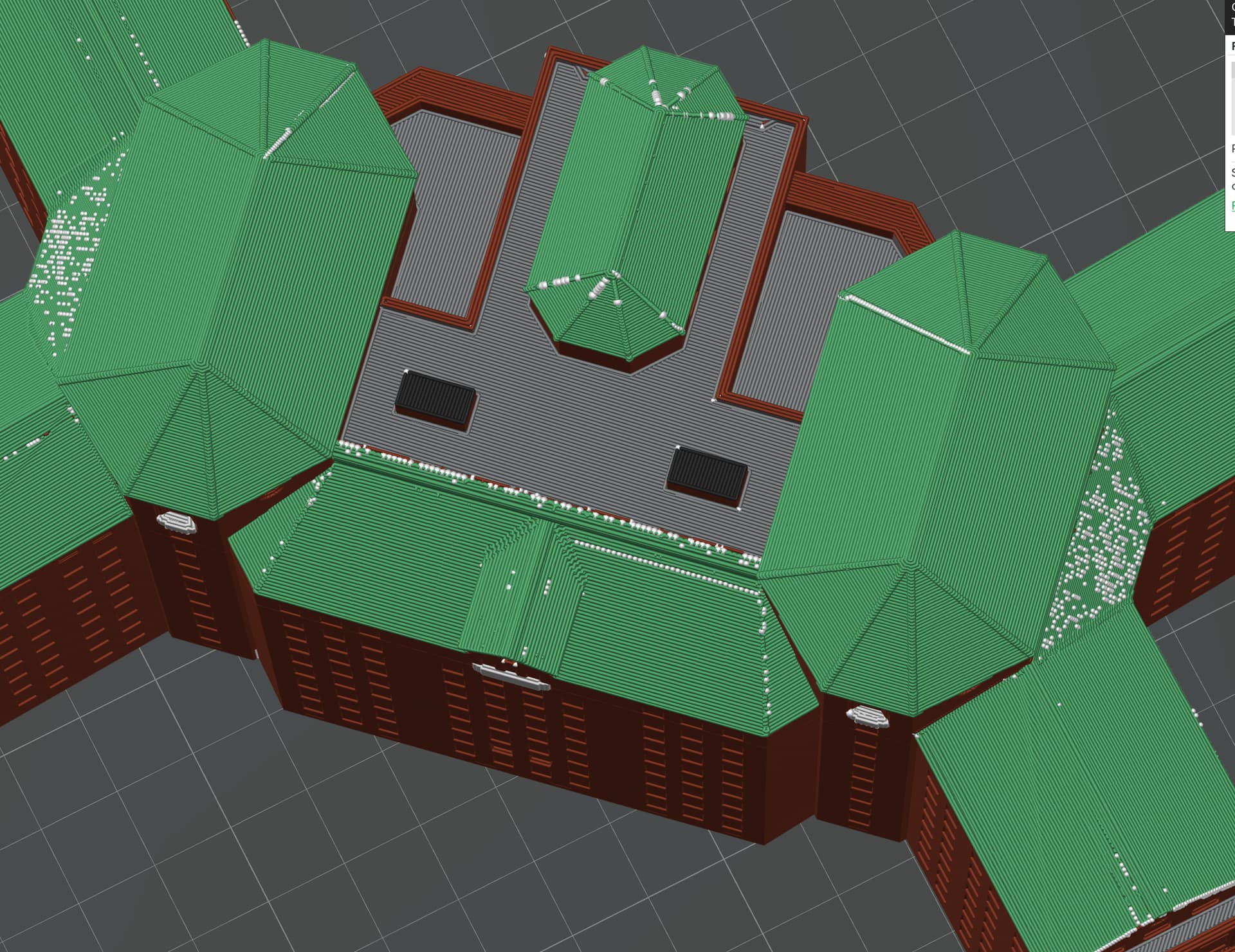

Dont really know any other way to explain this. I have a model. Painted it for multi color. After printing I noticed a rough line so I looked in Bambu Studio at the sliced model and I see a bunch of little start points where there should be non. Take a look at the model and the snap shot after slicing and you can see what looks like extra start points for short lines that should not be there. I am sure I am missing some simple setting to stop this. Anny suggestions would be appreciated.

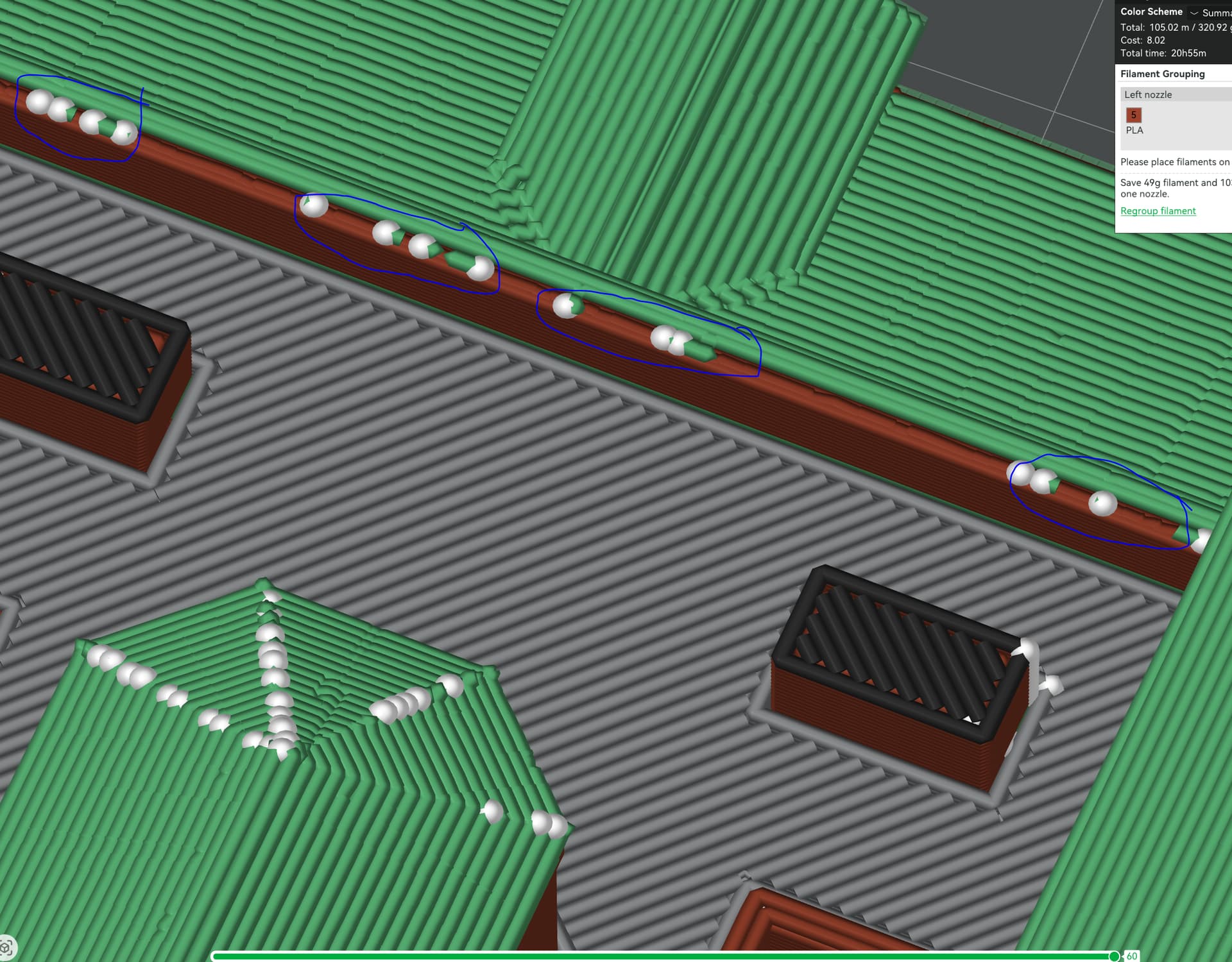

Slicer is confused because that part of the model is very thin in that color

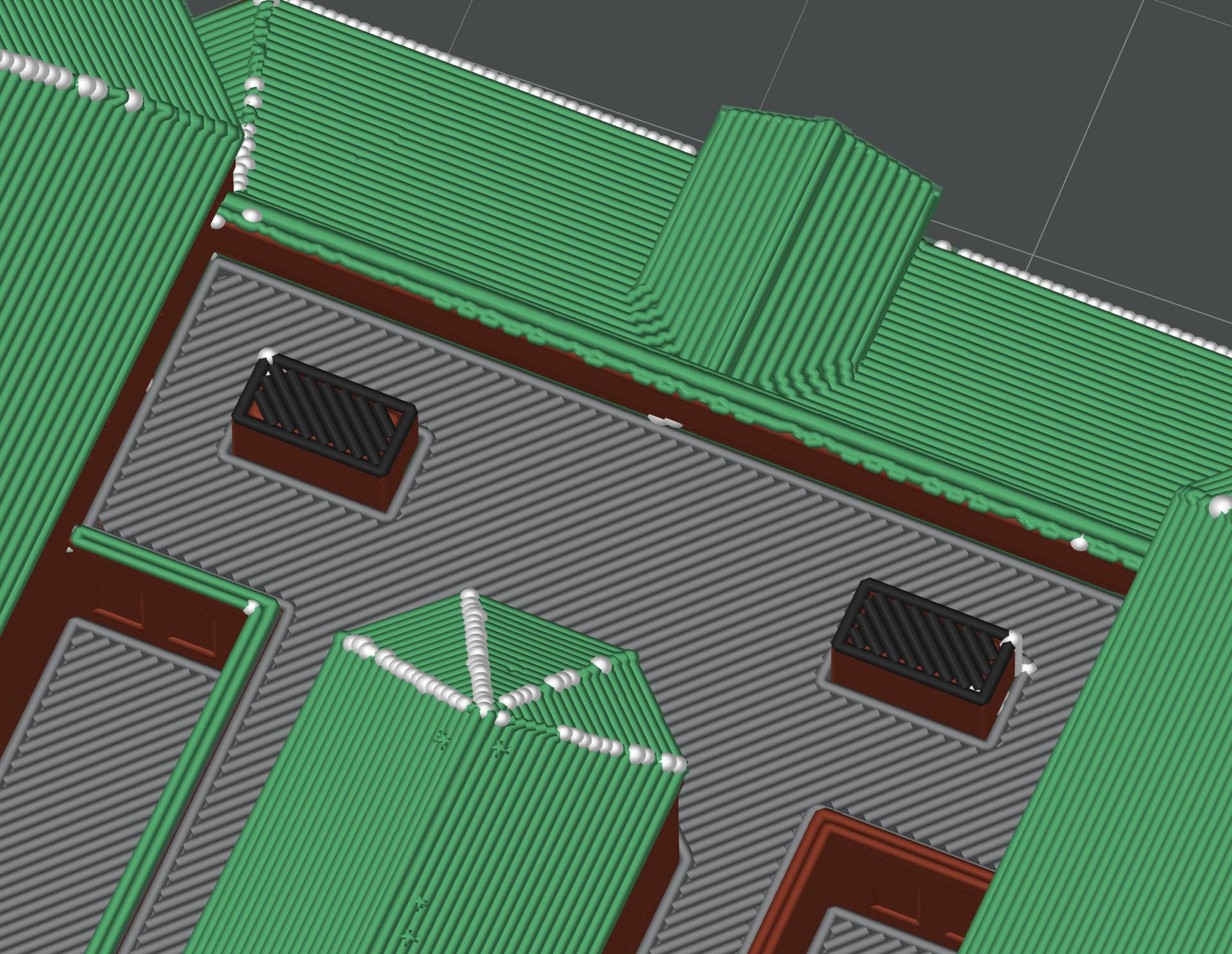

Looks a bit like it is trying to do gap infill?
Did you try a slice with the Arachne wall generator yet?
I haven’t I’ll give that a try. Thanks.
Little better.

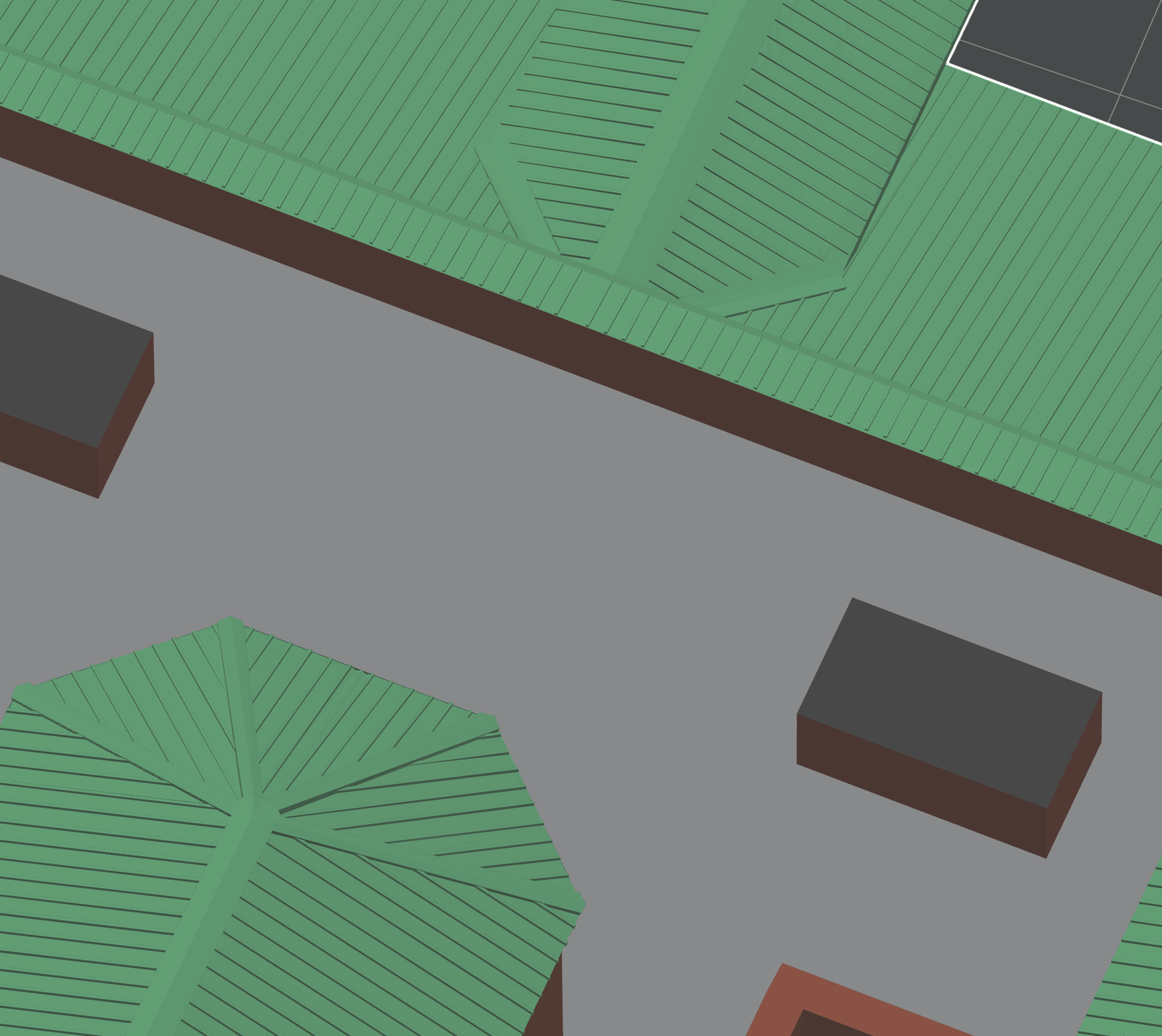

Those features are too small to recreate completely, so it’s interpreting. Maybe not well. The pleating on the roof looks to be fooling the slicer into trying to recreate it - see those wiggles all over.
You might even get better results by telling the slicer to interpret it as lower resolution, but if you do this you should really spend some time in the preview tab walking around and seeing if it didnt change anything else important.
try a much higher value for one or both
Thanks, Ill give those settings a try. Yes its a high res model made by someone else. I am just printing it for my daughter. Tried filling the build plate with is. I also noticed other parts of the model with multiple. Even colors added after slicing.
starts.
