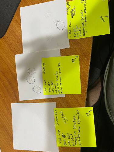

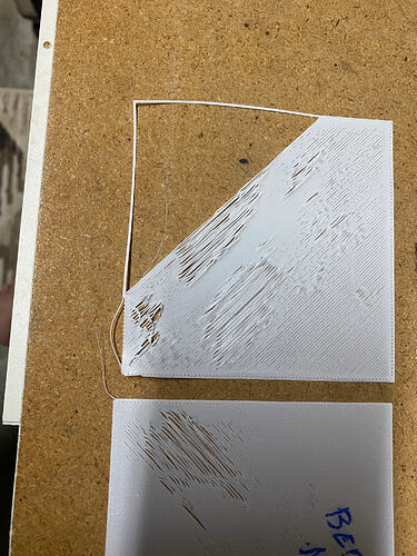

I have bed adhesion and first layer problems printing PLA, including different brands(sunlu,inland, anycubic). The initial outer perimeter and inner areas don’t stick in places(see photos). Ive been trying to troubleshoot this in various ways.
I created a test print that is just a single layer to make things simple(cube .2mm high). The only way I can get a near-perfect first layer is to turn off both the part and aux fans and set the hotend temp to 220c and bed to 65c and slow down the first layer to 30mm/sec. These seems to be the going recommendations from Bambu to resolve the issue.

  1. part of the bed adhesions problem likley due to printing really thin layers(.08 hue forge prints) with PLA using a textured plate- makes sense that would cause these types of issues.
  2. I got the cool tack plate from Bambu, and have printed several things with a thin first layer and everything comes out perfect, not one issue.
  3. The cloging? likley just a series of things that lead up to hot temperature printing due to the original layer adhesion issue.
I realize now i probably could have solved this to begin with by just printing the first 1-2 layers at a normal layer height or set thicker hue forge layers in that app.
