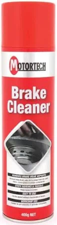

How would you clean the sealed bearings?

You can use alcohol to clean it and then put a drop of lube and spin it. Should work
I’d soak the bearing in brake cleaner to clean out all existing grease, oil or grime, then replace with generous amount of silicone spray. This brake cleaner stuff can also dissolve the adhesive way way better than IPA.
But basically, when the ball-bearing seizes or catches, that is, a steel ball inside got damaged and needed to be replaced.
