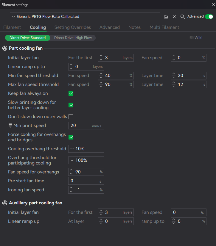

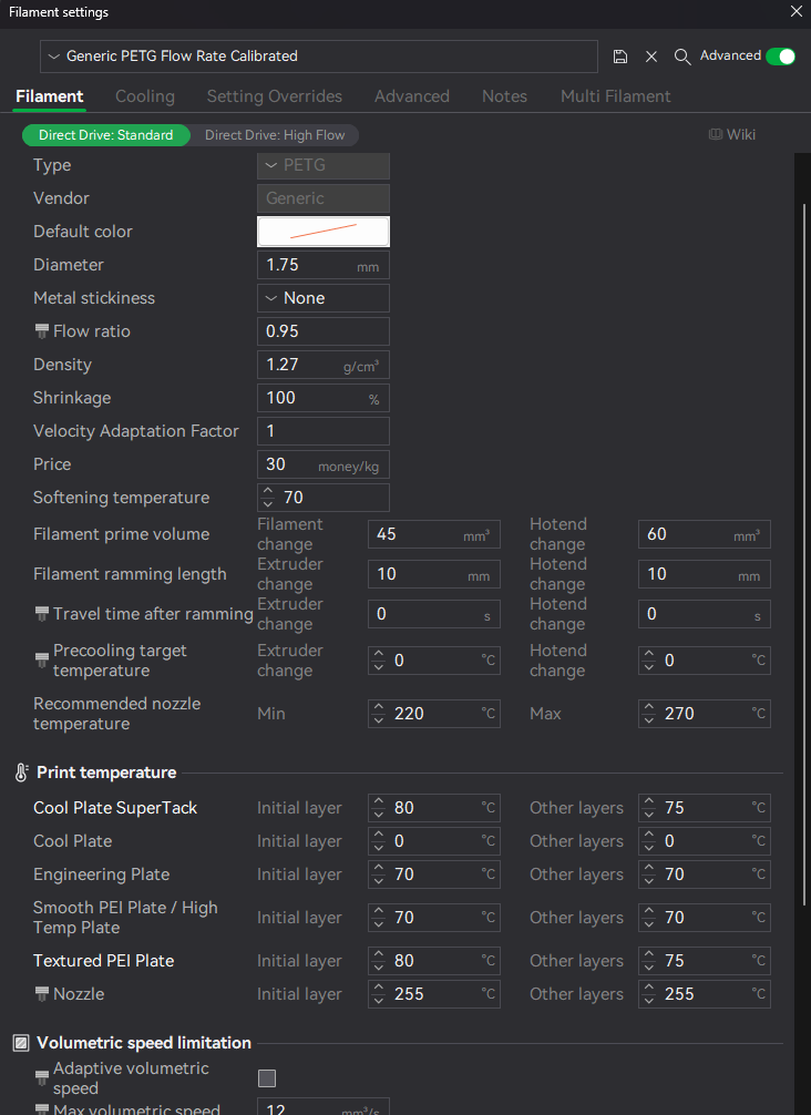

Chamber Temperature is managed under the filament settings
I believe im in the right area…i clicked the “…” next to my filaments and i see filament settings open up. However i still dont see anything in this menu for chamber temperature, and this is where i was looking earlier.
I am not at the PC but it’s on the first tab. Just scroll down.
Make sure you select the correct nozzle type on top.
Unless your printer has no chamber temperature control.
