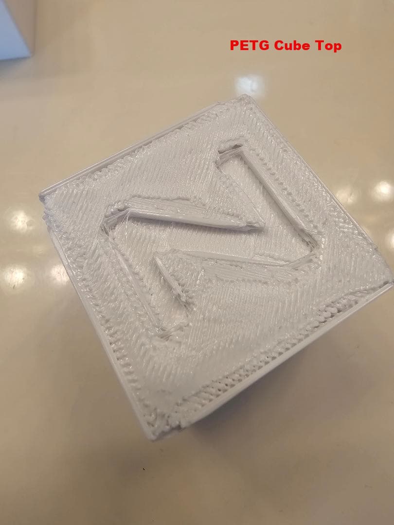

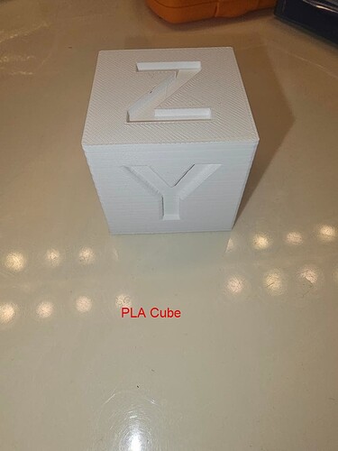

Hi @Mprints thank you for your reply. The filament was dry when I had the issue. I read in another post that someone loosened the filament tension screw at the top of the extruder and I back it off 1 turn. Tried a bench print and it was great and I thought I solved my issue but now I’m having non stop issues especially with PETG. I was printing a new part when I noticed that the corners of the print were not printing correctly. I stopped the print and put the PETG in the filament dryer for over 8 hours at 65 degrees Celsius. After drying I tried a test print with a cube and i could see that the corners were not printing and the first layer wasn’t even touching the initial outline of the square. I did a flow dynamics calibration and a flow rate calibration and it seems to be worse. When I try PLA, it does way better but there are noticeable layer lines throughout the print. I put in a brand new standard .04 nozzle to see if it was a clog issue but I’m getting the same result. Any thoughts? I’m pulling my hair out on this one.
Hi all! I wanted to give an update on my issue. I ended up resetting the printer back to factory defaults and it seems to have fixed my issue. I printed the same test cube and the first layer was back to normal and the completed print looked good.
