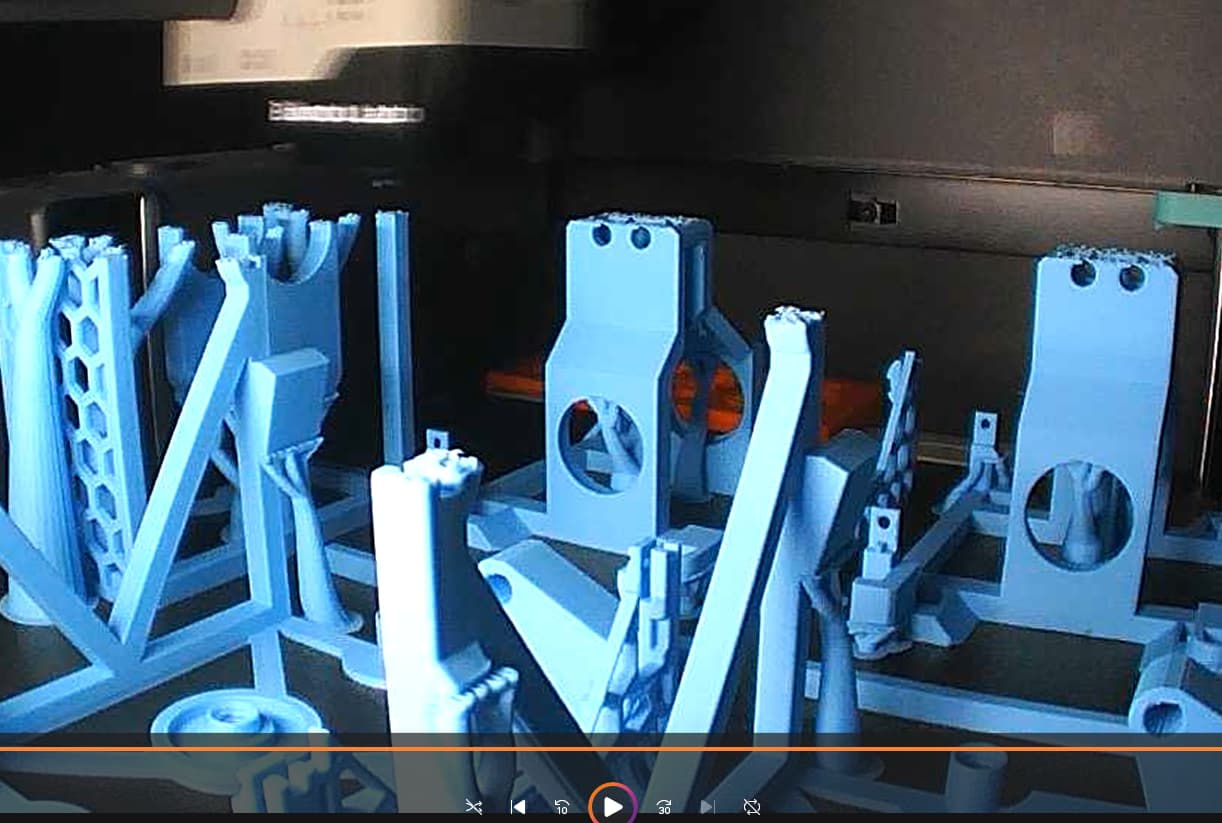

Well, it happened at some point during what was going to be a 7 hour print - probably about 5 hours in.
This was where it failed the first time:
Since then, they are all failing much earlier:
