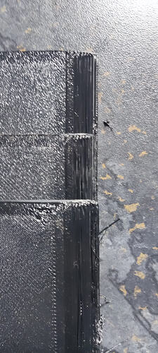

Other projects using the same settings work fine. feels more like a slicer issues is causing the error to be thrown.

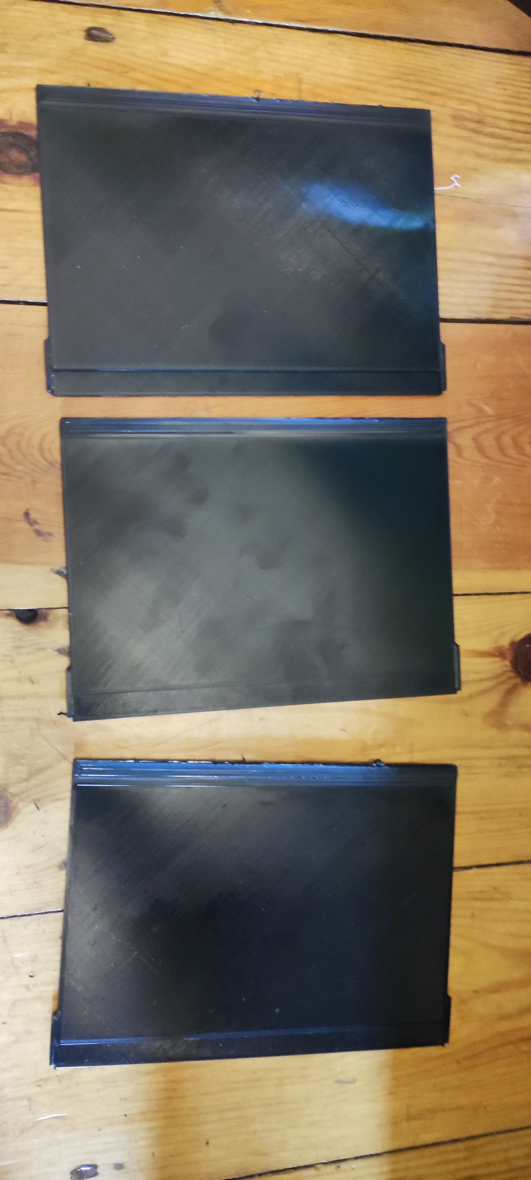

Last image show how close the layer it fails on last 3 failed attempts.
Replacing the hotend and cleaning the extruder will fail immediately on resuming the print.

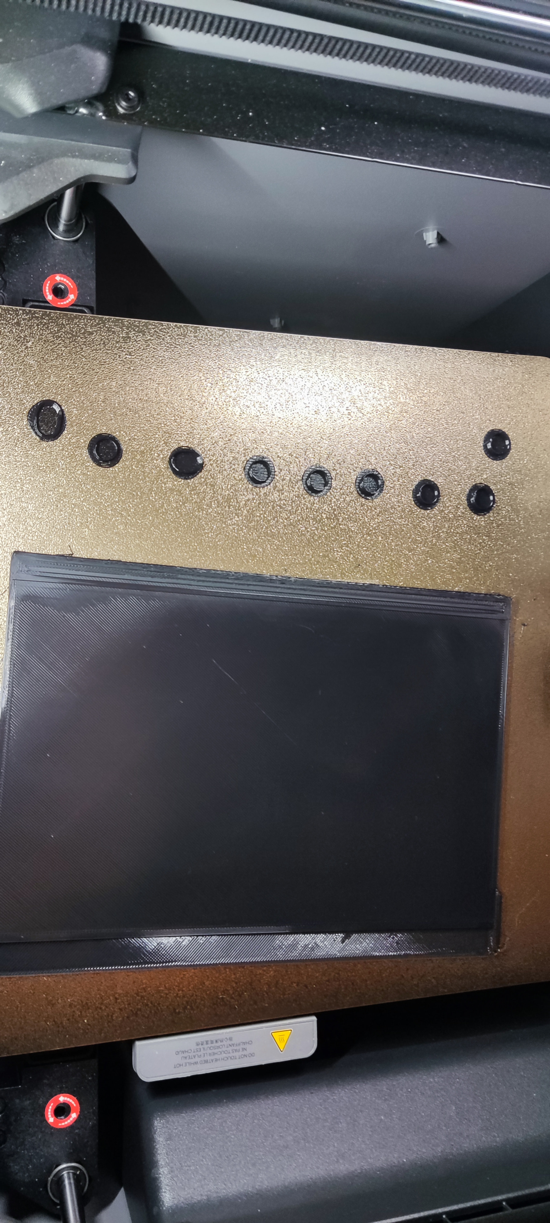

It always fails at layer 10 never gets past it , just printed at 50% zero issues

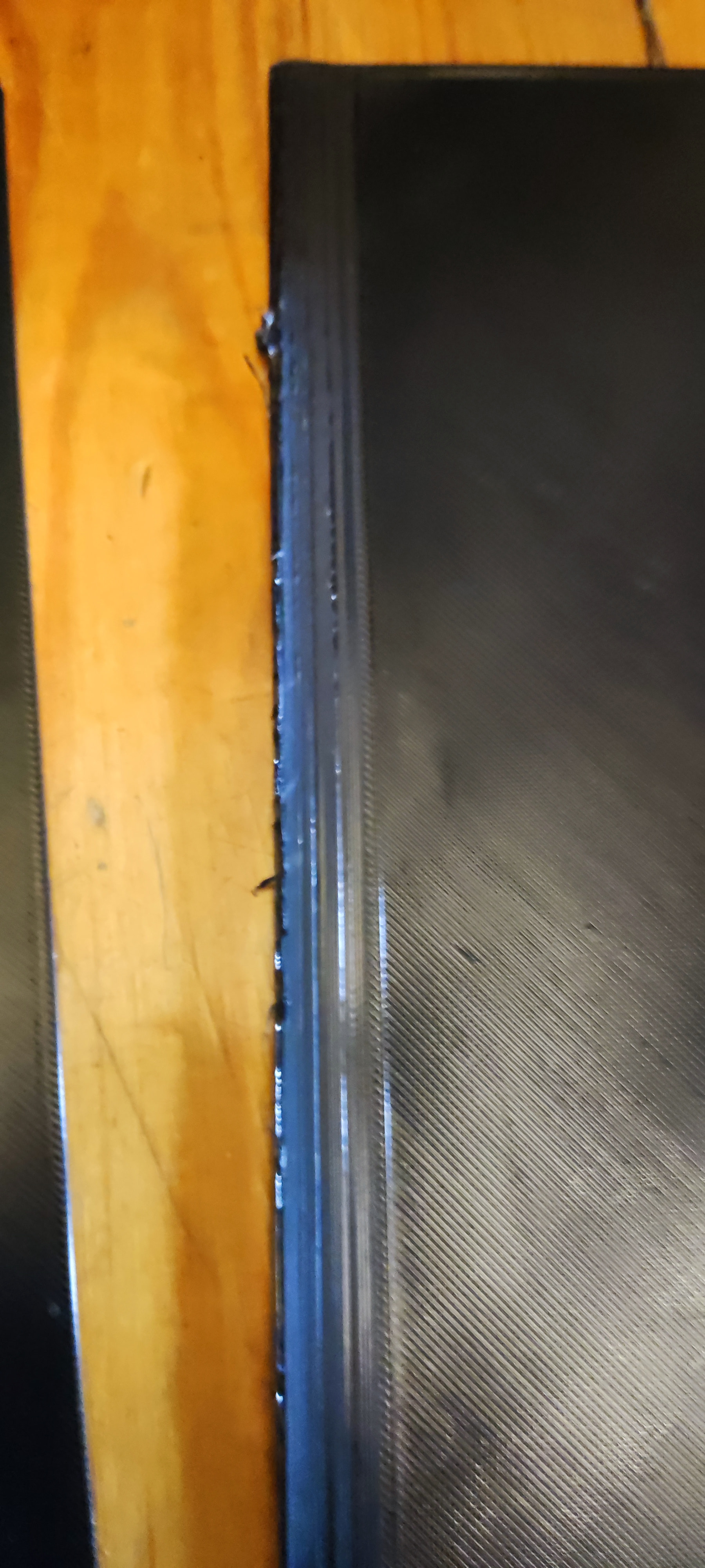

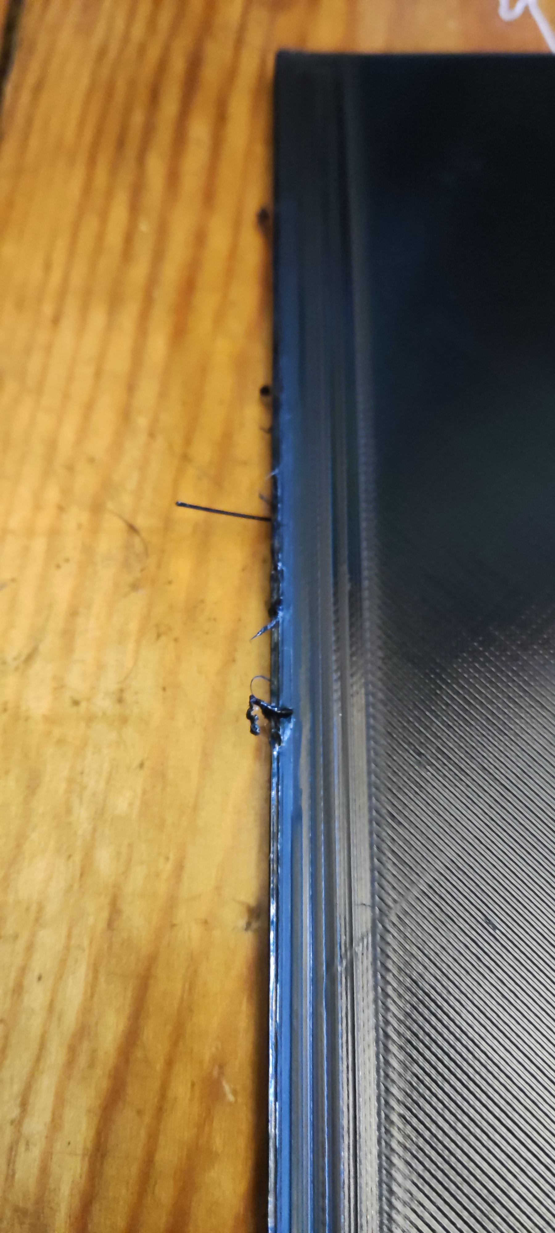

I probably should have been more clear. Supports do two things - they hold overhanging regions up, and they hold them down.
When a part is highly unsupported for many layers, it begins to curl upward. By around layer 10, the force of that upward curling is enough that it’s pushing against the nozzle opening, which resists the flow of molten material. That in turn makes it harder for the extruder to push the filament into the hotend, and that causes the error you’re getting.

Nope failed again at layer 11, tried rotating the print and a repair
Well I just kept clicking issue resolved and eventually it got past what ever was causing the issues and ran smoothly up to 87% Same issue at layer 187 the flat section has come away form the supports and bowed up..
