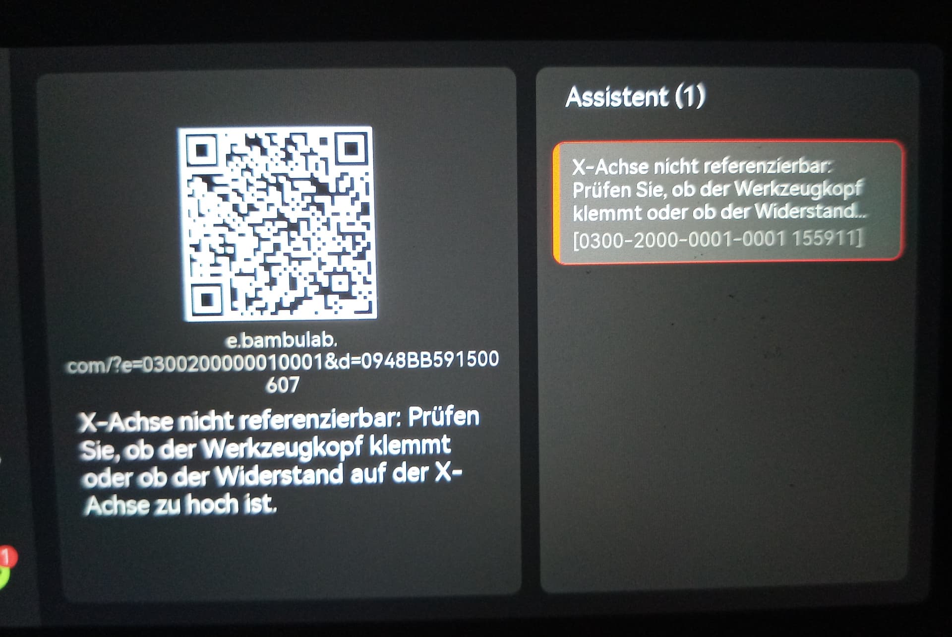

I hope it’s not one of your motor starting to fail that your hear like this guy. Support aknowledged there was a bad batch of motor shafts… In his case, the shaft broke below the gear.
Please have look here while changing your broken bearings.
