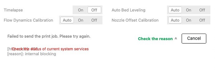

Hi,
I have a H2D for a few days, and encounter my first BIG problem.
Not with the printer, but with the cloud we must use due to BambuLab.
My computer is in front of me, my printer is in the room in the back. And I must send my files somewhere in the cloud to be able to print. For security purposes???
And actually, I can’t use my printer due to an “internal blocking error”, that occurs during this transfer. BambuLab, if you force us to use your cloud, you MUST ensure that it works!
I tried to send the file several times, then to reboot the printer, without success.
Regards
I too had the same issue… sadly the link is not too helpful… I was able to check the website and my network traffic was flowing but my VPN app (for some reason) was not letting the traffic specifically for this traffic through using the settings for “Block malware, ads, and trackers” … as soon as I disabled this setting (to Don’t Block), the traffic to BambuLabs servers was suddenly allowed to flow.
I tried to “just send” the file to the USB key plugged into the H2D. Then I went to the printer, and launched manually the print: success.
For some other reason, I had to stop this print and change the temperature parameters. Then I tried the remote printing again, with success.

I get this issue regularly, all I do is close and re-open Bambu Studio, fine after that.
Thx for the open / close tip. Did the job after an hour of trying. Even tried to import the models as STEP. Nothing worked. After relaunching BS I was able to send.

I am experiencing a very similar intermittent issue with this. I’ve restarted the network with success. I am using Eeroo Wifi hubs. What is unique is my mini, P1S and H2s are all within 5 feet of each other and I only have issues with the H2S.
Same. Sometimes files will go to my H2D, most of the time they won’t. Reconnecting, resending, quitting Bambu Studio and starting again, swapping wifi networks - SOMETIMES these things help, but most of the time they do not.
Yet files send from Bambu Studio to my X1C reliably, every single time.
It also works just fine if I “print” from Bambu Studio. It’s only sending the print file to the printer’s USB storage when it stops working properly :frowning:
haha, as an IT guy why didn’t I do this first!!?? This worked perfectly, thank you
