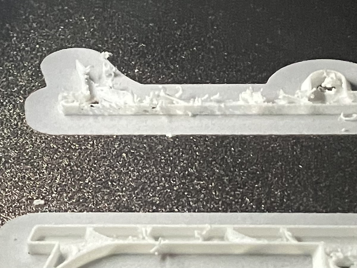

The problem:
When i’m printing this file, the filament fails to extrude in a single specific part of the model near the print plate every layer, every time i try to print it, no matter how i move and turn the model in the slicer. The printer also makes some wierd screachy noises during the same circular motion, however the print does not fail in that place. Here is a image of what i’m trying to print:
It is also wierd that the model is symmetrical and the problem only occurs on one side, and the same side every time. I have never seen this problem before and i have no idea where it comes from. Please help me. Here is a picture of the failed print before the machine wasted too much filament:
You can see that the part that is symmetrical in the part of the model that is closest to you is as good as it can be, however on the other side, it looks like the walls has been torn up and shredded. You can also make out that the bottom layer is missingin that part, and that the carnage stops right about the ■■■ that goes out, however the brim in that place is totally fine. There are also the wierd noises, but thay are less of an issue.
I think it is the part that is the last bit before the printer goes to the next layer that fails I think this is the most important information.

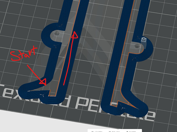

Apart from this I can just suggest to visually check those layers after the slicing and check the path of the nozzle referring to those moments. (unoptimal slice job)
I can see the nozzle move in the intended path, and on the printer, it says 275 degrees while printing those parts as well, as it is supposed to say, but nothing comes out the nozzle. When i think about it, i think that i had the same issue with FR-PC, but i did not think anymore about that because i had other things to do at that time.

makes me think of retraction issues. I can only imagine whats going on inside the nozzle during a retraction?? Expanding material + retract seems ripe for chaos. Have you tried to print a retraction tower in aero? That tiny little two-pillar one. I’m less concerned about the strings and way more concerned to see if your ragged print area follows seams into that model
In 3mf:
-Wipe of 5mm seems A LOT but no experience with Aero…
-A clue would maybe be that its ragged at the BEGINNING of your extrusion path
-Perhaps also a clue would be that this area is nearest the door hinge on a P1. Drafty? Put a piece of painters/masking tape over the hinge for giggles?
-3mf profile didn’t have pressure advance set, which, if reality says for it to be a significantly large number, could explain raggedness at the beginning of extrusions

I noticed that Z-HOP was enabled with a height of zero.
I Have actually already taped the gaps on the machine, and it happens the same place no matter how i orient the model. It may be due to retraction issues. However, the material usually just extrudes out the nozzle, so you end up with some jagged seams, but nothing that sandpaper can’t solve. This however, is a whole other story, have never tried that tower though.
