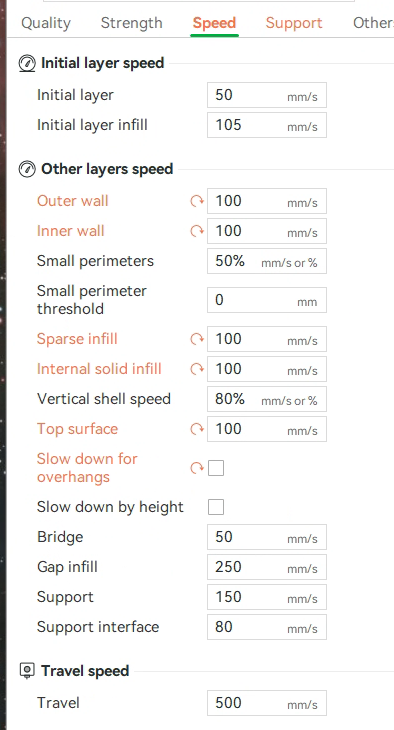

I have problem to print properly negative slope (45°) with PETG-CF (black one) of Bambu. The same piece is wonderfull with PLA (grey one).
I have less this problem if the the wall is thicker. I have tried with higher and lower temperature and speed: same thing. Otherwise with no negative slope, the print is perfect.
Here are the settings:
Thanks for your help and sorry for my bad english.

45° is, in my experience, borderline for PETG. Still good without supports, but close to the limit.
Did you dry the PETG-CF? It is not really optional but needs to be done at least after unboxing.
Those bags are not able to completely keep out moisture and after weeks at sea… And PETG is a bit of a moisture diva.
Thanks! No, I have never dried it, I am going to try, I have a special dryer for filament. 45° work properly if the wall is thicker. Unfortunatly, for this piece, I can’t increase it.
Some news. I have dried my filament→ no change. But I have change speed and ventilation:
And the result is perfect. It’s quite slow but it’ working.
