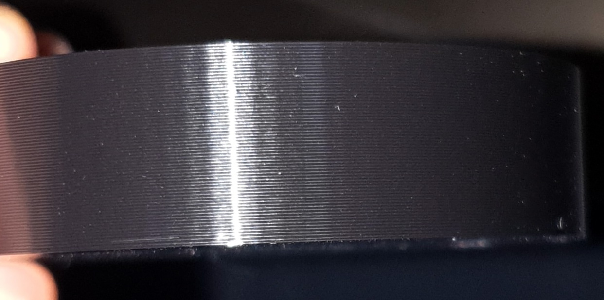

Hello,
The issue started after this modding protruded and got stuck between the nozzle and the bed at the beginning of the print.
Although not very visible, 2mm wide stripes continuously appear on the wall.
wondering where to check and how to resolve this issue
Check to see that the nozzle screws are tight and the nozzle is straight.
I am using a 2.0 hotend, and it isn’t bent. I have re-tightened the screw. I will proceed with a test print for now.
Is the imperfection there when you change to other nozzles?
The previous nozzle still had the same issue, so I had to stop midway. I will try replacing it with a new nozzle.
It seems like the issue is resolved!

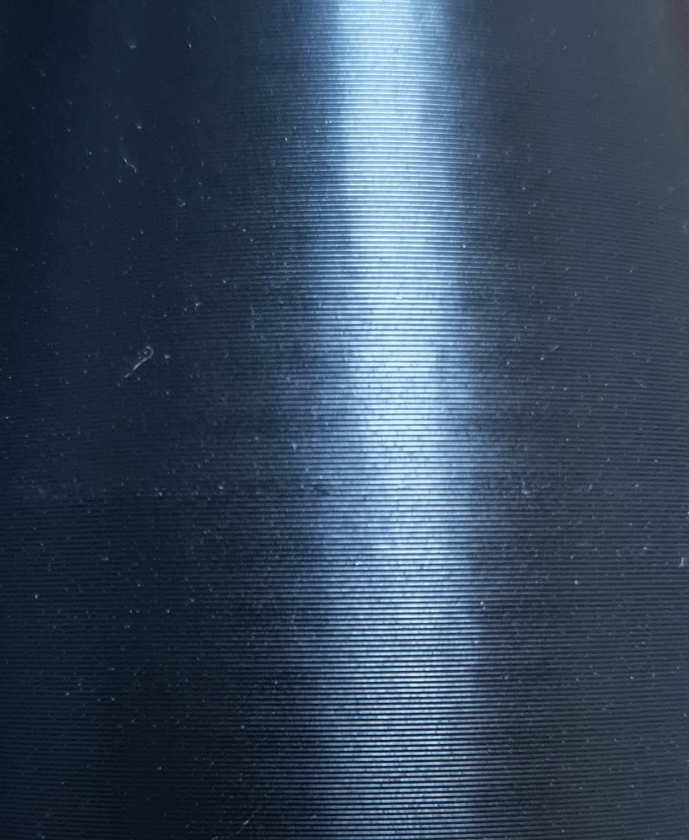

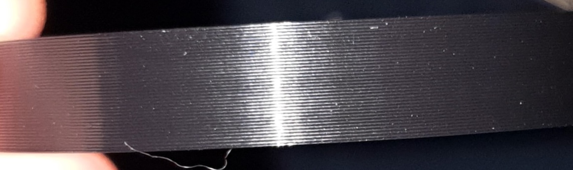

Before:
After:
Thank you!
